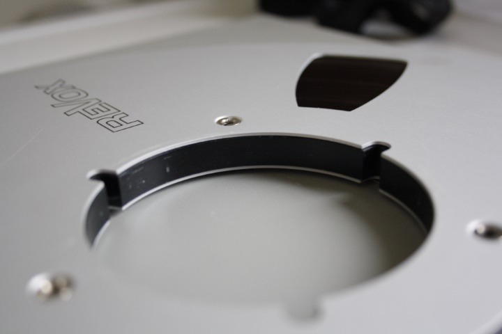

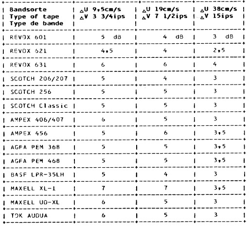

I found a B77 that I am currently restoring.
I have a collection of tapes I bought used many moons ago, but I'm not sure which ones they might be.
It would be useful to know so I can set the bias and EQ accurately.
Do these pictures help?
