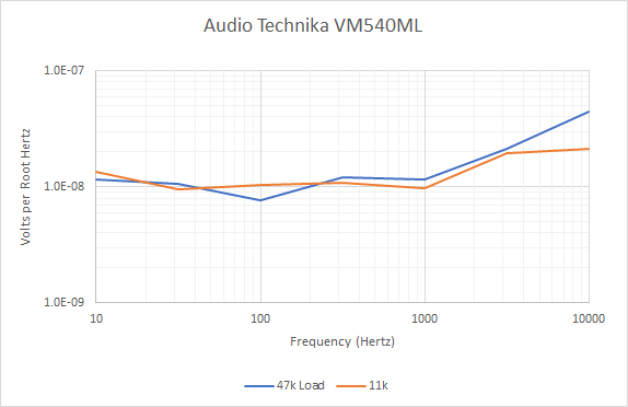

BTW, looking at Pete Millett's design, you could place the 75uS pole ahead of the first AD797 by lowering the value of R1 to take into account the inductance of the MM cartridge. The HF response of this design otherwise is not the greatest.

what about the 7dB noise penalty that gives you? Or do you mean Cordell style 'damped' loading with an 8kHz roll off?
I was at the other location without my usual test setup. I ran this test several times with LME49710 and 47k and 11k load resistors and an Audio Technika VM540ML cartridge. I don't see the noise penalty. 7dB should be 2.2x noisier.
