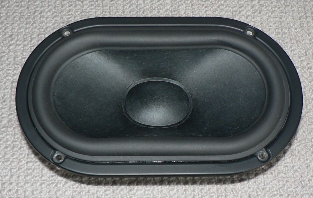

This might sound a bit like a dumb beginners question.
I now use Titebond PVA glue for building wooden boxes.
Of the three types which one would be the best to use as a paint on paper cone materials?
I've got a quad of really cheap paper coned woofers here for a proposed OB project and I want to play around with them but not completely ruin them by using an inappropriate glue.
I usually use ordinary cheap PVA diluted with water 2:2 and several coats, if I used the Titebond Ultra I think I'd only get a single coat on as it dries waterproof so was thinking 1:1
Thoughts?

I've used Puzzle Coat, which is called Modge Podge now I believe. You thin it out a bit with water, works great on paper cones. You an get it at the craft store. No idea what you call it down under.

I used a watered down Selleys Aquadhere but it stiffened the cone. I had best results using Visaton LTS50 (water based) as the cone remains flexible and only provides damping and protection. I only apply 1 coat and then after dry smooth it out with a cloth with solvent. I used it on Revelator 18W8531 which required 1 coat and no smoothing whereas a SB15SFCR required smoothing. It's not expensive and available at Soundlabs.

I would stick with mod podge. It has the best dampening characteristics of all the common available like substances and is well proven among speaker guys. The critical thing is not to water it down too much for use on thinner paper cones, since the excess water absorption can lead to the cone warping.
A good alternative to PVA is flowable silicone RTV used for windshield repair. It also has good dampening characteristics and has a decent amount of working time before curing. It can be lightly thinned with ethanol but applies really well right out of the tube with a brush. Its also slightly self leveling and can act as a good moisture barrier for water proofing. It doesnt soak into paper cones as much or add excess mass compared to most water based coatings. I like to use it for surround edge dampening treatment to tame the midrange response wiggle in most rubber surround drivers. It works well for applying to VC lead out wires, where they enter the back side of the cone, specifically on drivers with very light cones.

OK but these are big old paper coned 12" woofers that could do with some stiffening up and extra weight might lower the Fs a little.

It dries ore flexible than Titebond. I use gloss but it comes in satin and flat as well.
On a FR i use as little as possible. For a woofer considerably more can be used. You have to use quite a bit to significantly push Fs down.

Well if you're using the non- white titebond glue that is more yellowish in color, that is an aliphatic resin type wood glue that sets up much harder than a PVA based glue. It would definitely reinforce the cone considerably using an aliphatic resin glue, but it will also likely cause more sharper breakup resonances up higher. Another option is aquaplas.OK but these are big old paper coned 12" woofers that could do with some stiffening up and extra weight might lower the Fs a little.

If you dilute 1:1 you will warp the cone. That’s way too wet. Try 10% to start and up it to max 25% is my guess.
