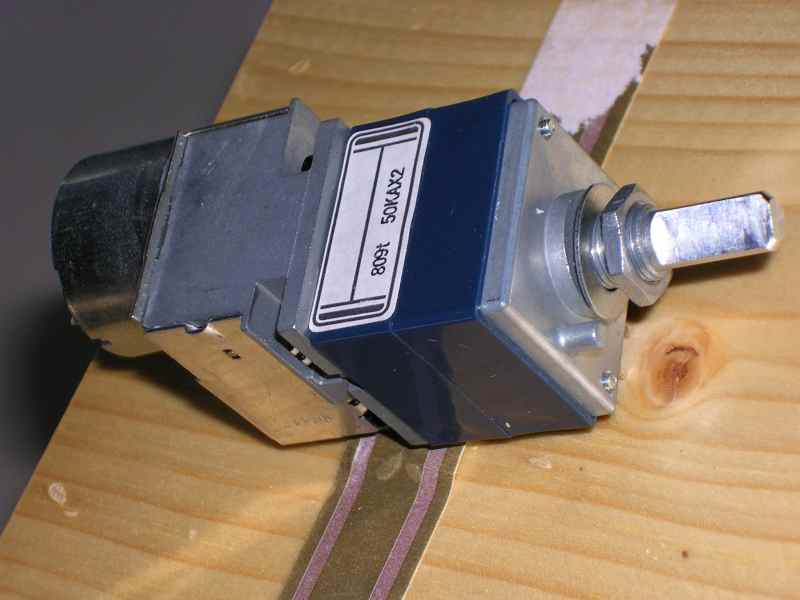

I've been thinking about making a tube preamp (among the half-million of things in the "to-do" queue), and the only thing that refrained me from building one was the absence of remote control.
Now that I got some ALPS blue motorized potentiometers (50k) I have no more excuses :cannotbe:
I've seen two circuits that might fit, the Supertotem from Filippo22's site (here) and the TNT Simpre....
What would you choose? Should I go for the simplest first?
Alternative proposals?
Cheers
Andrea

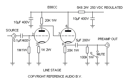

I understand. What if I can get hold of 2*E82CC (how do they compare with the 5687=182CC ?) and 2* E83CC ?
E82CC tends to sound anemic to my ears. The E182CC and 5687 don't really compare but I'd much prefer the 5687 for preamp duties. E83CC (TESLA?) is fine for a MM phonostage.
And Yes, I'd gladly see your proposal for a (line) preamp with the parts I have.
The tube regulated 250V is highly recommended for this linestage.
It sounds neutral with the right passive components, I used tantalum resistors for anodes and bias resistors.
If you can't get them the Kiwames go well with the ECC88s.
Cheers,;)
Cheers,;)
Hello Frank,
you mean to regulate the B+ or to "tube" regulate the B+?
Sorry for ignorance, but where to find tantalum resistors/Kiwames?
The 50k pot is placed at the input before the cap?
Cheers
Andrea
That's indeed the idea.
