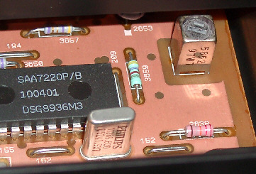

Is the thingie in the upper right corner a spdif transformer ?
Does it have to be adjusted ?
I have a Denon dcd 920, the transformer is marked on the board as such.
Is it better ?
Is the 11.xxxxx MHz crystal worth keeping for some re-clocking or other purpose ?

It is a SPDIF transformer as indicated in the service manual. It needs to be replaced ( if you plan to use SPDIF ) as it is garbage. You don't work without schematics, do you ? FYI : Ultranalog sells a cd with all the Philips manuals you need including the models you own.
Search for digital transformer and you'll find some threads about the subject. Just 2 pages ago this was discussed, read that again please. Adjustment makes no sense.
You can keep the crystal but canned low jitter clocks are much much beter. A Philips/Marantz with original clock does not sound real good. Mounting a new clock will make your cdplayer sing. In my words it is 50% of possible mods.
I assume you've built a Kwak clock, I can't comment on that as I use Tent clock modules. Heard a "better" crystal ( in the standard setup ) once but it was just a subtle difference compared to the original one
Yes I'm using Kwak Clock.I was just wondering how much improvement can a good crystal bring.
Thanks for your answer.
