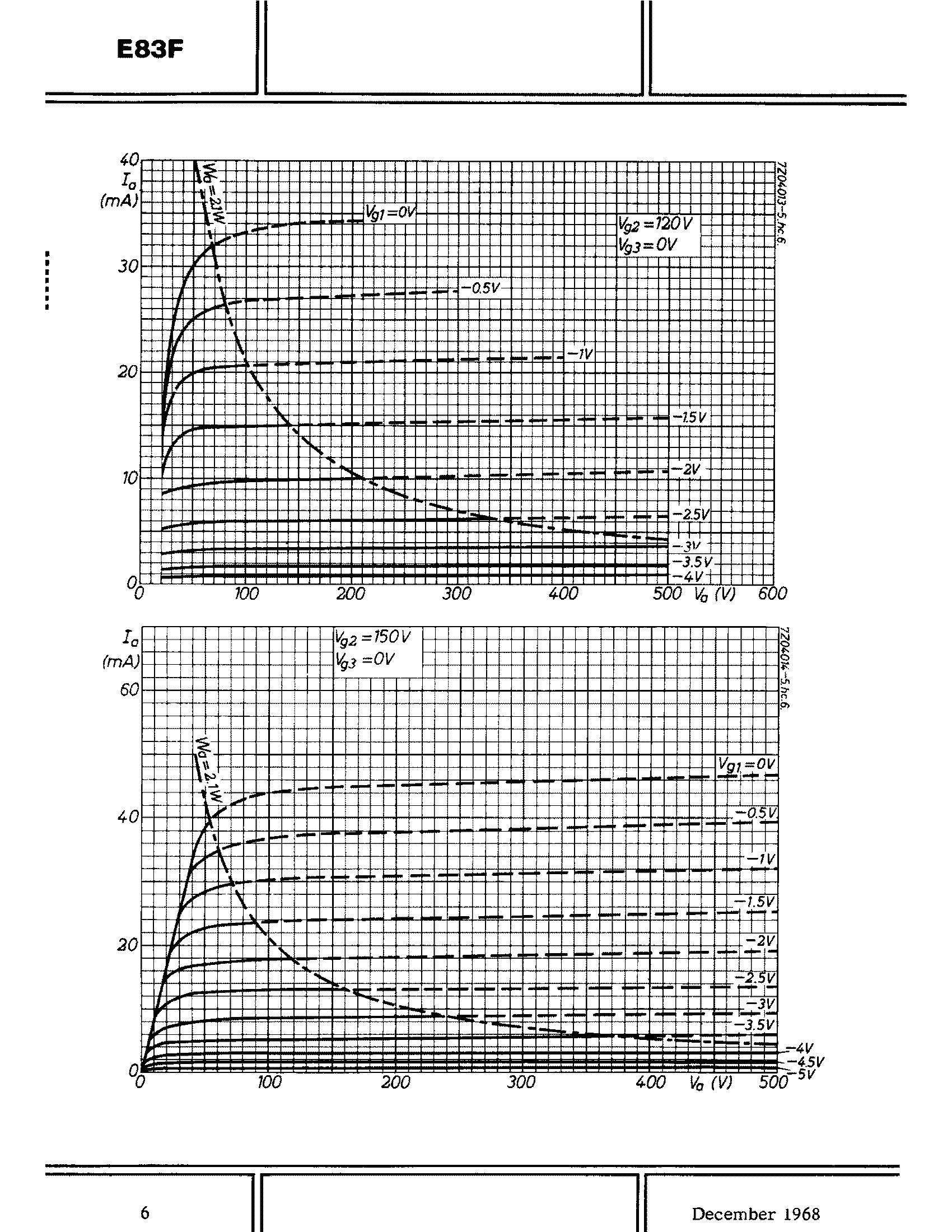

Doesn't look like a very sharp cutoff to me:
That looks quite typical of a sharp cutoff. If it were remote, the lowest grid voltage would be 10 or 20V, not 5.

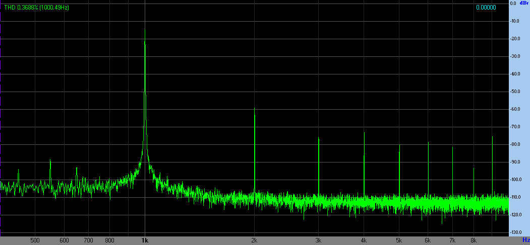

Note that it was tested as a triode. The results look pretty much like what I've seen, which is why I use that tube a lot.

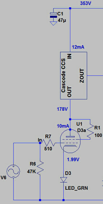

I use D3a in triode mode too, but with choke load (Electraprint 100H/30mA) - I get Au=73 for driving 300B - maybe the best of results for one tube.
In add. you'll get low Ri too. I not use it in pentode mode, (too high Ri for driver) or with CCS, but only with choke load.
