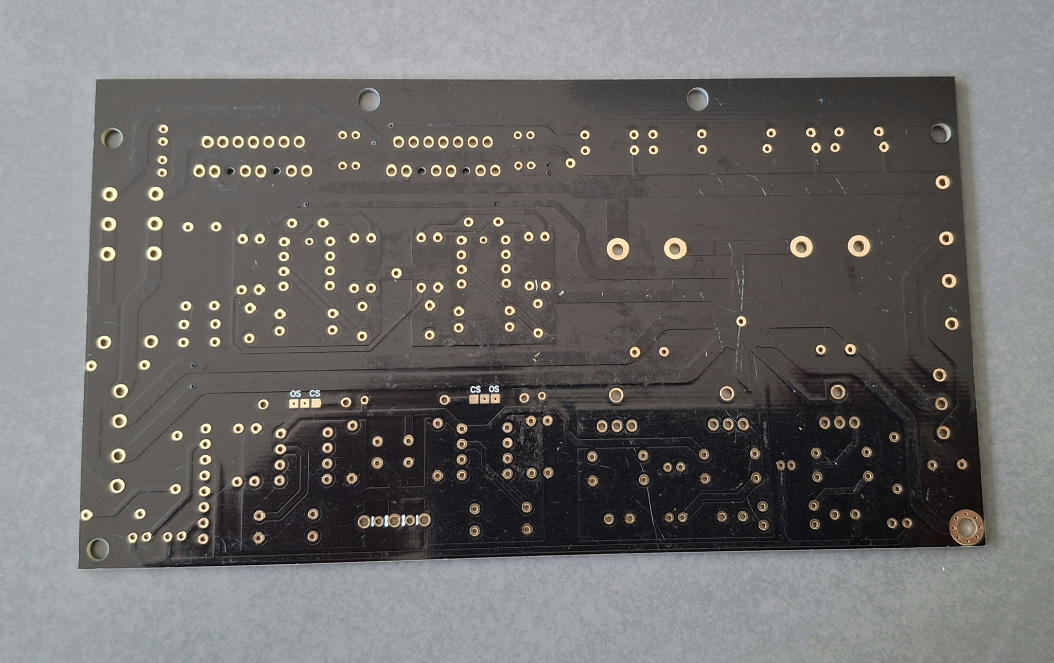

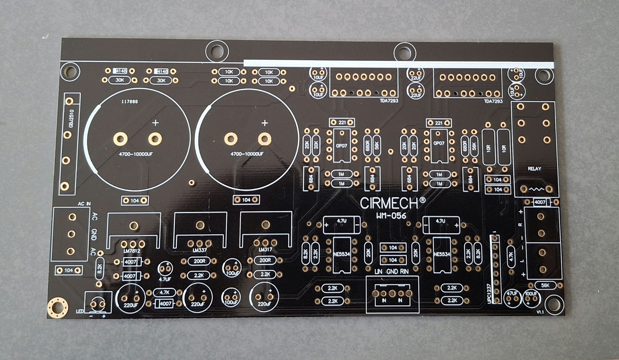

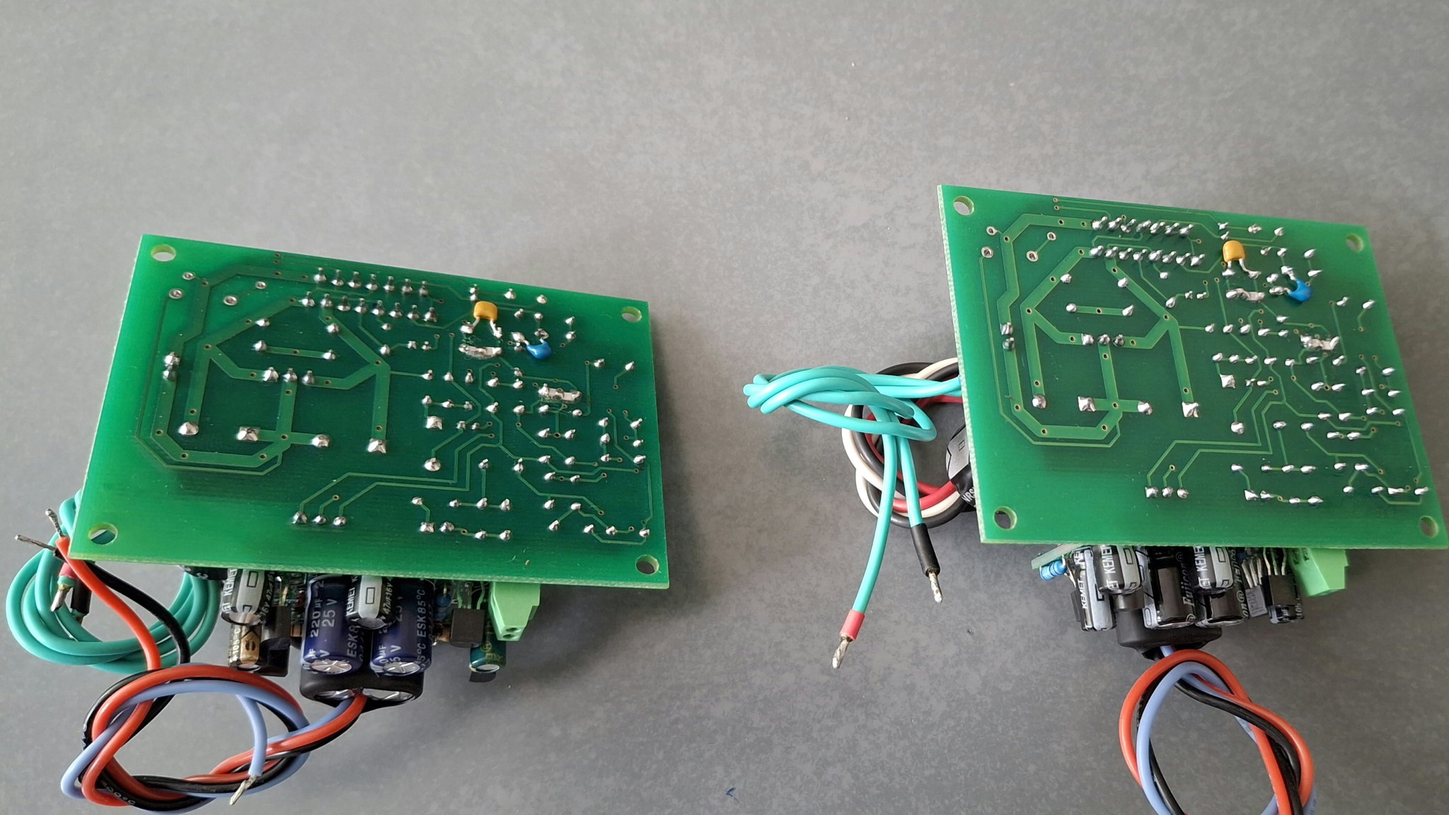

I received two boards today. I ordered the TDA7293 and received the TDA7294 (fully assembled boards). I'm not sure if I like these things; at first glance, they don't look good, and they're completely overpriced.Me too, indeed!

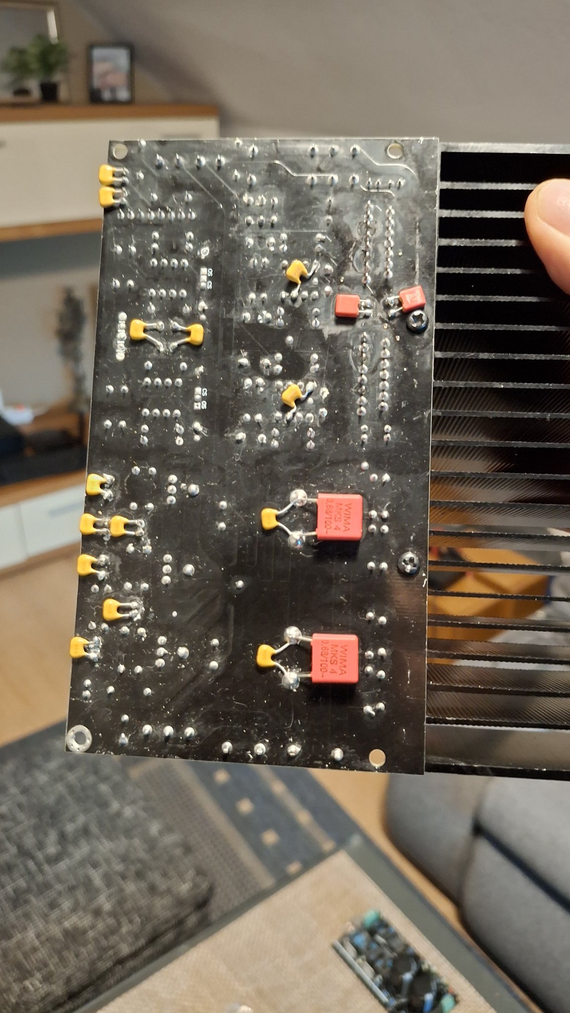

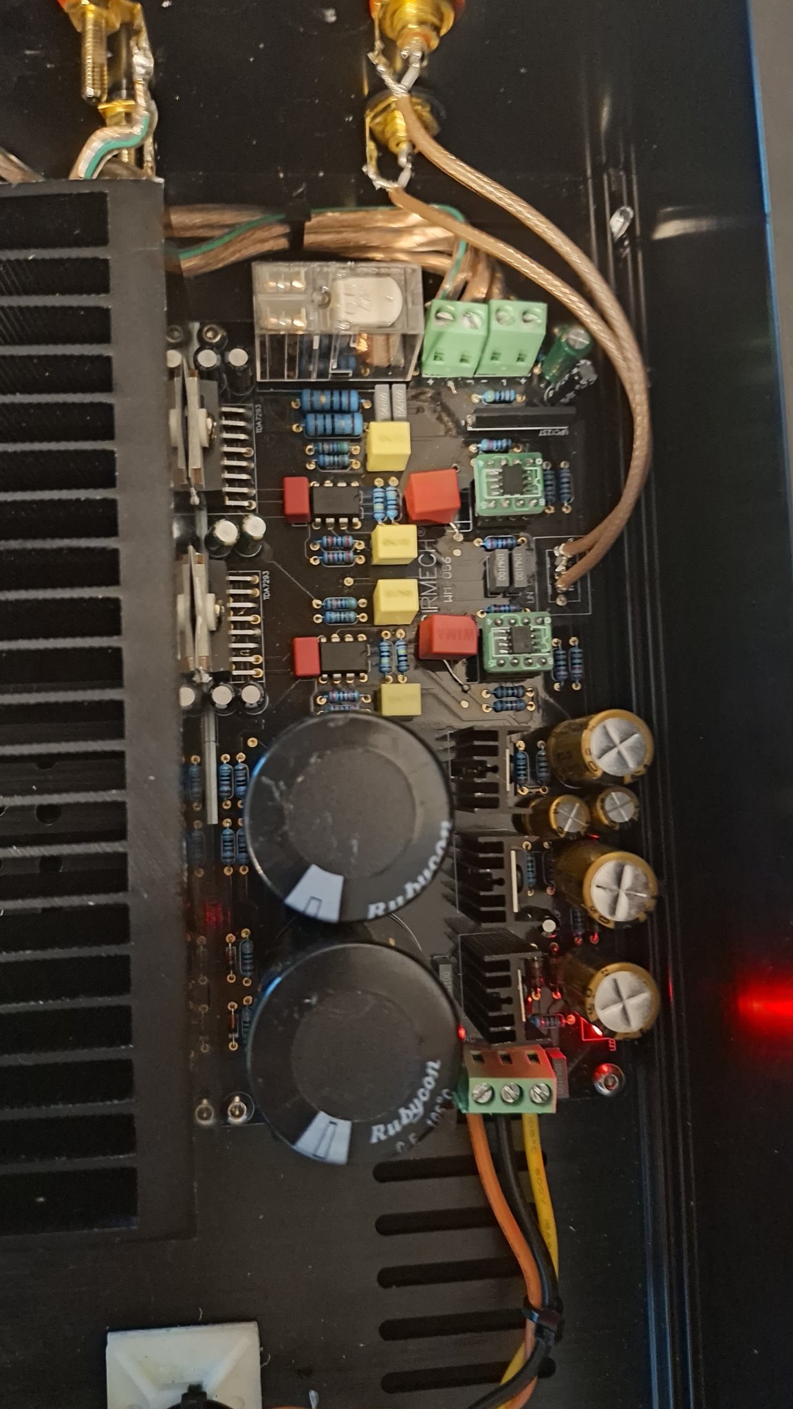

To be honest, the Kaltec boards are rather unprofessionally constructed. The Chinese boards, which I usually use for TDA7293 composite feedback setups, are much better. I use the OPA1656 as the op-amp and the OPA277 as the servo. The component values can be adopted from the Chinese board. It sounds very good; compared to my Naim Nait5si, the power is a bit lower, but dynamically, the Chinese board keeps up; the highs are even finer, and the spatiality is wider.

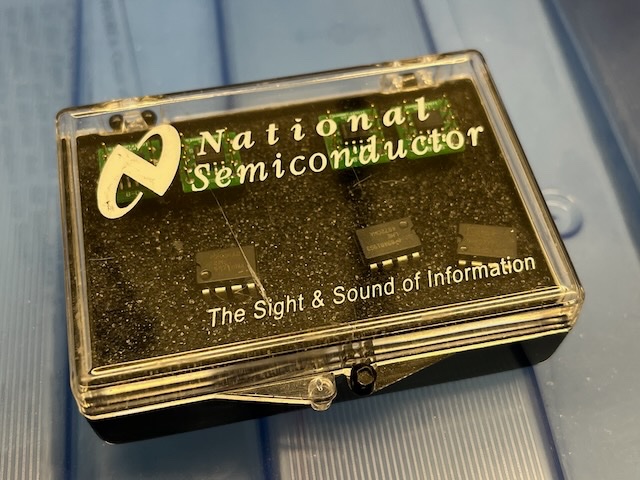

I remember the Blue Boxes National Semiconductor put the Overture© samples and datasheets in back in 1996 when they were introduced. Some of the LMxxxx chips were in little plastic 'jewel' cases. They made thousands of sample circuit boards to get you up and running. I fell in love instantly.
These?
This particular one is one of the newer ones as you can tell by the stylized logo. We had many of those floating around at work and I still have a few kicking around. They're pretty nice antistatic boxes.
