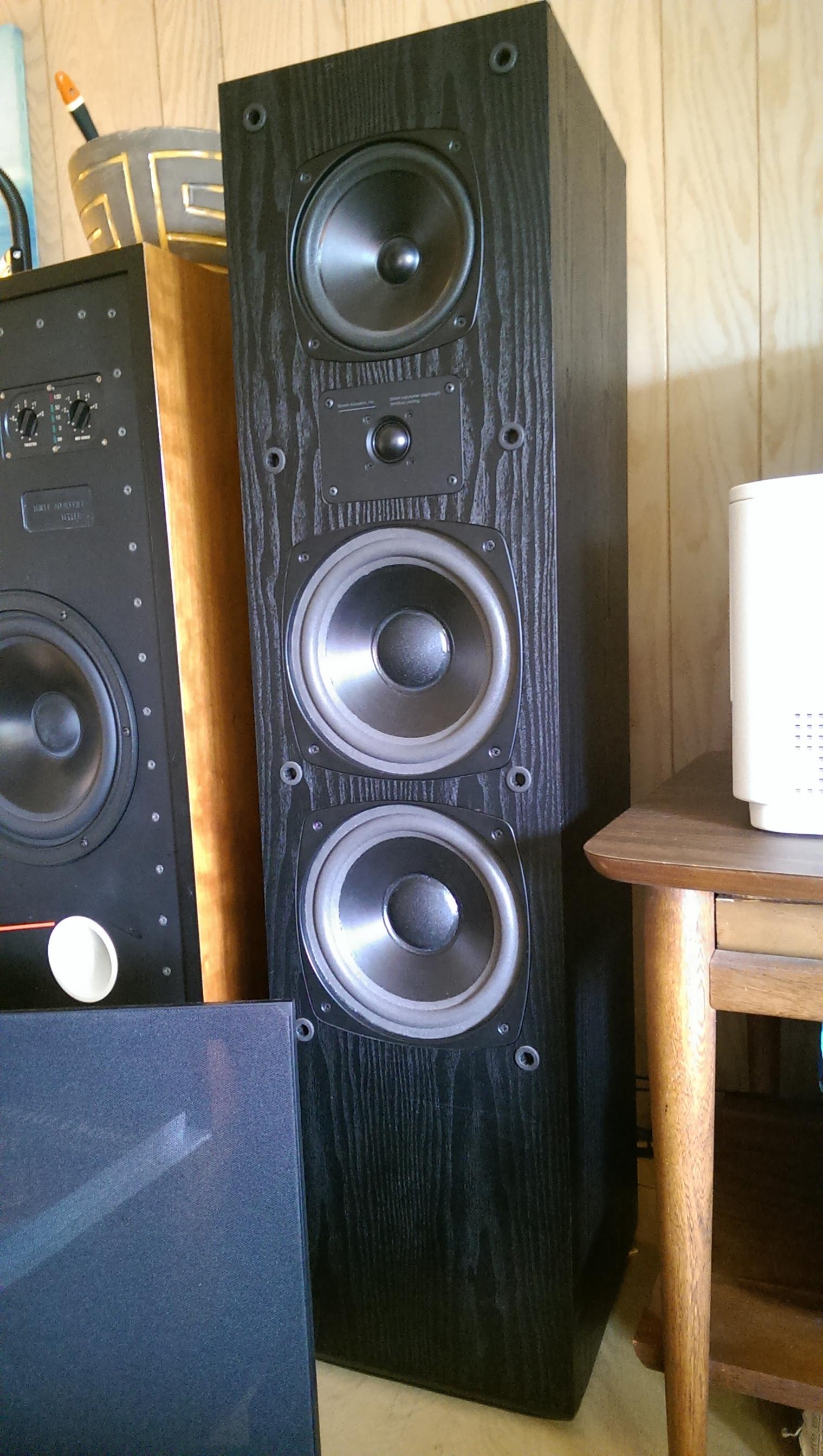

Have to agree somewhat with trying options for modular, bi/tri-amping XOs mentioned in 3 previous posts ...Thanks. Again, the options seems almost exponential.
My actual 'building' has been delayed by recent speakers I've accquired by dumb luck.
Picked up a nice pair of Boston Acoustics T1030 towers with biamping option. A week later inherited a almost new (unused/stored for 20+ years) pair of Boston Acoustics T1000......unbelievable ! Not SOArt, but perfect for modular XO setup.....
So fate is making decisions for me.....works for me, seeing how I can't make up my own mind.
I can see an amp atop each one of these towers maybe with PSUs in a bottom pedestal....
Each tower self contained feed by common source/DAC/Pre
Charles
