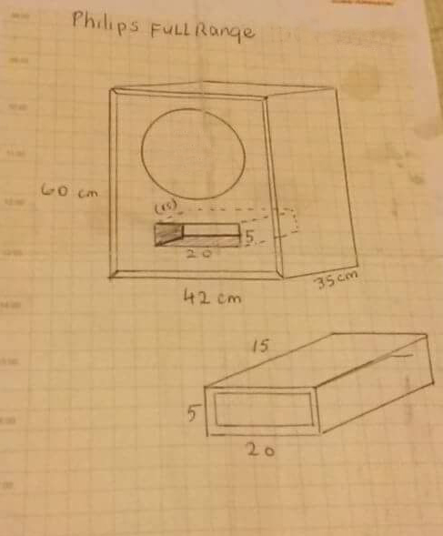

I have a similar 8" Phillips fullrange driver, thinking of building a box for the pair...I understand yours is a 140ltr box, can you help me with the dimensions...the specs on the driver are very weird and many folks from other forums claim it will sound similar in most box sizes...
I discarded these big boxes because of the waf issues.
I'm digging for box sizes for hours but i couldnt find.
Instead I found these drawing. Shared by original philips fr cabinet owner. I wanted to try this one but I dont have patience and wife for that too..

Thank you Starbender, I would try build one for my 8" fullranges and share results, though it will take quite a while for me...I am more happy soldering than hammering...[emoji28]
