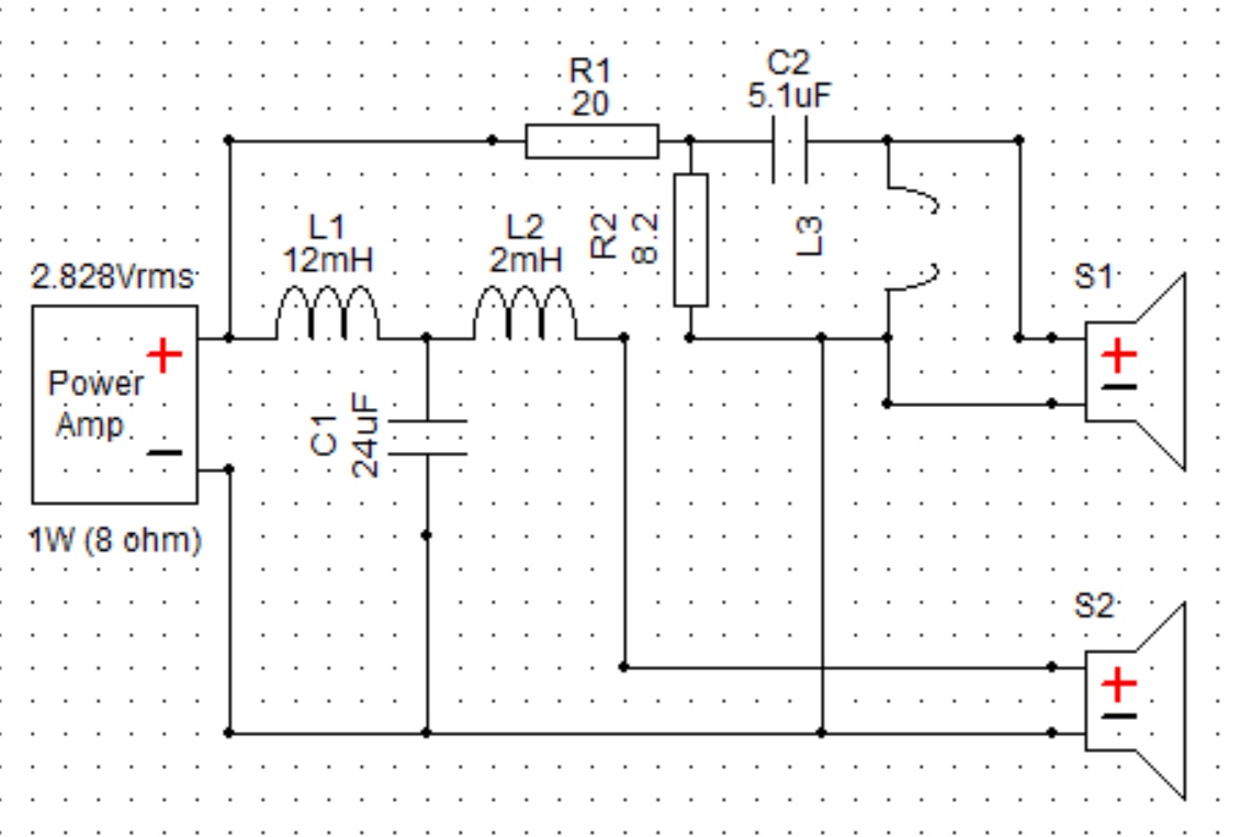

Could you share your passive crossover and FIR filtering and MS processing?
I use too 2226 2445h and 2380 with 6db series crossover and CD compensation for the rolloff of the horn
See attached pic for the crossover. It is a 6 db/oct filter for the 2380/2445 combination and the woofer is a 3rd order filter. The horn has natural roll off in the 600 Hz region and with just a single cap and a resistive divider to adjust for sensitivity, there is a very smooth transition. I saw this in a JBL spec sheet for this driver/horn combo. I tried higher orders, but this works best so far and there is no sign of the horn/driver being in trouble at lower frequencies. There is nice phase overlap--the most important thing with crossovers--between the woofer and horn, but the response through the crossover region is not flat. However, the FIR correction takes care of this. The filter is derived using multiple measurements around the listening spot and then corrected using DRC and a tailored target curve for my room, which I arrived at through trial and error.

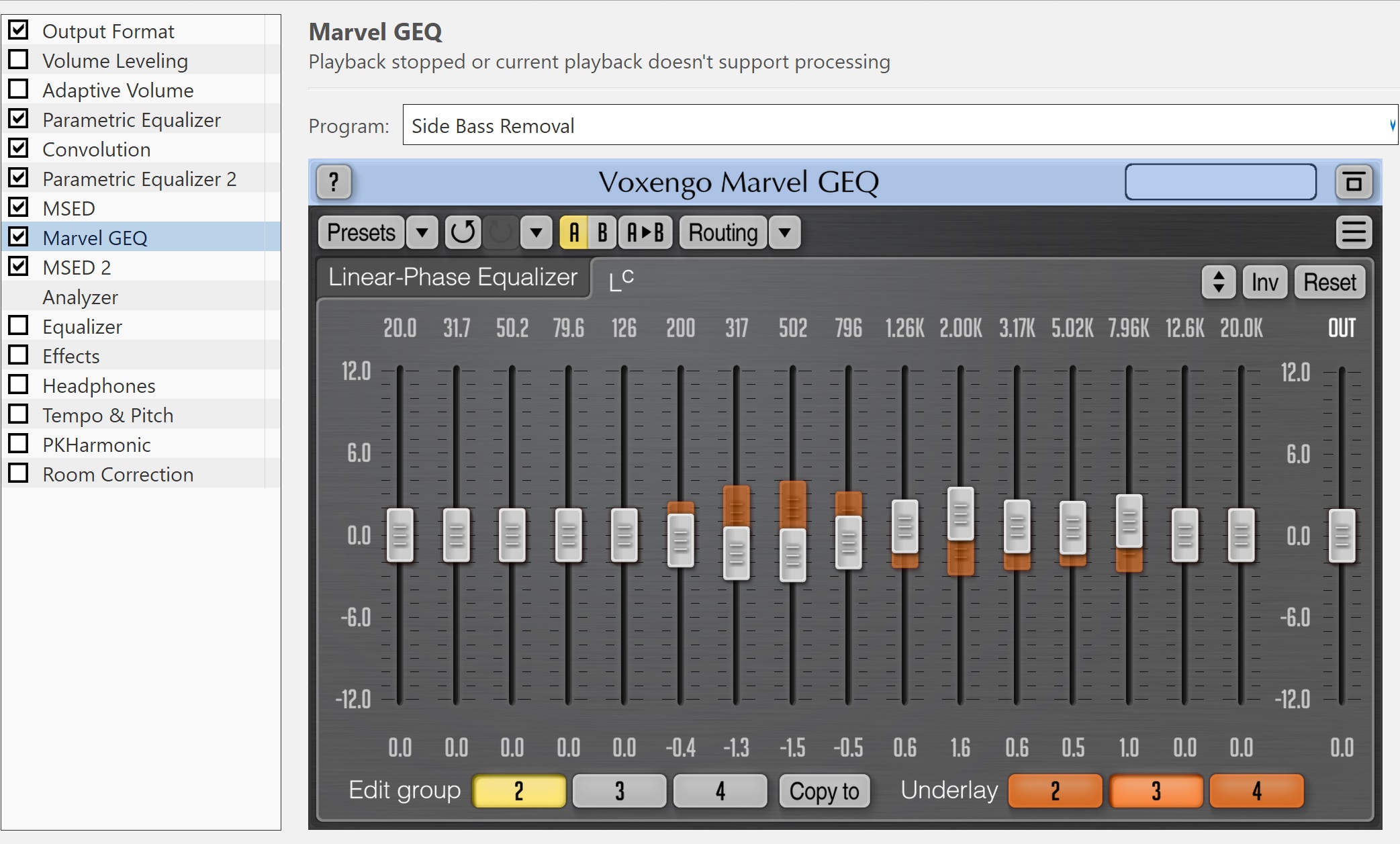

The MS EQ is shown in the second pic. It is based on Wesayso's work in his towers thread. It started with my corner line arrays and I kept it for the horns, where it works equally well. It improves the center image tonality and the image localization. Finally, I've been playing with a 45 deg phase delta in the HF. See here: https://www.diyaudio.com/forums/multi-way/277519-fixing-stereo-phantom-center-99.html#post6225137. Would be interesting to note what you perceive, if you ever play with it.
