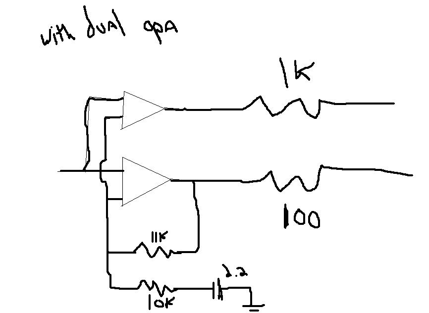

If i wanted to use the second side of the 2134 to drive the di,
I would split the inputs to each opa and have the output of the second opa go to the 1k resistor for the DI?
Like this?
http://img.photobucket.com/albums/v166/Carnesd/dualopa.jpg
Or would I have to change resistor values because of the load change?

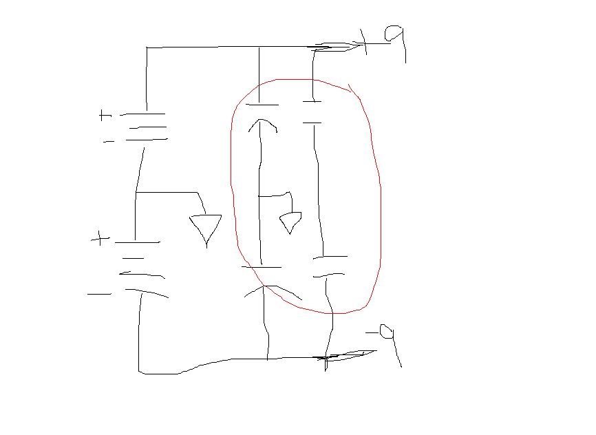

The batteries are connected in series... the ground is the center connection between the batteries and goes to the input socket. All those downward pointing arrows connect to that point too. You need a switch that isoltaes both batteries to power it off, unless you are using the transistors as shown.
Thanks for the reply Mooly, I think you may have sorted my problem.
Since I was using the switch and not the original design, for some reason I guess I had a brain fart and wired the batteries in parallel thinking that series would give me 18v but since the op amp said 9v I was thinking I needed them in parallel, But I didn't think about the -9v on the other side.
Ok, so now I will wire the batteries in series with an input ground between them. Am I also going to need these capacitors parallel to the batteries?
<a href="http://smg.photobucket.com/albums/v166/Carnesd/?action=view&current=batt.jpg" target="_blank"><img src="http://img.photobucket.com/albums/v166/Carnesd/batt.jpg" border="0" alt="Photobucket"></a>
At a minimum keep the 100 nf caps that should be as close to the power pins on the op amp as possible for stability. The 47 uf caps will help reduce battery noise. Not absolutely necessary but a good idea.
Ground both inputs on the unused half of your opamp.
