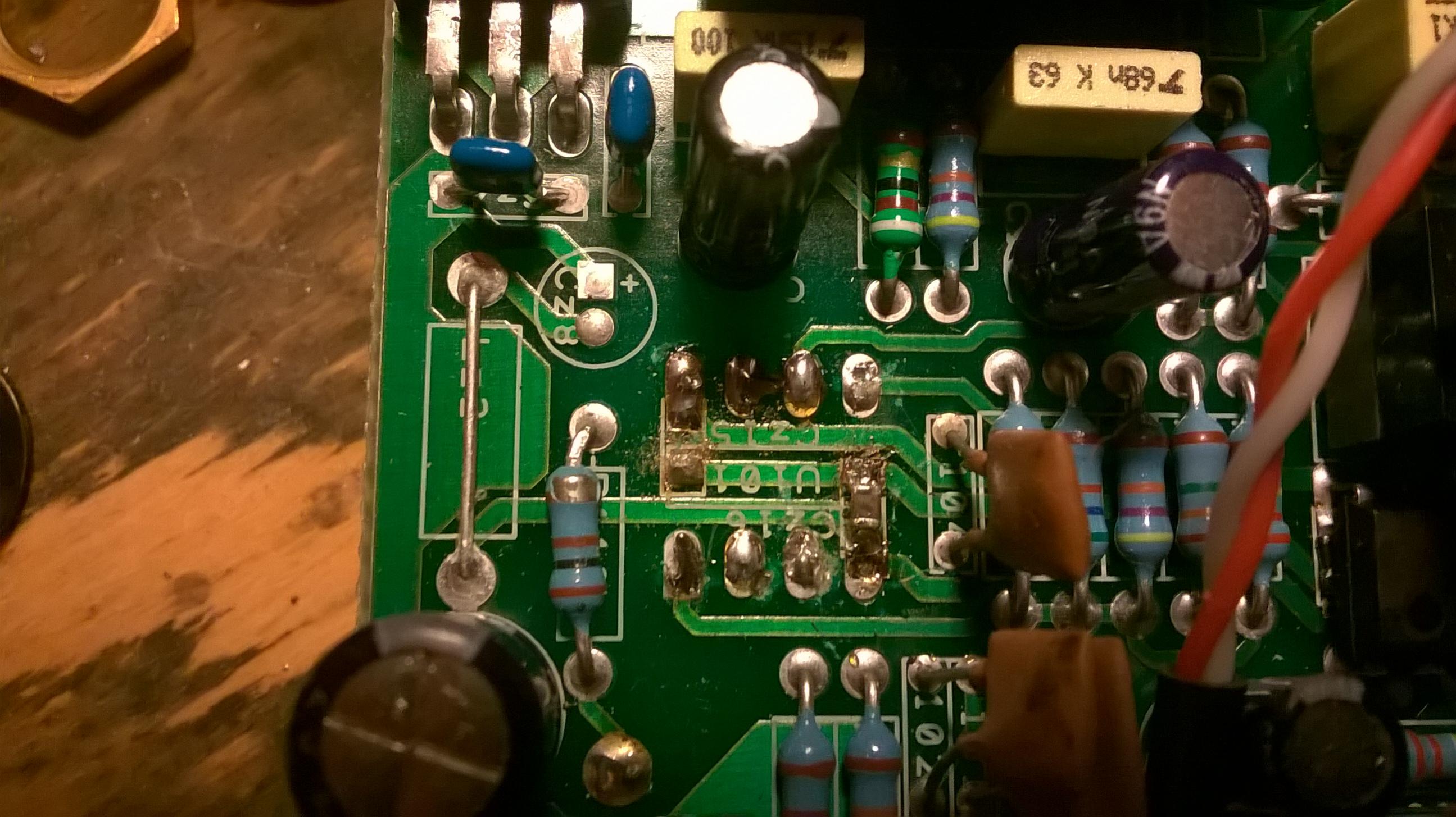

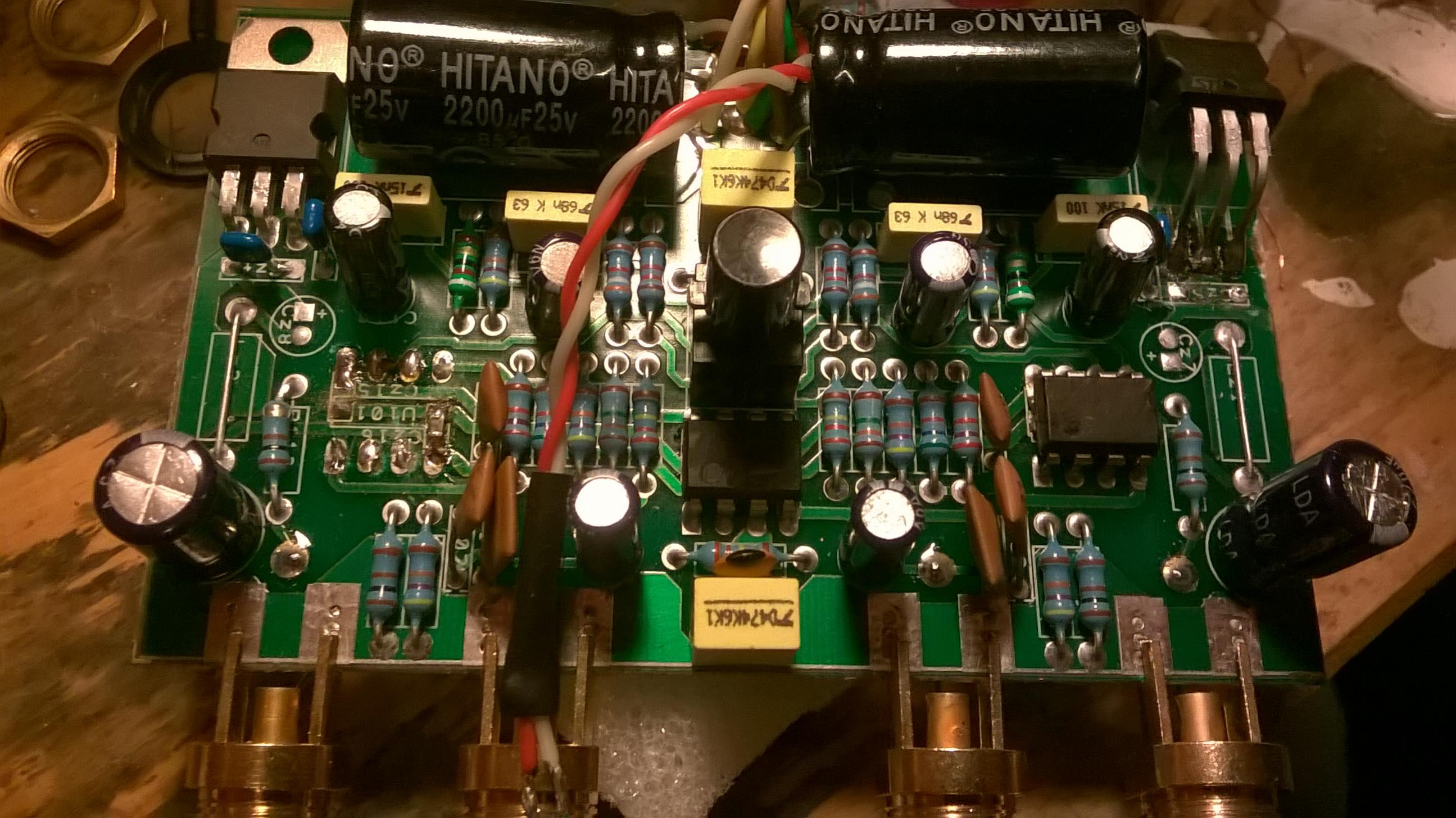

Greetings.
I'm repairing a friend's Clearaudio Basic. One of the OPs needs to be replaced. The DIL-8 case is scrubbed and the label is unreadable. Does anyone know which OP is used in Clearaudio Basic?

Correction: I checked the PCB and the V+ goes to pin 8. V- is pin 4, you can see this on the close up image, pin 4 goes to bare wire jumper to the left which is V- out on the 7918 DC/DC converter.
This review is talking about the Clearaudio Basic+ (I have the Basic) and Burr-Brown OP amps. Perhaps the Basic is using a OPA2134? At least the V- and V+ pins match the PCB layout. Not sure about the rest.

I have asked (today) yes. No reply yet. Maybe they are reluctant to tell since they've scratched the labels on the casings. So far, I've found the following candidates:
OPA2134 (JFET)
NE5532 (Bipolar)
OPA275 (Hybrid?)
OPA2134 (JFET)
NE5532 (Bipolar)
OPA275 (Hybrid?)
The transformer, one voltage regulator, one op amp and the power indicator LED (!) were all toast. All replaced (including an opa2134) and electrically all seem to be fine.

With pin 8 as plus they are duals (as your likely list shows). OPA2604 is a good performer and pretty universal. For a bjt type it has to be the LM4562 🙂
Change both opamps so you keep L and R identical, maybe fitting sockets so you can have a play later.
A tip for removing them from double sided print. Snip each leg and remove the opamp. Then heat and pull each remaining pin from the PCB. Then use a piece of stainless wire to run through the hole (solder won't take to stainless) and use braid to clean up the excess solder. Clean with ISO and it should look like new.
