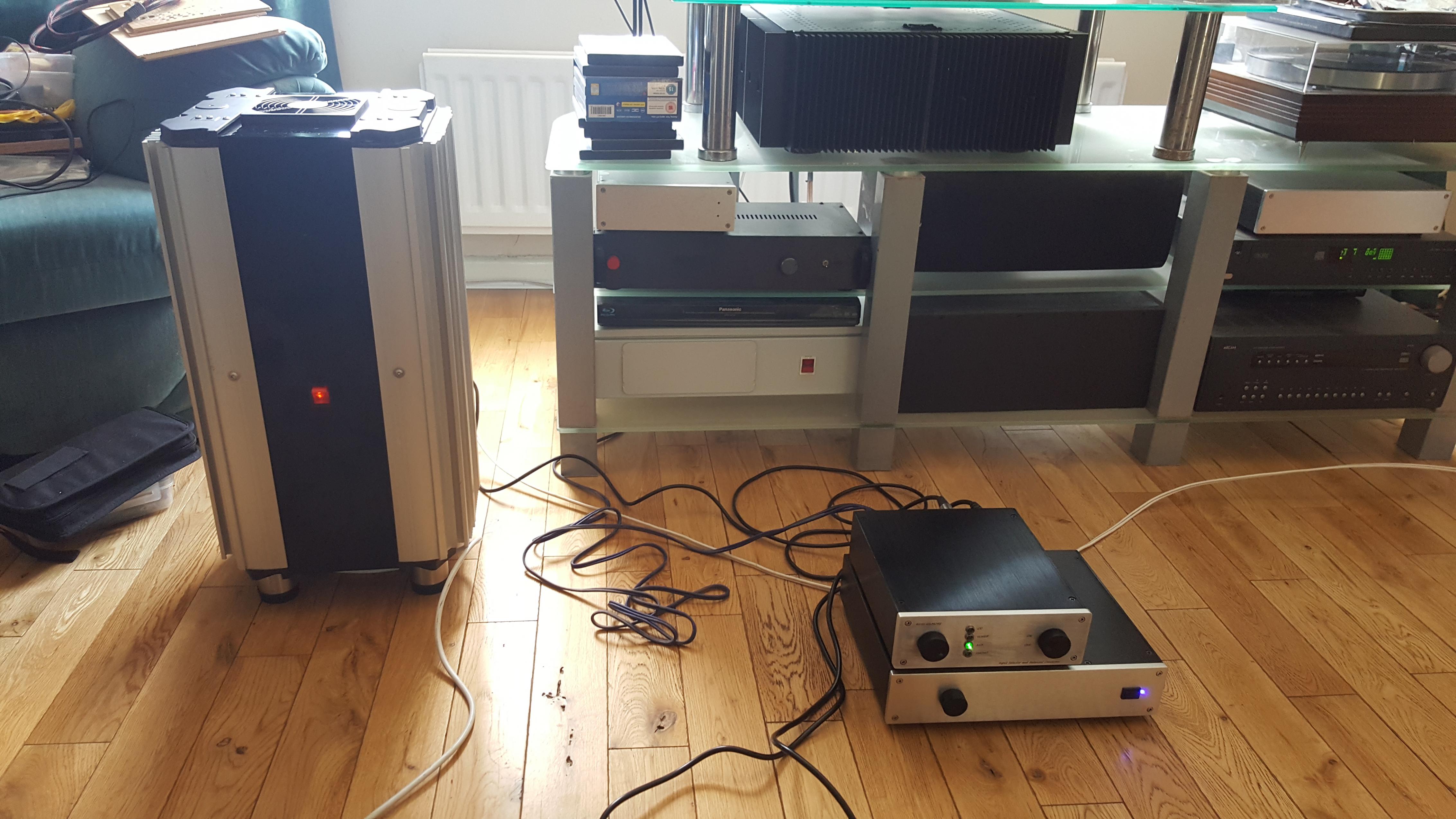

I've had an Aleph 4 (clone) for a long time and thoroughly love it.
I recently converted it to balanced operation and have paired it with an Aleph P1.7 (clone).
Whilst going through my spares bin I found enough components to build an Aleph J (clone).
Now I've got them both working I'm undecided which one to keep.
The Aleph 4 does have more punch when running at full power, and yes occasionally I do run it at 100W.
However, the difference between the 25W Aleph J and the 100W Aleph 4 is really marginal and is probably not audible at those volumes.
The Aleph J uses considerably less power and in my instance runs at a very cool 40C - the heatsinks are enormous. The Aleph 4 runs at about 60C.
I've not seen a review where anyone has compared the two.
The Aleph 4 did cook its PSU but now has a remote PSU. The Aleph J is self contained.
The two amplifiers are both really pleasant to listen to.
I do feel that the Aleph J is the better of the two at normal low level listening level, which is where it is normally used.
I'm listening with a pair of B&W CM8 Series 2 speakers.
I'm an advocate of having NOTHING in the speaker path, no relays.

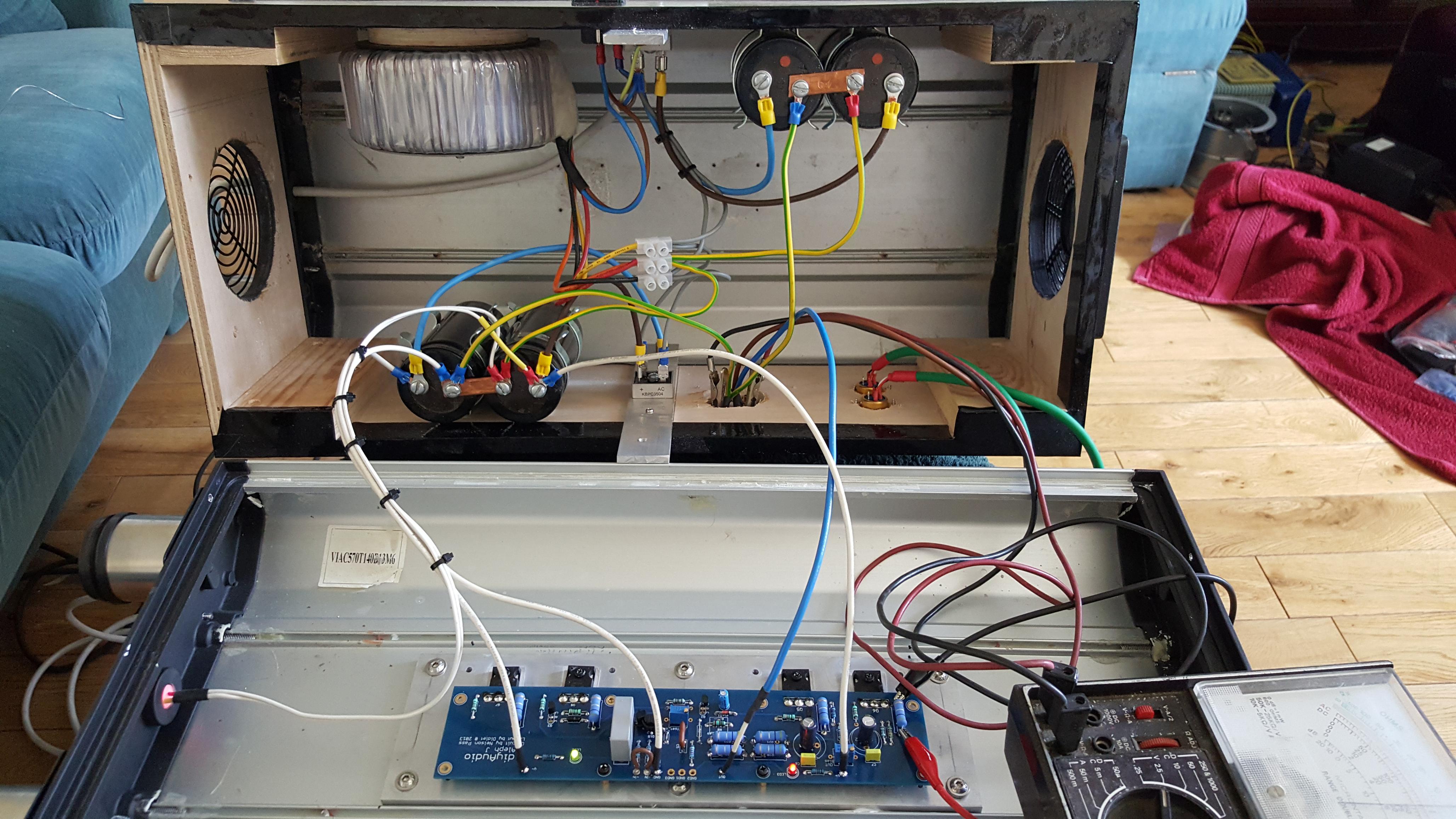

I built this one out of a pair of dead LED light fittings. I've got another pair of scrap fittings if anyone wants them.
These heatsinks run at very low 40C, well over spec'd for any of the FW amps.
