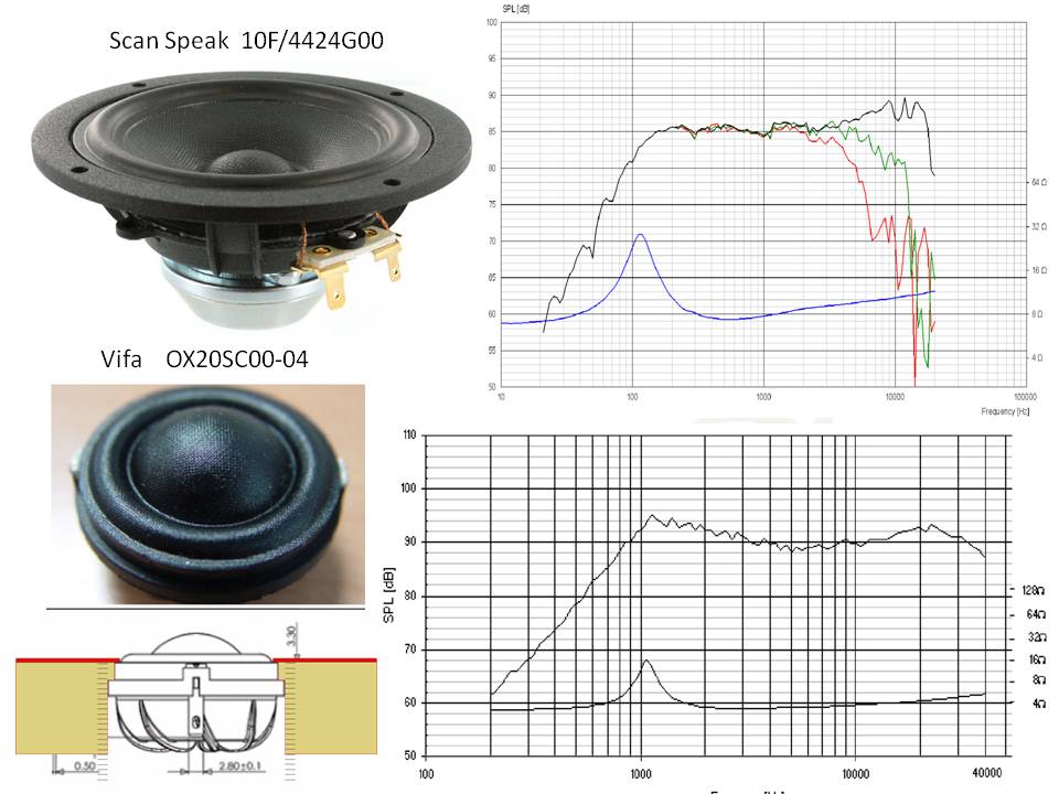

Would like to know which among the one will give the best midrange clarity and timbre?
Scanspeak 3 inch Middome?
Seas ER18RNX?
I see alot of lowther drivers or many midrange drivers having very very low displacements like +/- 1mm max why does it happen like that?
Seas ER18RNX?
rhythmsandy,
hard to tell just by looking at them or the specs. It depends very
much on speaker builders voicing skills.
Seas is bassmidrange, SS just a mid with very high Qts = 1,7
which is a sign of weak magnet. This doesn't show on FR
graph SS provided but they managed to hide it. Earlier the same
driver used to be sold under Vifa brand. $ 95 US for a SS mid
dome is a ripoff, IMO. This does not mean it can't be put to a
good use and perform well.
If I lived in US, I would have bought something like this:
The Madisound Speaker Store
For clean and unobtrusive mids with little to worry about XO
electronics, this would be the way.

Kinda hard to say comparing a 3" dome to a 6.5" midbass. Apples and oranges so to speak.

I haven't personally ever seen a 3 inch dome that had
a good enough frequency response either.
I did see, but never owned one. A good example would be
Ruark Excalibur or Solstice. Recognize one of the best
3 inch domes ever made ?

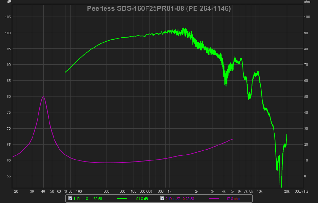

Here's a 6.5" midbass I'm currently messing with. Tested free air 1m on axis, raw.
Very good catch indeed, for 20 bucks a piece I'd buy a dozen🙂
