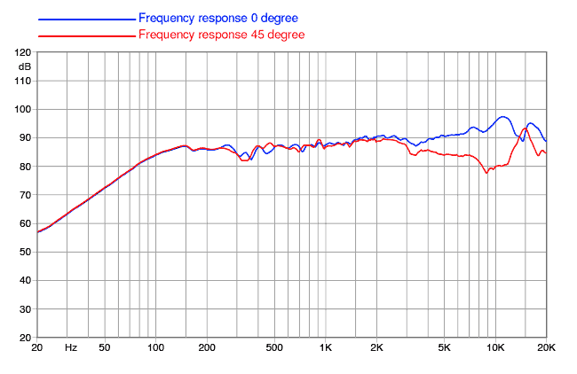

And somebody tried the 3 inch Faital Pro 3Fe25 ?
I think is a good driver , with cooper Faraday rings , unique frequency response , 2mm xmax ,etc

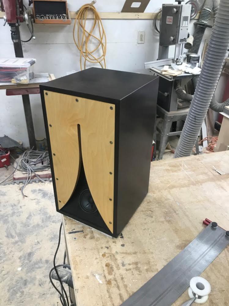

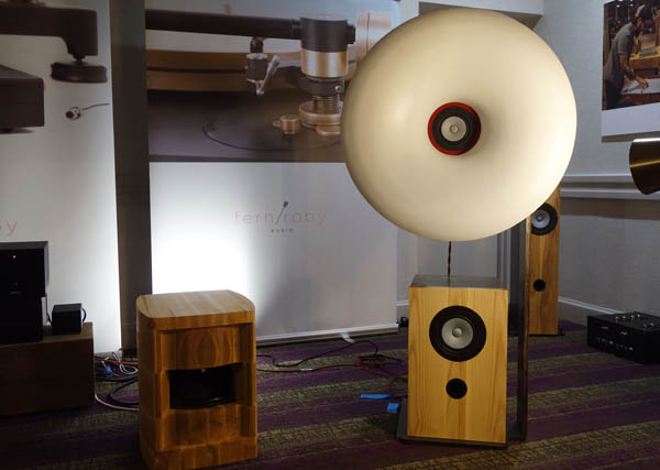

Fern & Roby horn load an Alpair 7, and cross to a 12PW. Seems like its stretching the rules of physics.
I remember asking Mark if I could horn load his drivers, and he said why would you want to do that? To summarise his response...They can handle power, the dispersion is good, and they operate over a wide frequency range.
They do? Where? I can see a 2-way which looks very similar to the 2-way I designed for DIYers which is not horn loaded, & I can't locate a horn loaded A7 crossed to a 12PW on their site. Do you have a link?
If it's my box then it's certainly doing no such thing, it's a perfectly straightforward vented load for the 12PW with the 7P in a sealed upper chamber. I can't see any extravagent / physics defying claims for it on their site either, although I've only had a very quick look. Do you have a link?
Which to put it mildly confuses me, given that Mark knows perfectly well that my Woden Megalith range of back horns are specifically designed for Mark Audio drive units, that Frugel-horn Mk3 [FH3] was designed using the 4in Mark Audio models as the baseline drive units, Frugel-horn XL [FHXL] was designed using the 5in Mark Audio models as the baseline drive units, while the 3in Mark Audio drivers are a preferred option for Frugel-horn Lite (FH-lite), not counting dozens of other designs. Are you sure you've remembered correctly or not overgeneralising the word 'horn'? I can imagine he might say that about front horns, since the drivers are not well suited to such use, but Mark knows his drivers are used in back-loaded bass horns: we were at the North West Audio Show only a couple of weeks ago where the MA dealer room (KJF audio) was running the drivers exclusively in the three different frugel-horn variations. No other enclosure types present.
All of which within the overall context is true, but has no connection to back-loaded bass horns. Perhaps some wider context was missed; it's easily done.
Ah, that would explain it; I thought I must be missing something (my apologies, nothing new about that... 😉 ). Found an image & some notes from Stereophile; vented box 12PW with a 7P in a short mid-horn / waveguide. The compression ratio doesn't look especially high so unlikely to cause problems for the paper cone.
In practice, it should give an efficiency boost on the lower end of the mid-tweet, lowering distortion when EQ'd flat. Directivity = name your poison; I know Mark likes wide dispersion (hence the negative camber cone approach) which has its advantages; likewise the alternate waveguide / enhanced directivity has also. Depends what you like / need. Those 2-way towers on their site for e.g. do look like the design I did a while back, but it appears they're using a 10P for mid-tweet duties. Very pretty, what with that solid wood & the presumably brass plating. 🙂
Probably discontinued because it gave way too little bang for the buck. With the very large throat (based on my CAD drawings the cone are is some 32% of the throat). Properly done the troat would need to be near cone size and a lot longer (and more expensive and more intrusive).
