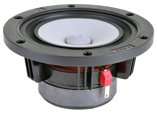

Like said, all Mark Audio are in the same league, and differences are small. It's all depending on the implementation (wich speaker box, single driver or in combination of a tweeter or subwoofer, what is your goal, ...)
I prefer the 10M Gen3 driver in a WAW config with an subwoofer tuned low and with a 1st order crossover at 150-200Hz, so that is what i build. But others prefer something else with this. Some want no sub or CR and use all kind of horns with this drivers (see Planet10's site for inspiration). Some prefer the 12P, others want the 7P. But at the end they are great drivers, and very hard to beat for their pricerange.

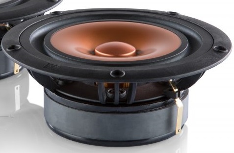

From all I have read and heard. Most seem to favour the metal cones over paper. Not all, but most. They don't sound at all metallic and some oddly think the paper ones have a more metal colouring of the sound. I think the paper ones are often tuned more for the asian market?
I love the 7.3. But it's now out of production. 10's are bigger, can go a bit louder, push more air, but lack that small super fast driver sparkle.

I have said that many times ref the A7.3 & the A7p. Those 2 do not have the same relationship/sonic signature as the other paper/metal pairs )ie A6.2m/p, A10.3/p
Me too. A7.3eN (or A7 MAOP) are my personal favorites. Mostly for the greater DDR. I tend to prefer listeningg to the paper A10 or A6, but the metals are very good and probably a bit more accurate. Any can be used as a midTweeter, where one can end up with a few compromises loudspeaker.
The new ms genertion has a lot of potential. The A5.2eN is superb, the A11ms (haven’t EnABLed one yet) sounds fantastic (not the DDR of A10.3eN but that will, i strongly suspect, be fixed by EnABLing them. That makes for high expectations of the A7ms. On paper it looks better than the A11ms, goes as low in a BR (just won’t move as much air). In particular the shape of the cone and single suspesion coule well make them a staggeringly good midTweeter.

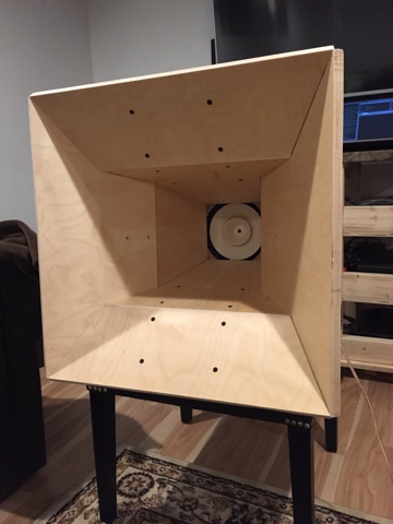

What horn, what flare frequency, what size, what rear chamber load and which driver? All of those dominate the frequency response, so we can't answer your question without further information as there isn't a single answer, more an infinity of different ones.
Unfortunately, it doesn't really work that way. A horn, even a front loaded one, can only provide an efficiency boost over a desired passband, which is usually relatively limited. So it depends what you mean by 'decent work', i.e. what range and other characteristics are desired.
...even a front loaded one, can only provide an efficiency boost over a desired passband, which is usually relatively limited...
Usually 3 or at most 3 octaves. When front loading a FR driver (usually as. amidTweeter) the HFs need to be boosted sufficiently that when the low end of the drivers ranges efficiency is increased by the horn the top end can keep up. Or a whole lot of EQ with its downsides.

OK , and somebody try some mark audio driver in a front loaded horn ?
Somebody know how would be the freq response ?
This is a waveguide [WG] designed to 'focus' its polar response over a narrower arc in both planes, not a compression horn designed to 'squeeze' it to high gain over a narrow BW; big difference.
Put an MA or similar in a compression horn and its power handling would be severely limited to keep from deforming the diaphragm and/or suspension, so basically useless.

As GM says, the MA drivers (like most wideband units) are fine for wavegudes or back-loaded horns with a moderate compression ratio; however they can't be used in high compression ratio / compression horns as you'll deform the diaphragm since they weren't designed for this type of use. That's where (primarily) dedicated compression drivers come into their own.

I can tell you which MA drivers i prefer. Top of that list so far is Alpair 7.3eN or A7 MAOP. Next, not far behind are the 2 A10s (EnABLed of course), A6.2, A5.2. No particular order with those, each has its own sets of balances, the metals probably being more accurate, but the papers having their own assets.Again, application and target use are of high importance. The A12pw is a tremendos midBass. The A11ms/A7ms are waiting in the wings. I have heard the A11ms (i have 24 A7ms awaiting processing), and stock it does somethings better than A10.3eN, some not. I expect its deficincies in comparison to dissapear once EnABLed. A7ms looks better on paper than its larger brother. The Pluvia 7HD is supposed to be a rejiggered A7.3 which, if it holds up, will be a tremendous bargain.
