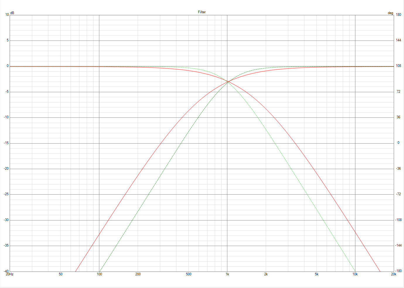

I'm talking about designing "second-order" filters. The goal is to achieve "flat" frequency response. We have a couple alignments to implement. Let us pick two alignments for comparison: Butterworth and Linkwitz-Riley characteristics.
Imagine the "FLAT" FR curve, depicted on attached, the difference we can see on it is the "overlap" region.
Which one do you prefer between large and small overlap, and why?

Red curves = Linkwitz-Riley (large overlap)
Green curves = Butterworth (small overlap)

One can imagine it, but your depicted curves are not those of classic second order LR (-6dB at the crossover point), which sum flat, and the BW (-3dB at the crossover point) which sums +3dB at the crossover point:Imagine the "FLAT" FR curve, depicted on attached, the difference we can see on it is the "overlap" region.

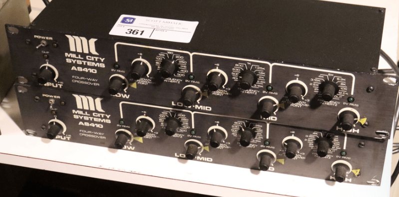

Jim Geisler designed and built analog four-way active crossovers (Mill City Systems AS410) that could (sort of) "morph" between the two.
Back in 1979, few of us users knew the difference between the BW & LR, we conferred over what to call the control knob, and settled on "DB DOWN AT CROSSOVER POINT".
At the 12 o'clock position, -6dB ("LR"), 5 o'clock -3dB ("BW"), 7 o'clock position not sure, but probably -9dB.
I was surprised to find the photo on line, few were made.
Sold mine (the first pair built) shortly after finding how much better the BSS (Brooke Siren Systems) using LR fourth order crossovers sounded, minimizing the overlap area, each output in phase through the crossover region.
The early BSS crossover points were fixed, to change them required exchanging lots of components on removable cards.
Even though the BSS LR crossovers in theory would sum flat, still had to cut the three crossover frequency points on a 1/3 octave EQ another -3dB to make a flat acoustic response with the speaker systems we were using. We used standard ISO 1/3 octave points back then, parametric EQ's were not too well accepted 😉

"Textbook" filters seldom perform like they look when combined with real drivers, but in general I prefer the flat response of the LR.Which one do you prefer between large and small overlap, and why?
That said, for a HP filter used to limit excursion below Fb (box tuning) on ported speakers, I prefer the BW's response.
Anyway, whatever IIR filters, EQ, polarity (and delay..) it takes to get a smooth phase transition between the acoustic crossover points are the ones I prefer.
