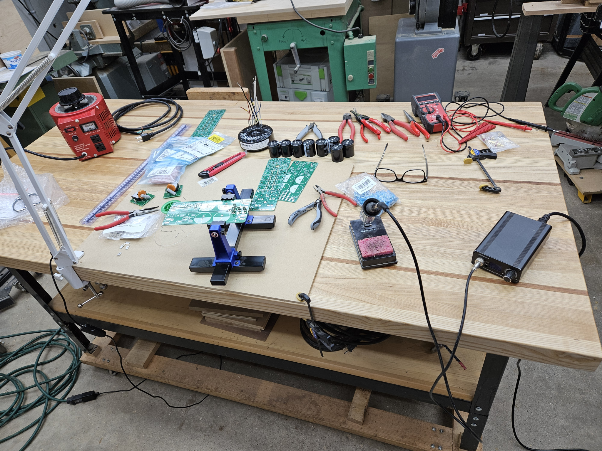

Starting on a pair of power supplies for two mono Nelson Pass AB100 amplifiers. Transformers will be 250VA, 32volts, with four caps per side.

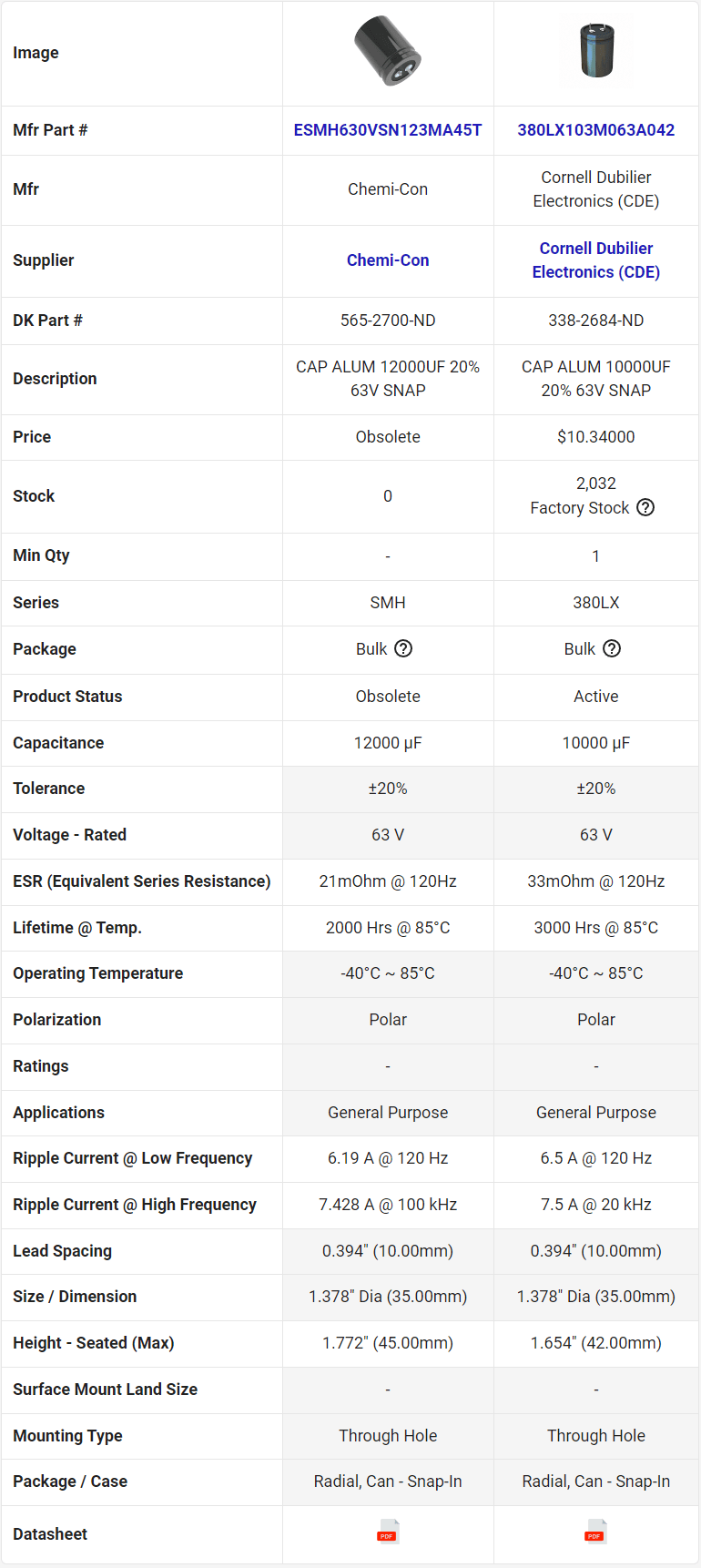

I already have 8 of each of these caps, trying to decide which one to use.
Link to Both caps on Digikey
Either one will be fine, with a tiny edge to the CDE for slightly higher lifetime under maximum load (but it won't be running max current 99% of the time).
Both essentially the same so flip a coin.
For new ordering, one is no more available, but since you have them ....
