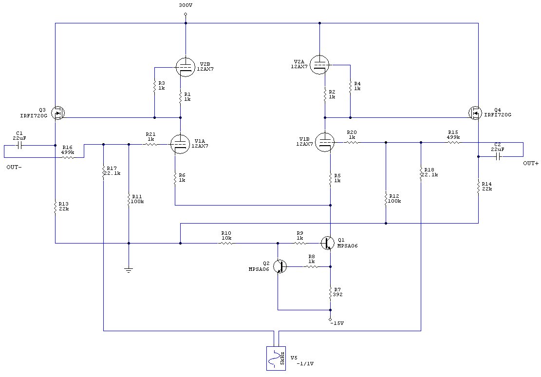

Here's what I'm thinking for the front end, only substitute 6DJ8 and adjust values accordingly:
I think I will double up my intended output stage to 6 pairs each side followers, biased as around 120W dissipation, 26V rails.
small trimpot from both lower cathodes , wiper to CCS - to maintain DC symmetry ;
besides that , bleeder resistors on outer side of output caps

good ideas, and thanks again. It's not really a complete schematic- just a presentation of concept, so keep the ideas coming.
