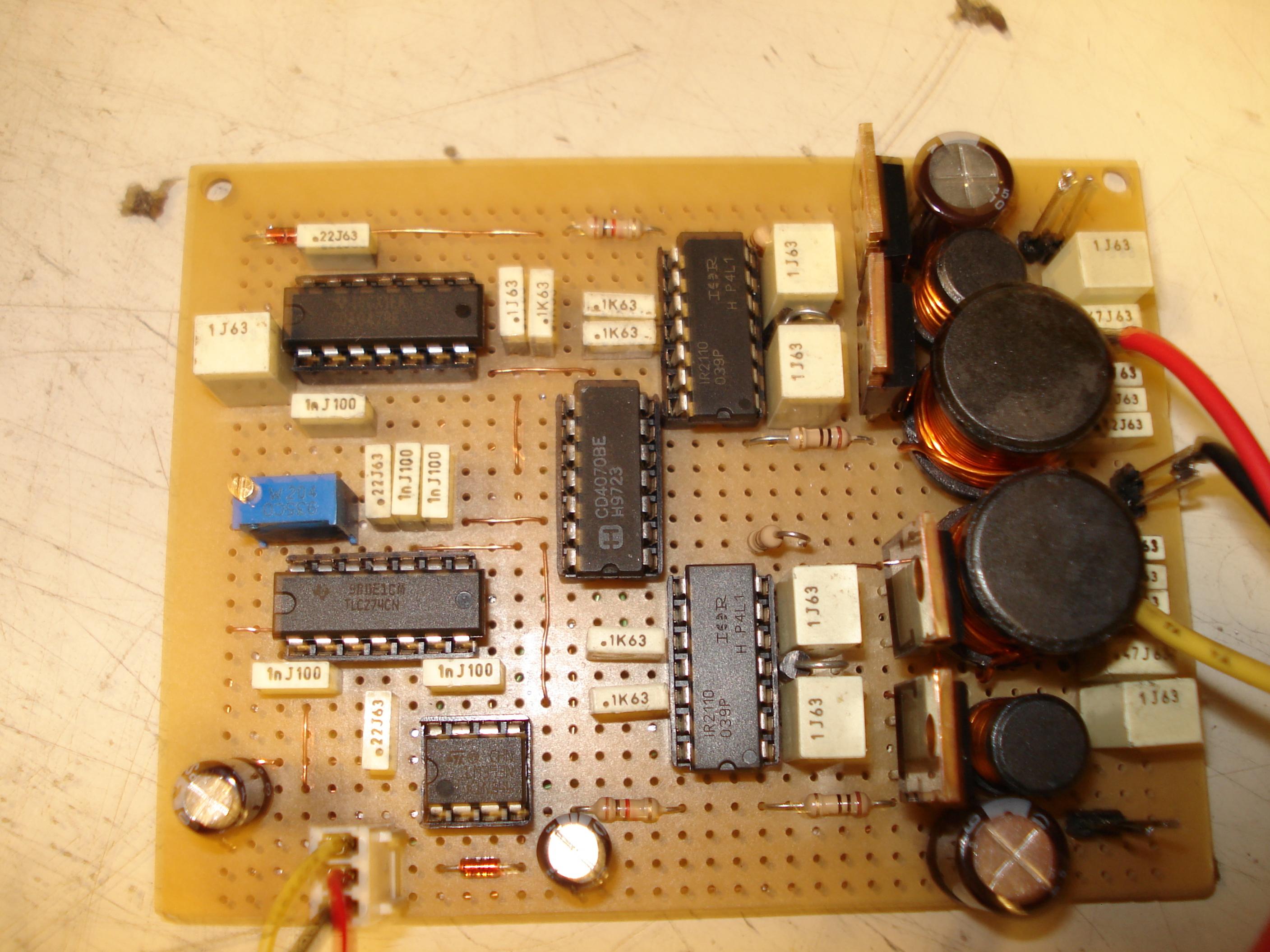

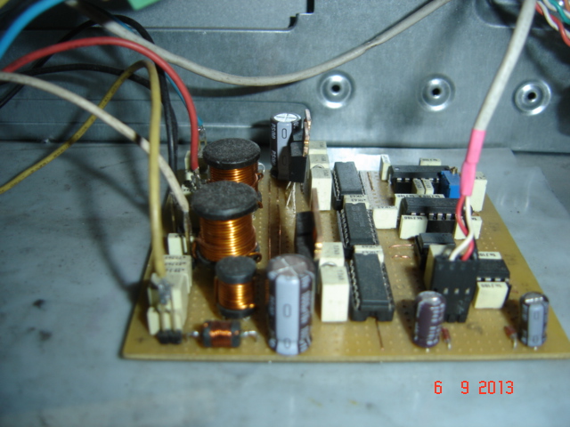

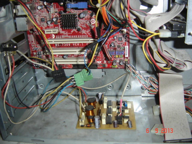

You can include the amp also inside the PC, using the same power supply, depending of the power. I am using a self-designed Class D amp powered from the ATX power supply. Sound isn't the best, internet connection isn't excellent and the 4" speakers aren't the plus ultra, but for listening streaming audios/videos it suffices.
Hmm..
That's 5W per speaker or 2x 5W?
What is the maximum current?
In any case I can use an external power supply, If the PC's power will not fit..
So back to the original problem: isn't there any problem with putting audio system components inside a computer's case?
I really remember reading twice people mentioning noise being generated, either by the amplifier, or by the PC, or both..
The amp has no effect on PC function. The PC noise can get induced in amp input circuits - placing the tiny TPA3116 amp into any shielded enclosure is simple. Proper balanced lines will eliminate the induced noise into input lines.
Always to key is making sure no ground loop within the signal path occurs - either using non-grounded PSU for the amp, or using balanced inputs of the amp.
For 12V PSU and the dirt-cheap quite distorting TPA3116 you may want to try the onboard Intel HDA soundcard directly. When properly connected (balanced) it has rather good params and sounds pretty good (no noise, distortion much below that of TPA3116). It may save you the USB DAC which would need to be shielded in the PC (IMO useless for this setup).

No, the amp will no overload the PC supply as it usually is well overrated, and you will not take thousands of watts from it, ten or twenty watts is of no trouble, I had repaired lots of them in past decades.
Internet connections here in Argentina, like cell phones are trouble per se. All way. All time. The amp doesn't interfere at any way with the LAN connection, as it is very resistant to interferences, provided wiring is properly.

Going back to the topic, the ATX PSU can support efficiently a small amp. My project uses the ±12V rails as a kind of well regulated split power supply. Speakers are humble 4" in a small cabinet, and for listening background music is more than I need. Remember I'm in the job, so not too much volume I want.
Sometimes it captures some noise from the video or HDD, but still, is used for background music only.
I reinforced a bit the -12V line using two bigger diodes in the PSU, originally they were common UF4xxx diodes, and I replace them with 1N5822, 3Amper shottky, and the original cap (470µF 16V) was replaced by a 2200µF 16V, to enhance transient response, as the kind of half bridge PSU's are naturally slow. But in general terms, it performs excellent given the limitations of the service.
Lot of time ago, I was using more or less the same configuration but using TDA2006´s powered also from the ±12V rails, the same good results. But as I wanted to migrate to an experimental class D using parts in stock at job, this was the final layout. The schematic is available, if you want it. And very simple.

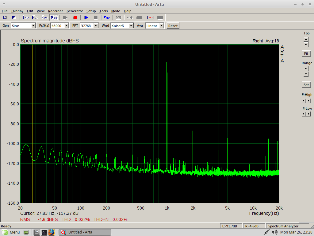

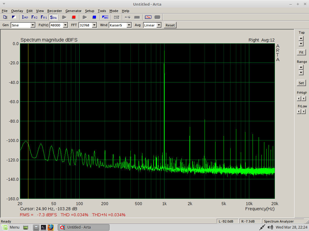

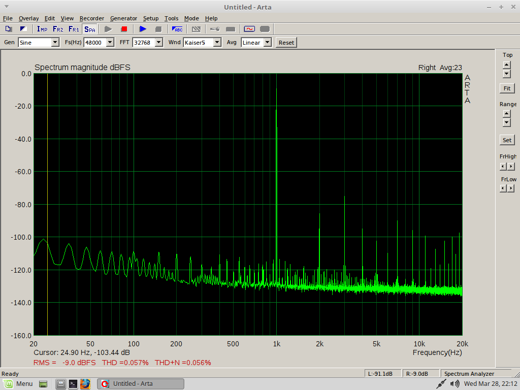

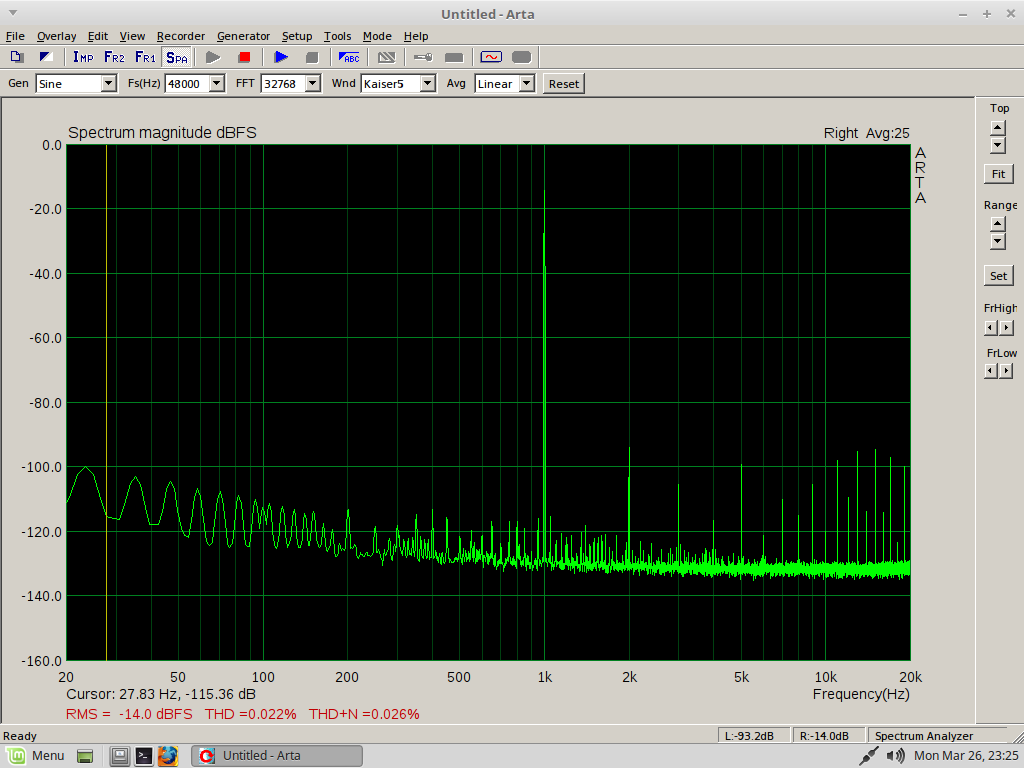

You say an external DAC is unneeded when using the TPA3116 amplifier?
Is it that bad?

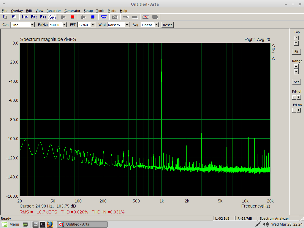

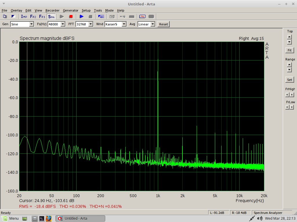

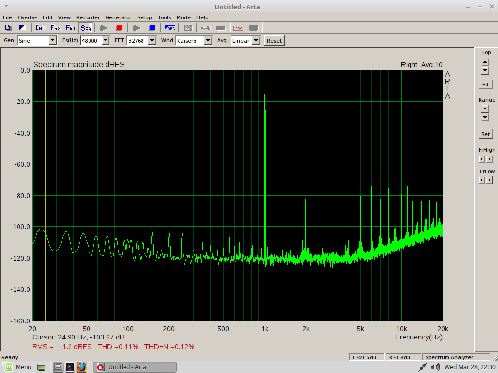

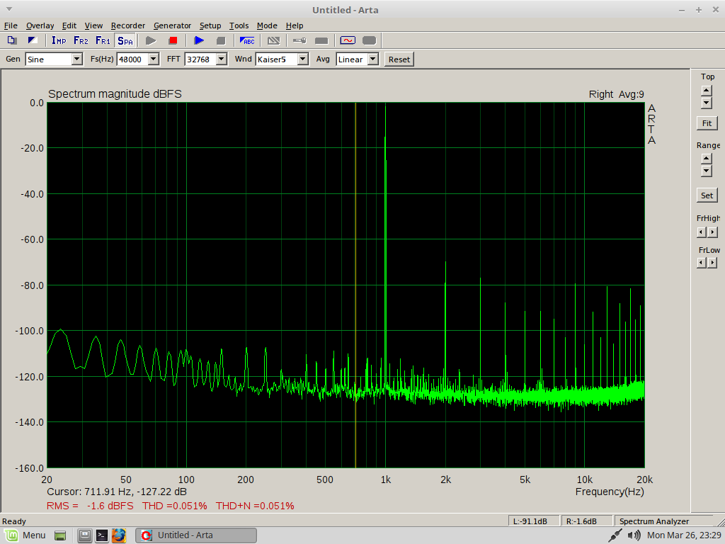

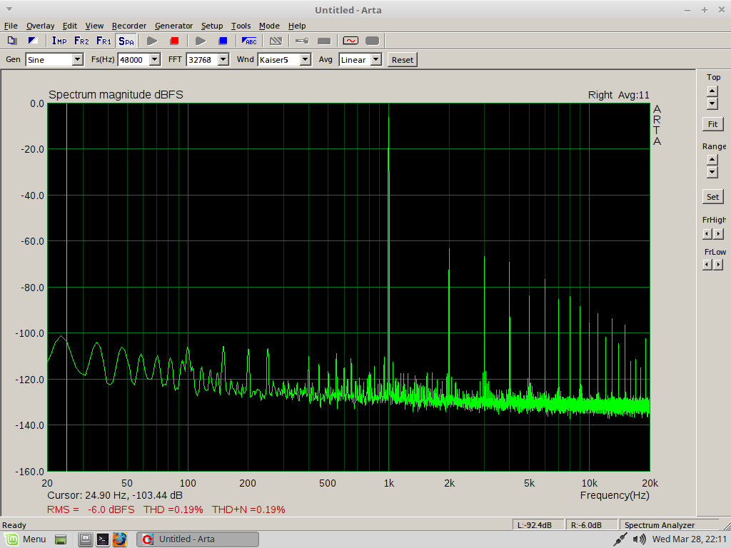

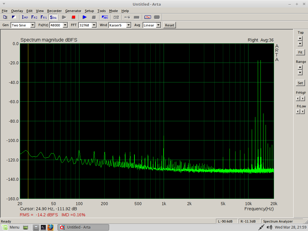

It is great for its price. But the soundcard has way lower distortion than this amp (soundcard < 0.01%, amp 0.03%+). My measurements of TPA3116 with balanced connection to internal soundcard of FS Futro S550 powered by the 19V power adapter of PC are enclosed. Nothing special, IMO no reason to invest into a USB DAC. But you can always try and if you do not like it, get the USB DAC afterwards. You will need the balanced connection anyway if the DAC is powered/connected to the PC.

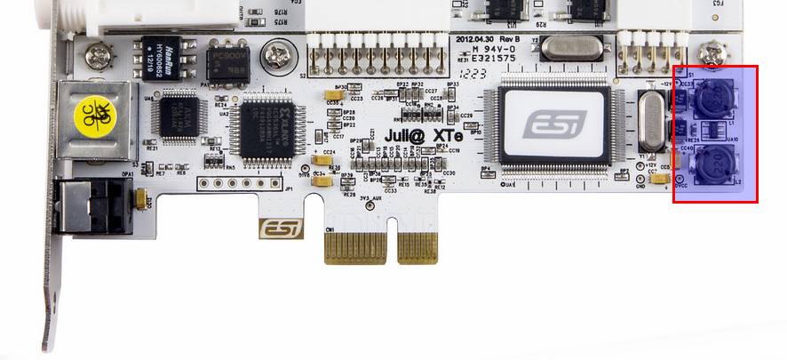

-12V was part of PCI connector, IMO presumably for soundcards. Today PCI-e soundcards must deploy a DC-DC convertor if they want their analog stage powered symmetrically (e.g. Juli@ XTe based on the original PCI Juli@)
