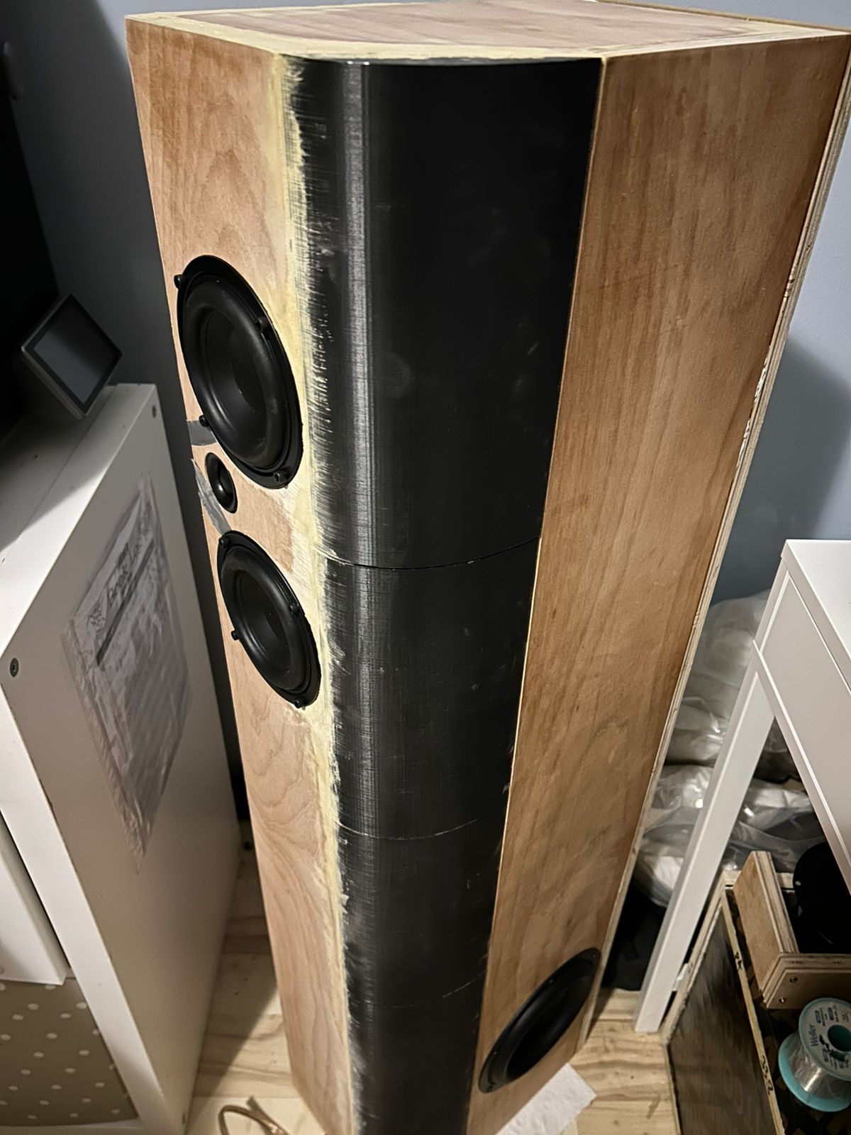

Brief backstory: after a school project, my family had a set of Dayton Audio TCP115-8 mid woofers laying around, so I proposed to my two older sons that we make loudspeakers. We have turned this process into a design competition between the two of them, with each making a pair of loudspeakers, with my support on both projects. Both have selected floor standing 3-way designs. For one of the pairs, we have now reached the stage of a finalized enclosure and frequency response measurements to prepare the crossover design. Pictures of the design, current build, and testing setup are attached.

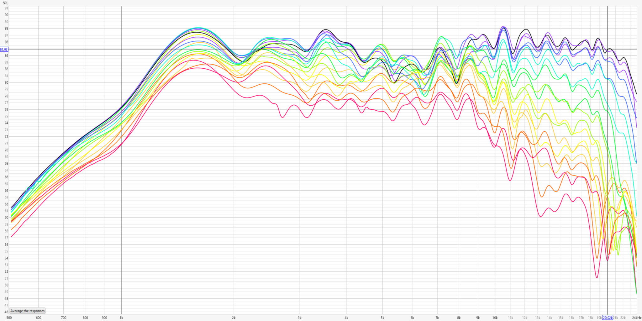

Now, the problem. In our first round of frequency response measurements, we used the following setup:
  • Lenovo Legion Pro 7i 16IRX8H laptop
  • miniDSP UMIK-1 USB microphone, plugged directly to laptop via USB, with calibration file
  • REW V5.31 software, Java drivers, output via laptop Realtek headphone output
  • Simple Pyle PTA62BT amplifier, using Aux input from laptop headphone output

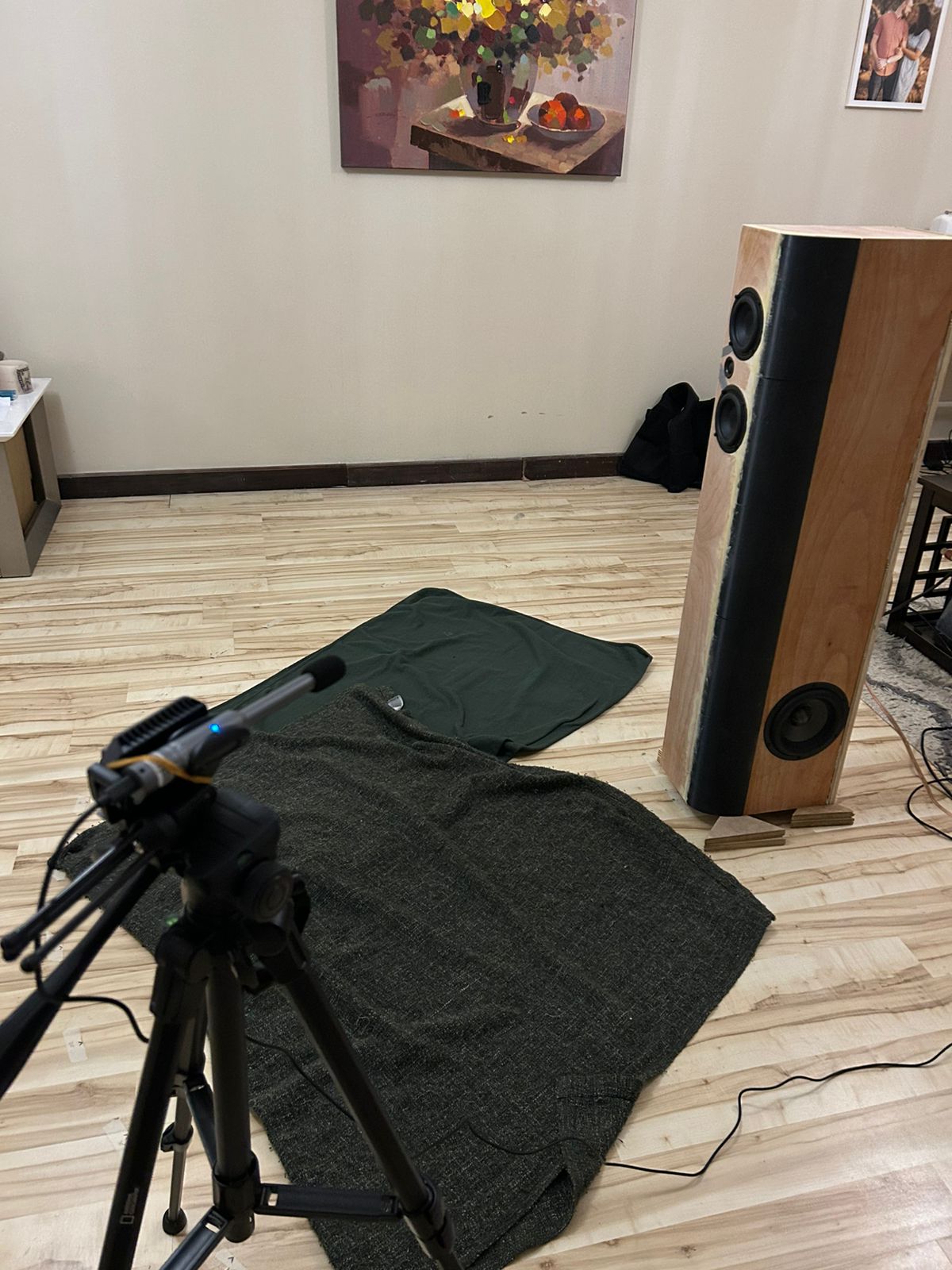

  • Mic 1.2m from dome of tweeter, vertically on-axis with tweeter, 3ms gate, 1/24 smoothing, measurements every 10 degrees from -90 deg to +90 deg
  • Tweeter being tested in this speaker is Dayton Audio ND20FB-4

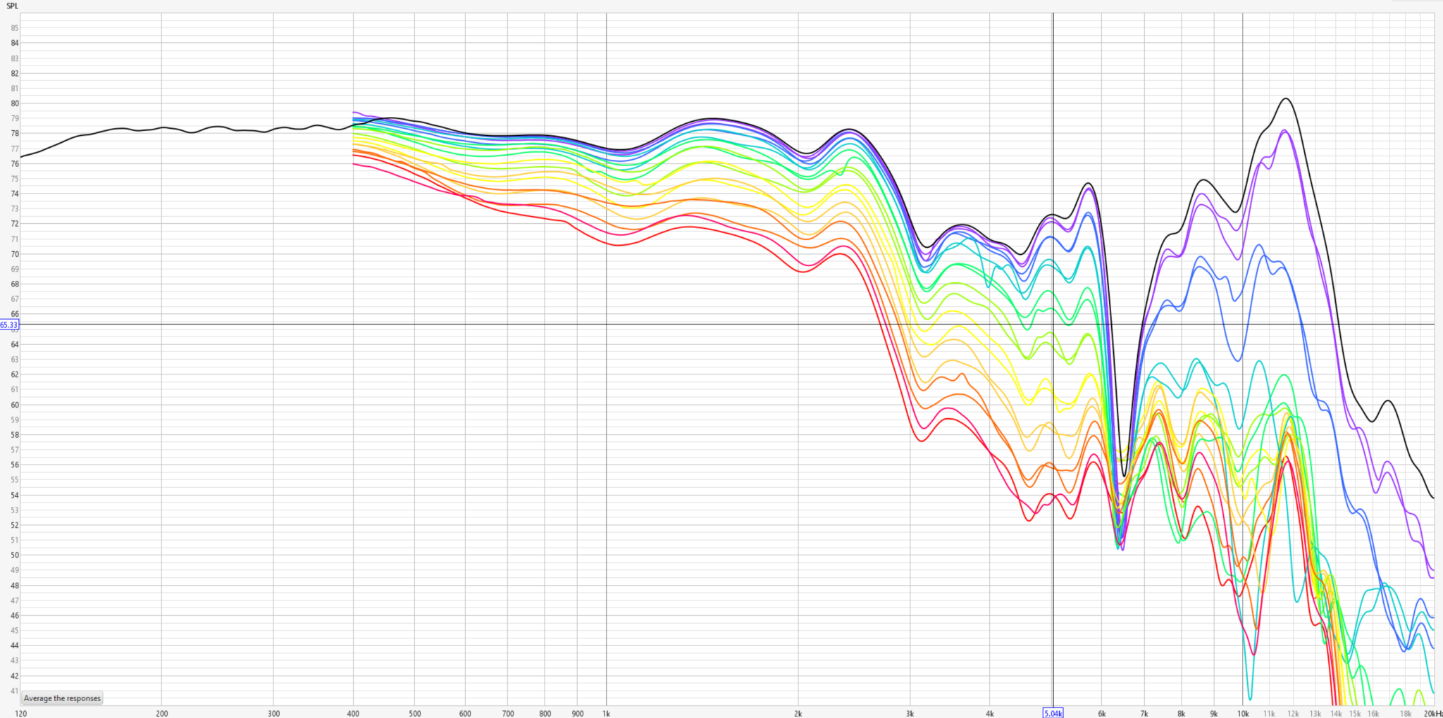

We had issues getting SPLs high enough, even with PC audio output at 100% and the amplifier gain set nearly to maximum. During each sweep REW gave a warning about poor signal to noise ratio. However, we did get all the data collected, and the resultant curves for the tweeter response looked believable (see below). (Please note that actual measured SPL in this series of tests was lower, but has been adjusted upward in this chart to match levels of other test we performed later.)

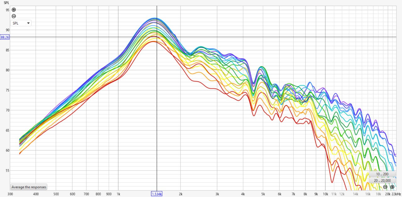

Later on, while considering how to improve power output for the less sensitive mids and woofer, I realized we have a Focusrite Scarlett 2i2 audio interface, which I probably should have been using from the beginning. I tested it during our measurement sessions for the mids and woofer, and was able to get much higher output levels, and reasonable measurements from 20Hz - 2kHz. Satisfied that this was the better setup, we went back to re-run the tests on the tweeter. The setup was now like this:
  • REW V5.31 software, both Java and ASIO drivers tested for the output
  • Simple Pyle PTA62BT amplifier, both headphone and line outs tested from Scarlett

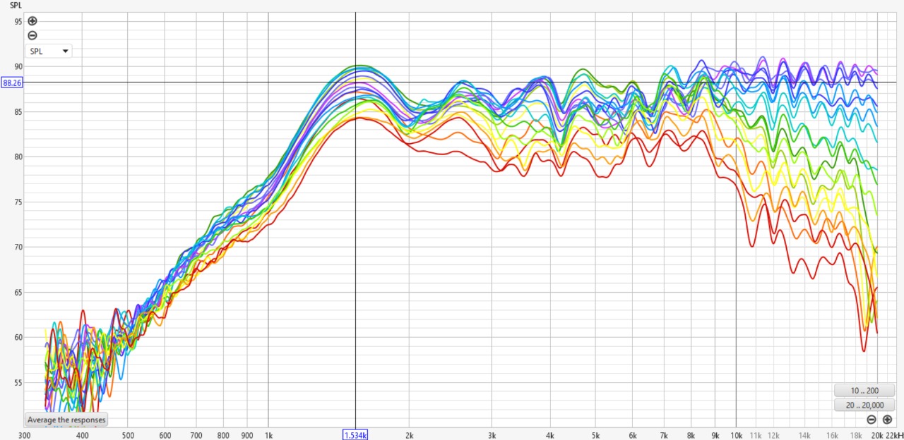

We were surprised to see the response curve was totally different and quite bad looking (see below).
We had hoped that the audio interface would give us higher-quality information, but I sincerely hope this measurement is not the more accurate of the two! As mentioned above, we tried line out and headphone out from the Scarlett, we tried Java drivers and ASIO drivers. We tried 80dB, 86dB, and 92dB peak output. All measurements with the Scarlett with all scenarios just mentioned gave the same results with the steady and dramatic high-end roll-off.
Apologies for the long read. If you are still with me at this point, the question I have is: what is wrong with either or both of my setups that would be introducing error? Is one of these more likely than the other to be the "most correct" or "least inaccurate" set of data? We will be loading the measurements into VituixCAD for crossover design work in the next step of our design and want the best data we can manage to gather with the equipment we have available.

It almost looks like the second (lower) plot included the effect of a treble tone control turned all the way down, or a lowpass filter was enabled. For example, if the crossover was wired wrong and the tweeter is getting the woofer filter.
If the crossover is used, bypass it. Otherwise, look for some software filter or the amp tone control as the culprit.
Reactions: raymondj
Give or take a bit, the difference in the data is approx. 5-6db drop per octave in the second measurement.
I dont know what the calibration data file looks like but has it been applied? I wouldn't expect a Cal file to be that drastic but its worth checking.
Also worth a check is the type of stimulus used for the first and second measurements, where they the same type. I am not familiar with the software so had to ask. Maybe as a sanity check apply the stim to the Sound card loop and verify you have a nice flat line when measured.

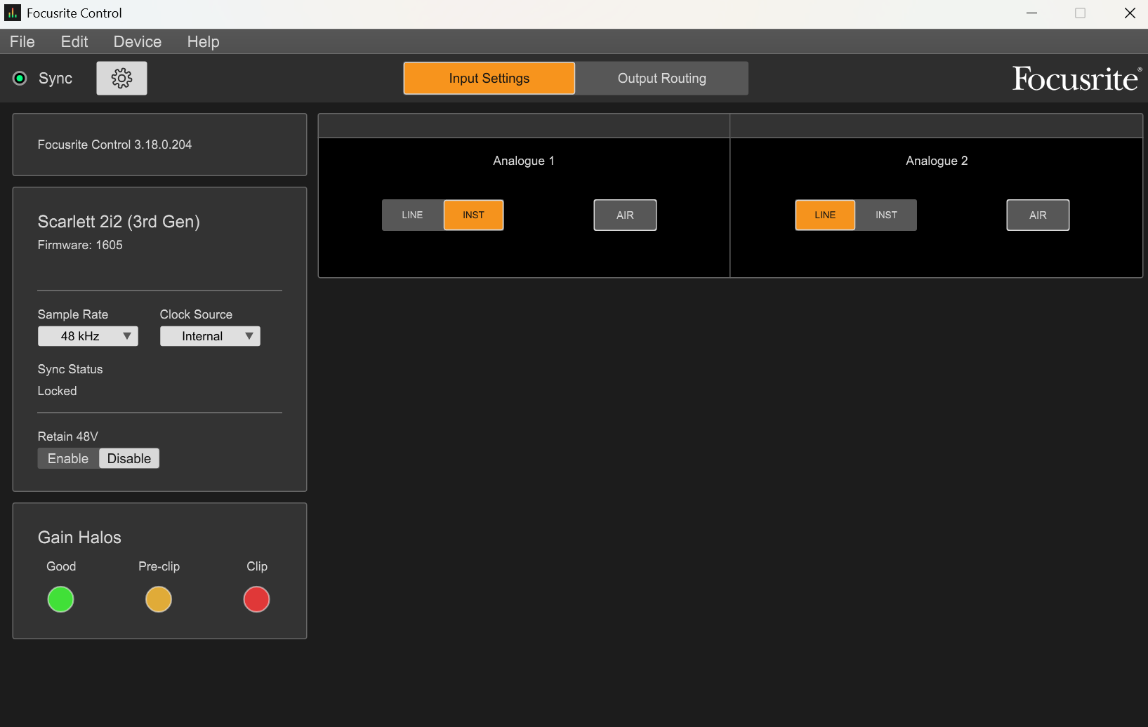

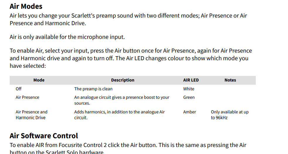

Thank you all for your inputs. Your observations that the high frequency attenuation looks like a steady slope caused by some kind of EQ or filter has me on the right path I think. I can confirm the Focusrite doesn't have any tone controls, physically, or in the software (screenshot of the settings page of the Focusrite software below).

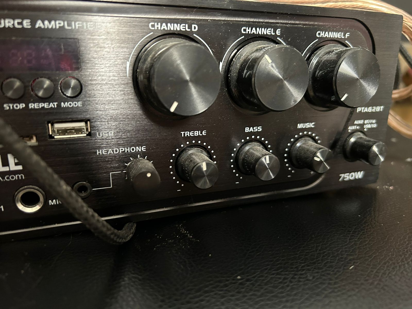

However, I realized for the first time that the amp I am using does have tone controls. 🤦‍♂️ Confusingly, the tone controls are both at 12 o'clock, indicating they theoretically shouldn't be applying any filter. (According to the manual, the mysteriously labeled "Music" knob is actually master volume, not a tone control.)
One setup detail that escaped my notice in my initial post is that I was using a TRS cable in my Focusrite Scarlett setup, into the Mic inputs on the front panel of the amp. When I used the laptop headphone output, I was using a 1/8" to RCA into the Aux input of the amp. So my working theory for now is that the mic inputs of the amp are affecting the response. I have ordered a TRS>RCA cable so I can try running the Scarlett to the Aux input to see if that solves the issue. I'll report back if solved.

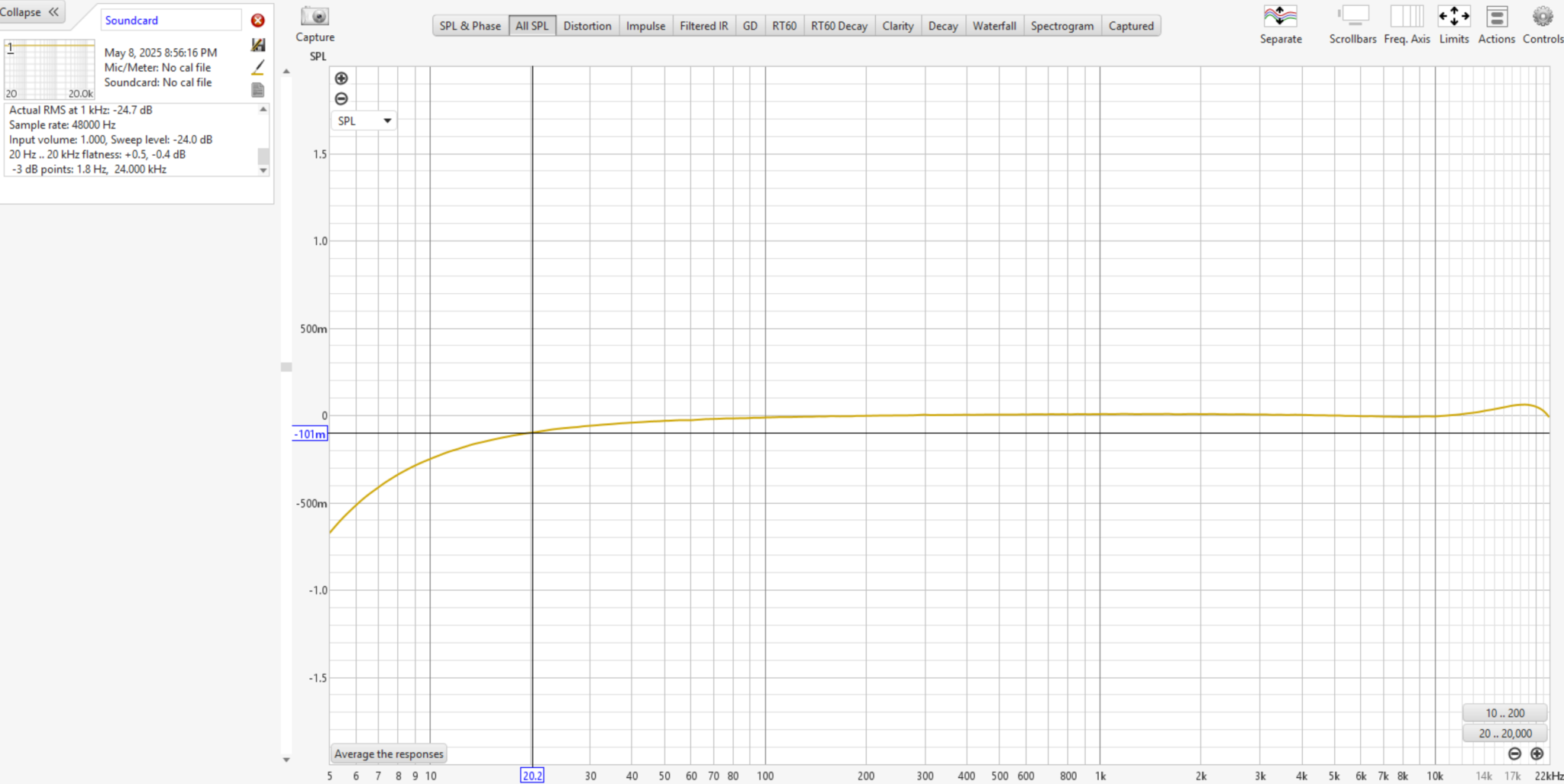

Following advice here, and with the guide built into REW, I was able to finally calibrate the Focusrite (loopback with TRS cable from L line out to input 1). Thankfully, that calibration exercise did indicate that the device is pretty flat (0.1dB down at 20Hz and 0.05dB up at 19kHz):
This left the amplifier mic input section as the culprit. The behavior was unexpected because none of the physical controls on the amp indicating any filters were being applied, and the manual made no mention of any filters on the mic inputs, yet you all saw quite clearly in the measurements that a filter was involved:
There is in fact a 6dB/octave low pass starting at about 3kHz in the tweeter measurements. And, even though I didn't post my woofer measurements in my initial post, there was also a 12dB/octave high pass apparent in that data starting at around 80Hz.
So, I bought a new cable that enabled me to run the line out of the Focusrite into the aux input of the amplifier. This seemed to resolve the issue I was having! Apparently, this silly amp does have an undisclosed high and low shelf filter on the mic input.

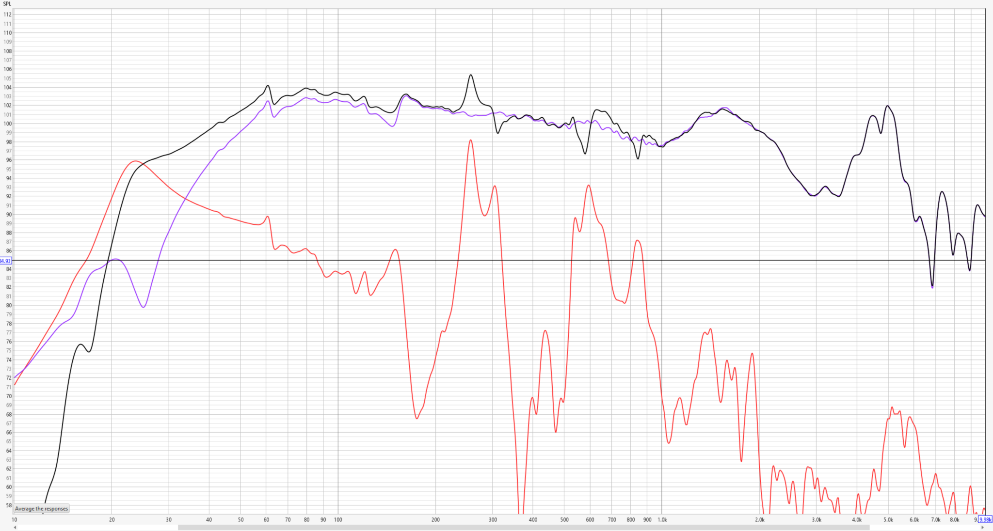

I re-ran all my measurements now and feel satisfied enough with the outcome that I will move to design in VituixCAD with this data.
Tweeter:
Mids (near field measurement of one driver cone merged to on-axis far field measurement at 480Hz, BSC applied):
Woofer (summation of cone and port, port reduced by 8dB, tuning looks 4Hz lower than intended):
