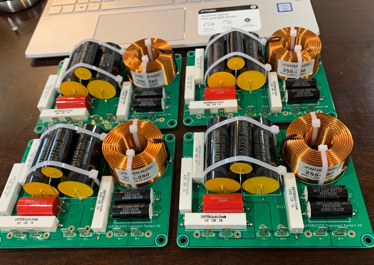

XO Design (PCBs avail):
656203d1515700364-10f-8424-rs225-8-fast-ref-monitor-xrk971-10f-rs225-fast-schematic-jpg
809239d1579155037-10f-rs225-fast-speaker-xo-pcb-gb-10f-fast-xo-pcb-built-03-jpg

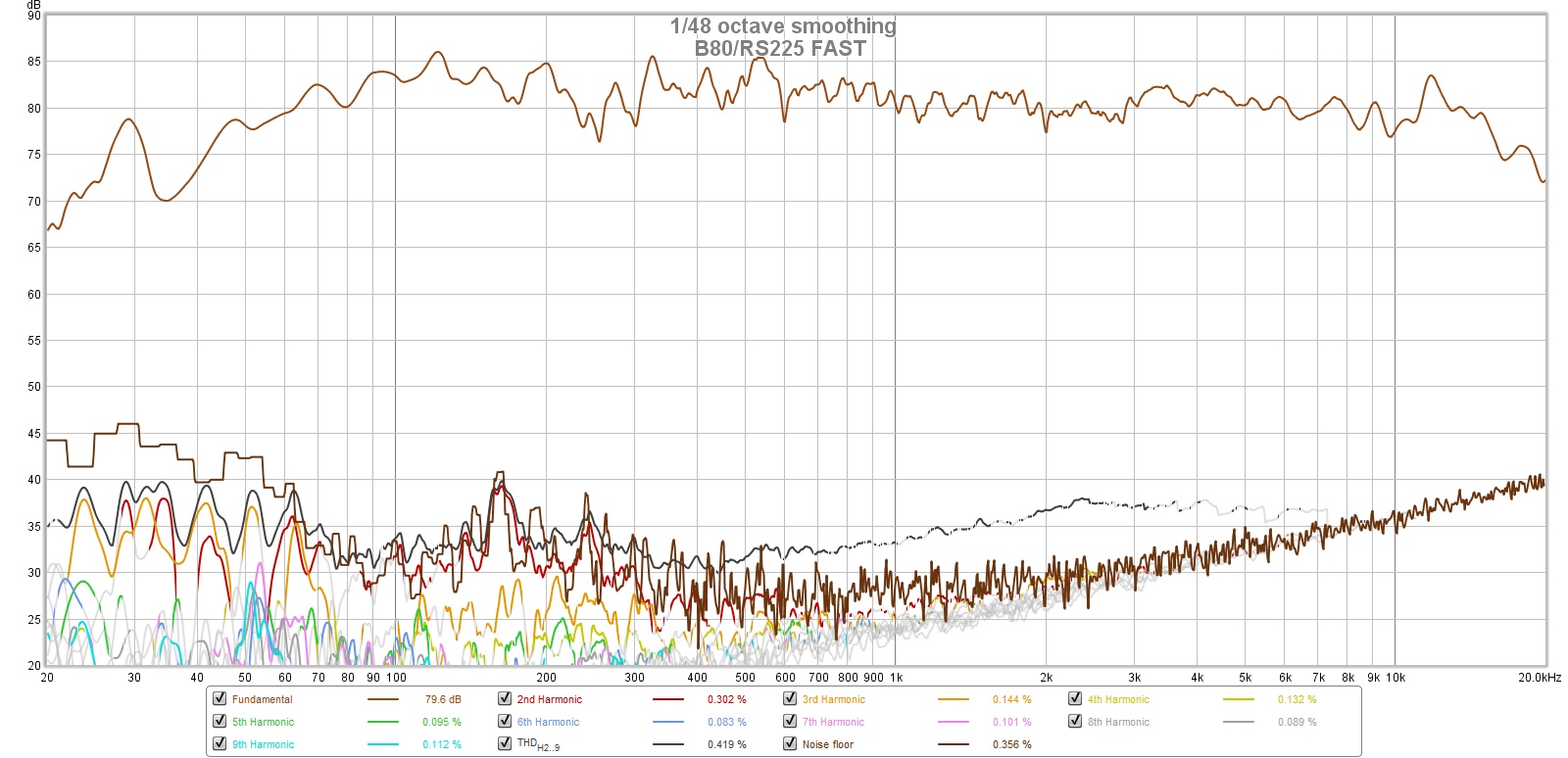

Frequency and distortion at about 79dB output at 1m:
828554d1585427034-10f-8424-rs225-8-fast-waw-ref-monitor-b80-rs225-fast-freq-distortion-mid-axis-jpg

Hi Bsp,
No EQ or DSP, this is a passive 1st order transient perfect crossover developed over several years and a lot of measurement and listening to acheive a "monitor" like flat response. The XO however, appears quite simple and looks like this:
Here is what the XO's look like in practice:
831419d1586241879-10f-8424-rs225-8-fast-waw-ref-monitor-tested-xo-tl-jpg

Coupled with a TL for bass extension which produces:
