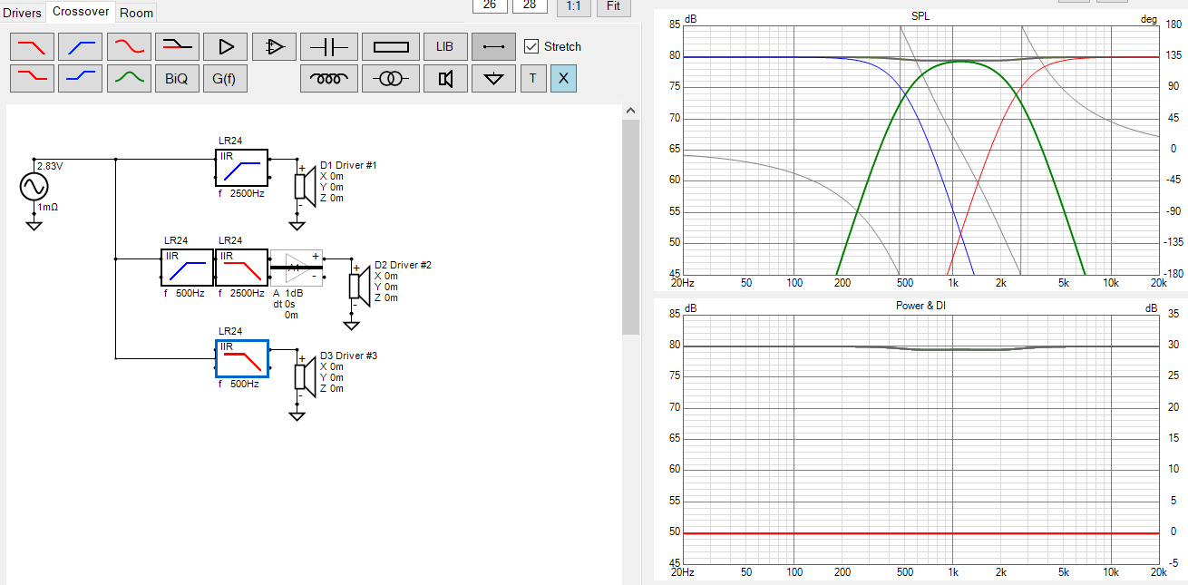

Here is a 4th order version of the same, have a look at the difference in the tweeter level at 1K. In the 4th order it is 30 odd dB down, in the 2nd order only about 16dB down. When you choose low slope crossover there is much more asked of the drivers far away from the crossover point and that needs to be considered when choosing drivers intending to use that topology. For low order woofer and mid I would suggest looking at the Scanspeak Discovery drivers as they are very well behaved for a really wide bandwidth. This makes designing a crossover for them much simpler and cheaper 🙂

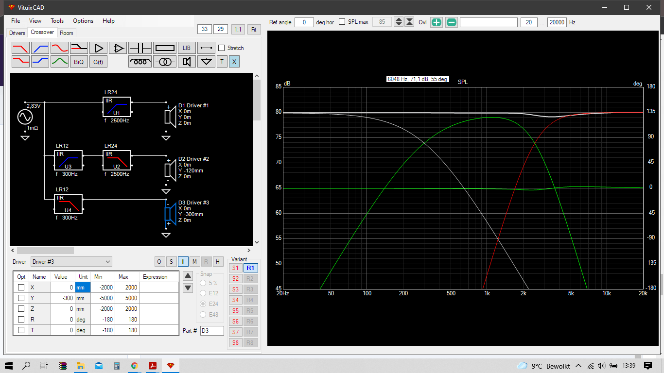

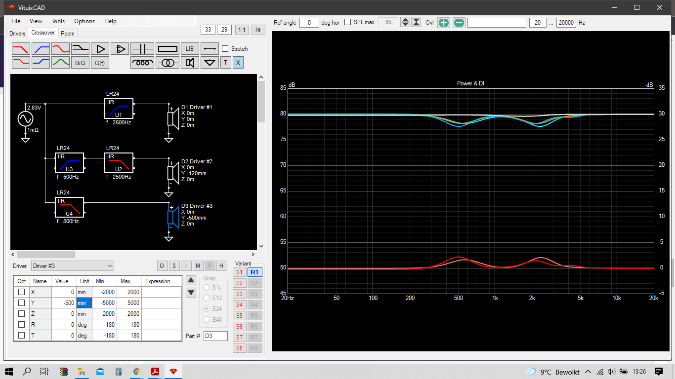

When I add some Y offset of the drivers, -120mm for the mid, -400 for the woofer, the dip is almost totally gone. It is the same for LR2 or LR4

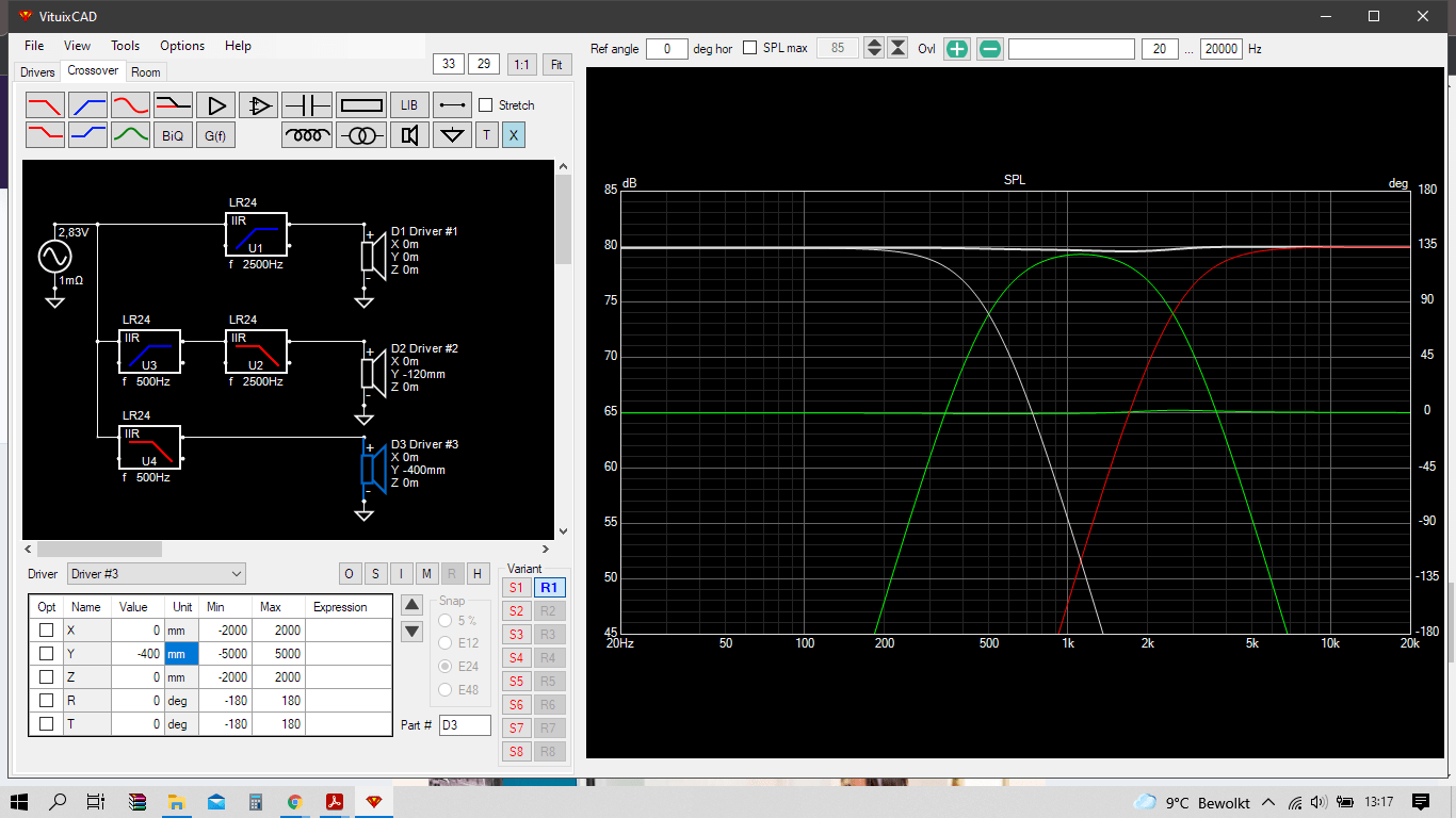

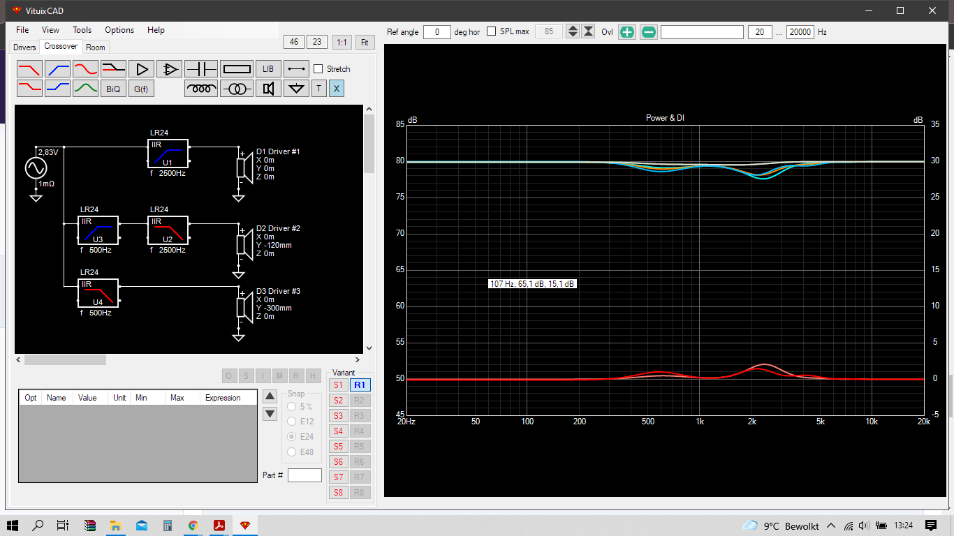

When woofer is closer to the mids the dip on axis gets bigger (relative as we speak of 1db when y value is the same. But gives a much smoother DI.
Here woofer with Y -300mm (closest possible with 4"mid and 8" woofer)
and here with woofer @ -500mm
So it is important to keep the drivers as close as possible? Even the woofer?

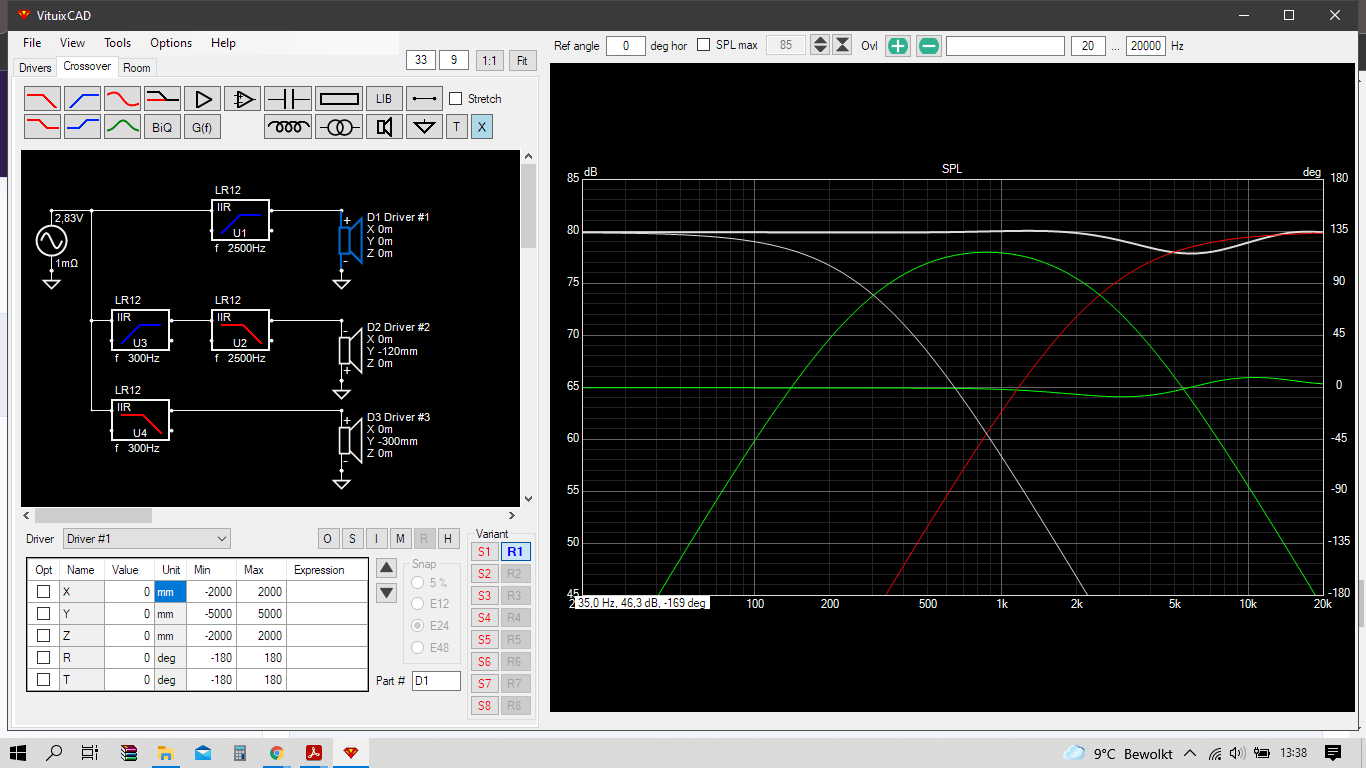

I made some sims with LR2 and LR4 for mid/tweeter (ideal driver not adapted to the baffle) and outcome is very different. Dig dip with LR2 from 3k to 10k
only small dip at 3-4k with LR4
In those simulations the drivers have no directivity and the directivity of the cabinet is not included so it tells you very little. You can try and make simulations in Vituixcad to include driver and baffle diffraction to get a better idea of the way the woofer and mid will react to distance. Z depth matters as well but can only be estimated without an actual measurement.
It is very hard to say what is the best positioning for the drivers as it depends on so many factors, putting them close together might work or it might be the worst position.
