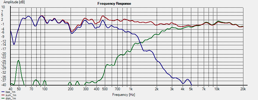

It isn't necessarily. By for example a 2nd order crossover the tweeter and woofer normally adds a fair amount to the output at frequencies primarily handled by the mid. This is an exampleHaving a mid with lower sensitivity then the wof is a big problem so that that should be avoided - if one is planning for a passive filter.
The summed response:
(the 50 Hz in the tweeter response is my mic preamp - huge rookie mistake in power supply design)
By high order crossovers the mid needs higher sensitivity. So there you may have a point.

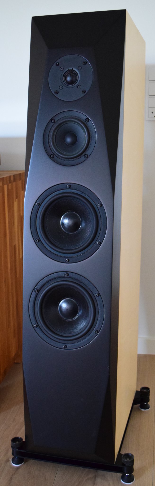

Look like a very interesting design. All SB drivers?If you have the SB12 in mind, consider the woofer with foam surround instead of the mid. The foam version is very responsive in the midrange, whereas the mid version has a high loss rubber surround as far as I recall. If you wan't to cross it low you'll also have the extra stroke from the woofer, in case you'll have a party.
I've used the foam version in these. Highly recommended.

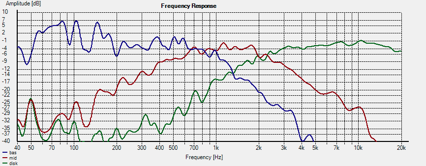

I had same in my SIMs, using low order filters. Even had to bring the SB12 MID down a bit.It isn't necessarily. By for example a 2nd order crossover the tweeter and woofer normally adds a fair amount to the output at frequencies primarily handled by the mid. This is an example
