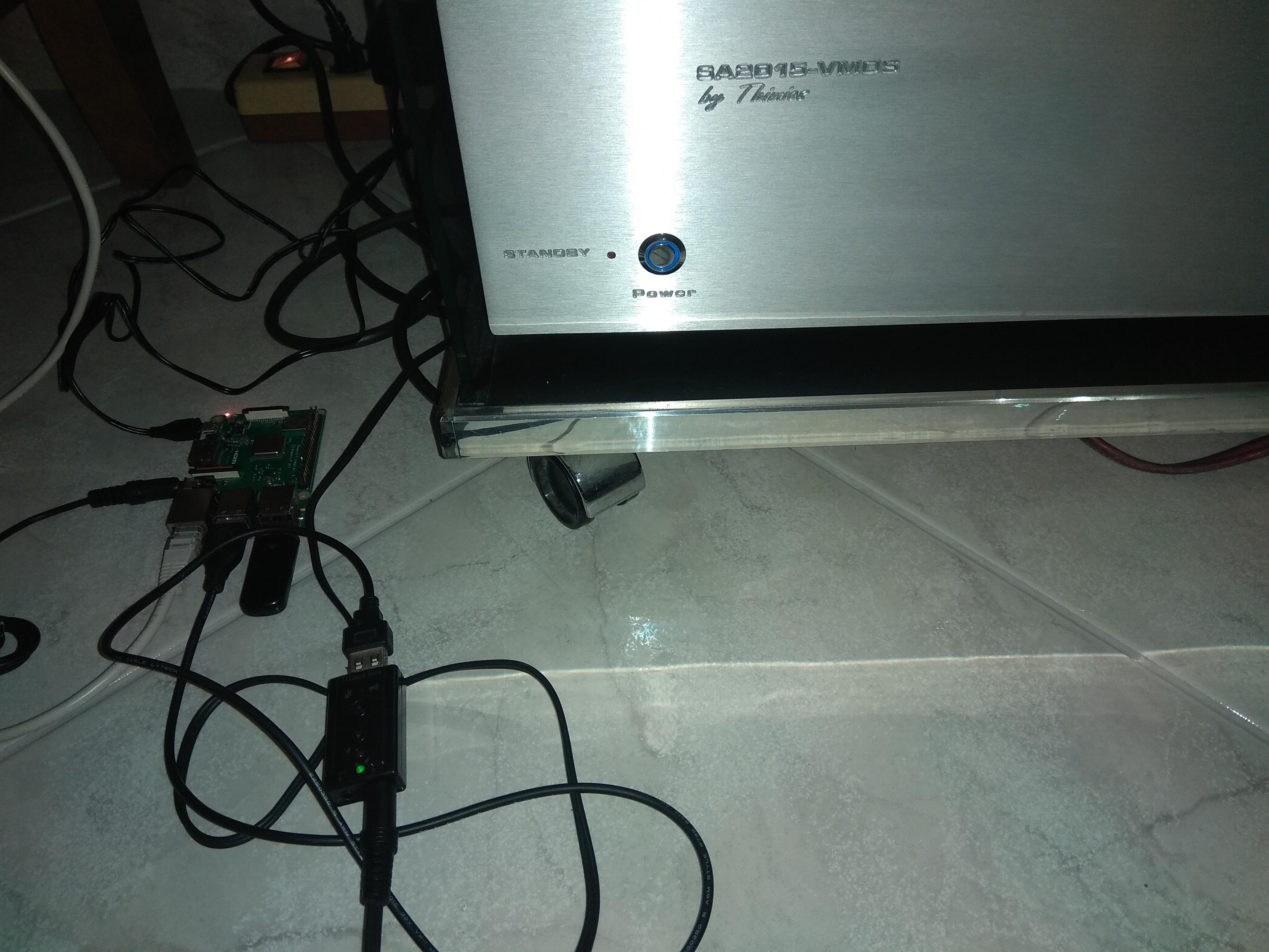

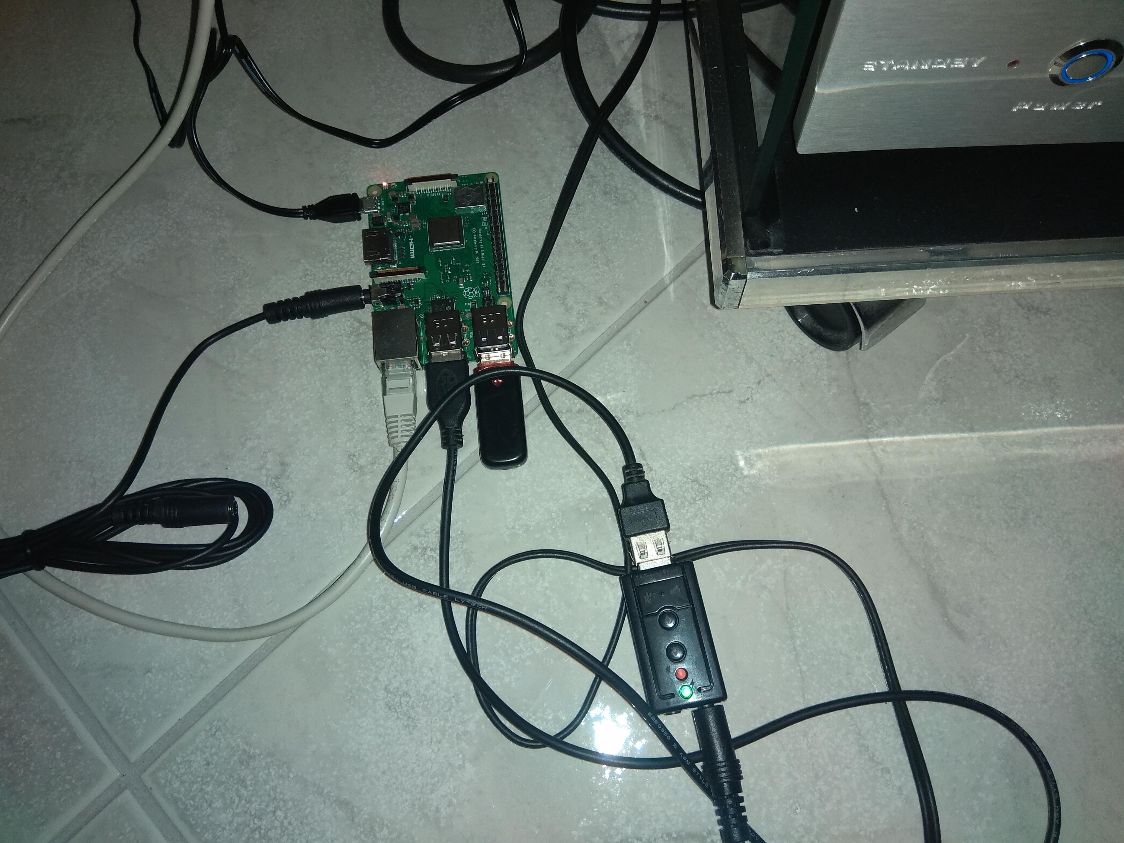

Thanks to donVK this first setup is working now🙂
A 5€ USB dac used because sound from the headphone jack is noisy.
Here together with my SA2015 by stx.
Thanks again Toni! 🙂

You are welcome!
The phone jack of raspberry pi is really very noisy. The simple USB DAC is mostly powered by a Cmedia chipset ~ -70dB THD+N
To get the most out of your Raspi you better get a HifiBerry DAC ...
BR, Toni

Hi Toni, yes i know but is my first step in Pi.
Is the HAS the best choisse or a quality usb card?
I want to keep the possibility for a rotary switch for volume control and a cheap 2X lcd.
I want a stand alone player, no internet, maybe inside an amplifier.
A usb sound card also keep the posibillity for an Asus tinker latter.😉
Using a raspberry pi compatible HAT which uses the PCM5122 you can control volume fully digital. AFAIK a hifiberry DAC+ or DAC+ pro uses this chip. I have developed a piece of software to control the volume using a rotary switch. Its easy to add infrared control...
BR, Toni
