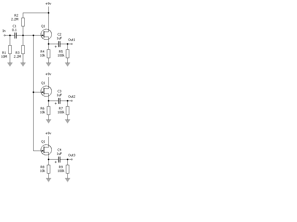

Hi! I wonder which jfet should be more suitable as a source follower (therefore unity gain) in the signal splitter on the drawing in attachment? I'm using at the moment J201 but have never tried any other type (like BF245 or 2SK130, ......). I've read somewhere that sonically it doesn't really matter which one I use as a source follower, or does it?
It also doesn't matter the output current because I can always put in parallel (see attachment) the outputs and get more current in case needed.
I guess they have to matched to get the best result. Is there a special procedure to do the matching or it's just a matter of comparing the resistance between the gain, drain and source?

You wont need to match FETs for any application like this (proper matching involves plotting and comparing the Drain current vs Gate voltage). Nothing to be gained (imo) by using other types.
Biggest failings of the circuit are the 10k resistive source load and the limited output drive ability that brings. Using 9 volts is a big limitation too.
There are several things you've not taken into consideration (which DOES impact which FET you decide to employ)
[1] Vgs(off) voltage
[2] Vgs(nom) voltage
These are related, of course. The J310 (20 mS transconductance), as a Vgs(off) typically around 5 volts, and in operation with say 5 ma as the design point, 3 volts for Vgs(nom).
So, you need to work that backward: E = I R ... R = E / I, where E = 3.0 volts and I = 5 ma. R = 600 ohms ... this would be the "R" for the source, replacing the 10K you have listed.
OK, so its about 3 volts. If you want the maximum range (which kind of obviously is set at the half-point of V+), then you need to SUBTRACT that 3 volts from 1/2 V+, to get the operating bias of the gate. So, say V+ = 18V. 1/2V+ = 9V. 9V - 3V = 6V. What gate bias resistor-voltage-divider pair gives that from 18V? 6V/18V = 1/3. R2 = 2M, R3 = 1M... Now we're talking.
Lets look at that source load resistor again. DeltaV between source and ground is (designed to be) 1/2V+ = 9V. we again are searching for 5 ma of current flow ... E = IR, R = E/I = 9/5ma = 1,800 ohms. Cool! Same basic design point, with a gate bias of 6 volts.
Thus the "napkin calculation" of operating points. This will result in better load driving ability, too. The Thevenin equivalent resistance (input impedance) of the gate is ... (2 x 1)/(2 + 1) = 660 kOhm ... which is nice and high. The R1 of 10,000K might depress that another 10% [well, actually (0.66 * 10)/(0.66 + 10) = 0.62M] but still, quite high input impedance.
I too recommend 18V supplies for this. Conveniently, this could be a pair of conventional square-can 9v batteries.
PS: I wouldn't set the design point much below 2ma for the J309/J310 family ... for reasons of linearity and getting into the steep part of the transconductance curve. FETs have their sweet spot, "manufactured in" so to speak. At $0.30 apiece (Mouser), they're an awfully good deal. I've used the J310 series VERY successfully in creating built-in preamps in acoustic-magnetic pickup Irish harps. Very nice sound - sweet, clear, without hollowness or boominess.
That should do you. The rest of the circuit - is just fine.
GoatGuy

So you suggest to use the 18V as power source and then the 10k resistor would be ok there?
No... maybe you need to read what I wrote, again.
RECOMMENDATIONS:
Supply: 18 volts
R4, R6, R8: 1.8K ohms
R2: 2.2 megohms
R3: 1.2 megohms
or if you prefer
R1: 10 meg
R2: 4.7 meg
R3: 2.2 meg
for input impedance of (1/(1/10+1/4.7+1/2.2)) = 1.3 meg
THESE values are tuned for the J310, for 18 volt supply, to allow maximum input levels of ∓ 7.0 volts, peak-to-peak (without appreciable distortion). Moreover, for normal "line level" input (from 0.6V to about 2.0V) there is virtually no distortion, period.
Got it? RE-READ what I originally wrote, and please try to understand the math a bit. IF... you don't, and want help understanding electronic math, I may have time to give you some pointers. But until you ask, I'm assuming you either know Ohm's law, Thevenin's equivalences, what transconductance is, and the basic operation of an FET.

A great answer from GG for you there...
and what I would suggest you do is write down your own specifications. What sort of load will each output drive ? Is it battery powered ? that's important, a couple of milliamps three times over will soon discharge 9 volt batteries if it gets a lot of use.
If the load impedance were 10K then you might sqeeze around 4 volts RMS output into 10K running 15 volt supplies with the fet running at around 2ma. Although we think of this as a buffer, the output is around 1db down in amplitude compared to the input.

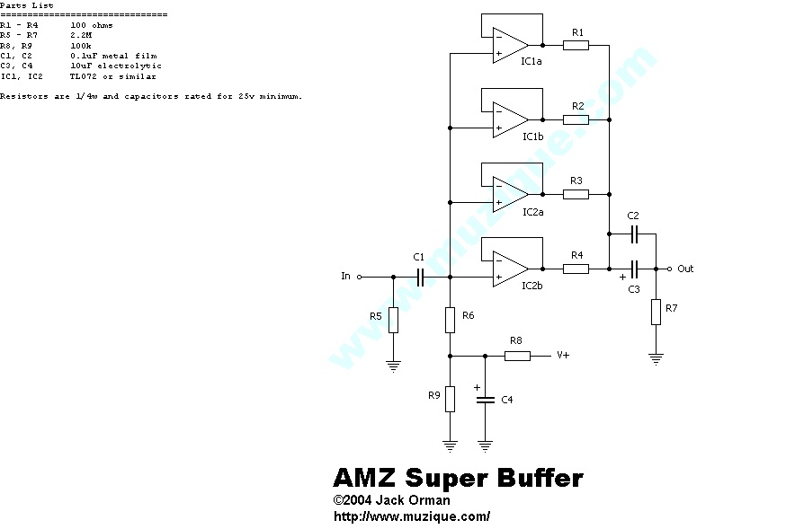

If you went down the other route of using opamps then you may well lose that added "musicality". Technically, the opamp would be superior in that it would have much better dive ability and the output would not be affected by loading (within the opamp limits).

@Mooly: correct, opamps were an option as well...there's even almost the same circuit using TL072, but I somehow prefer Jfets... I can post also the schematics with opamps if anybody wants?

So that's placing opamps in parallel to get even more drive ability. Its a valid technique if you really that much drive ability.
You could also use a single quad opamp (TL074 etc) and have each of the three opamps as an isolated feed, still with far better drive ability than the FET. With opamps there are many possibilities.
