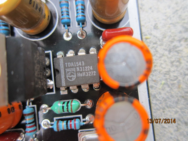

This is the second batch of TDA 1543 purchased from aliexpress.
It is working as expected
Do you notice the white sheen on the entire chip surface? its possible that this was another IC and has been remarked. I don't see much sense in remarking a TDA1543 so its probably something else which is functionally the same as one.
It is something that I am trying to avoid buying.
Also, notice how the TDA1543 string of text begins closer to the left hand side of the Philips logo instead of to the far right of the Philips logo like it does on all of mine except for the TDA1311A. Not all Chinese knockoffs begin like this but a LOT of them do as far as I've seen so far.
Would you please re photograph that in a different light? A warmer light? I would like to see it in a different light so I can compare it to mine.
Thank You.

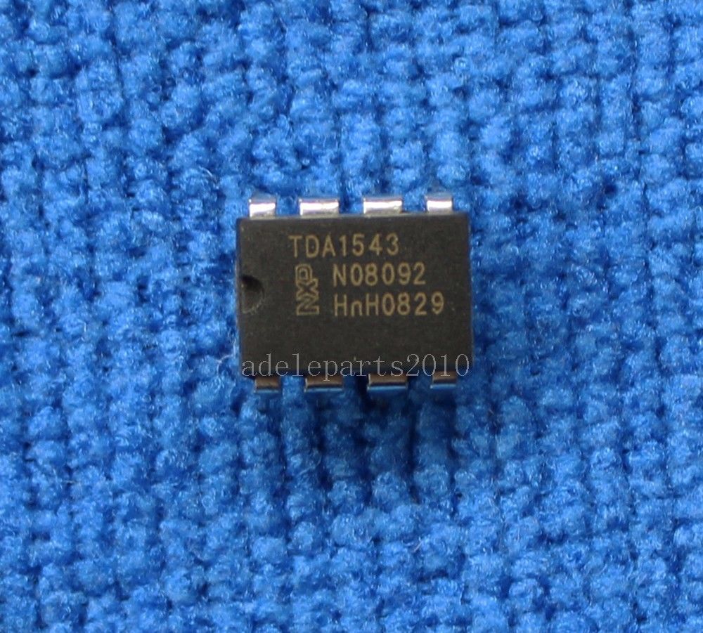

I have found the real one
3.55 euro
Yes please do share the location of the real one.
The chip above sound very nice .
It cost about US 1 per piece with shipping and there is not much money to profit by repainting over another chip.

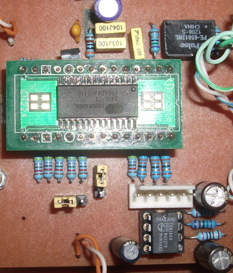

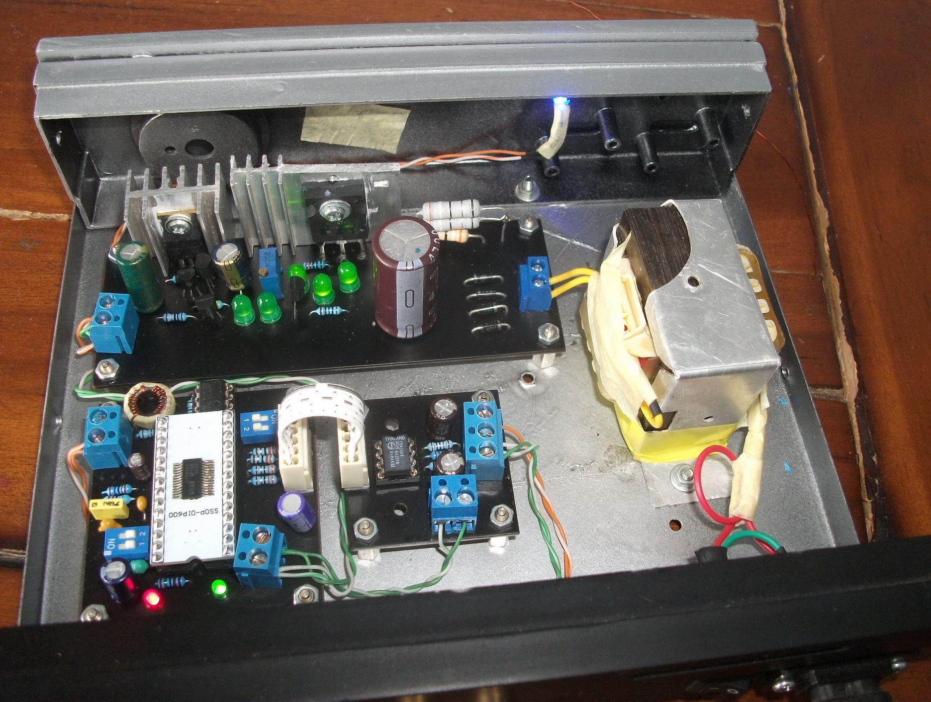

I'm sitting here in the living room listening to Jazz Digital radio over my DVB-T box and I'm using one of the "questionable" TDA1543 IC's which I purchased from Greece a few weeks ago. it sounds very very clear and not harsh and no upper frequency distortion to speak of.
http://www.abc.net.au/jazz/
To listen in click here: http://www.abc.net.au/radio/player/beta/#live/jazz
Theres also another station called Double J.
I can't fathom this ever being a fake knockoff from China.
I'm using my Anarchist DAC.
Had a few problems with the routing of I2S lines and a lack of an earth to the chassis but I got that sorted out this afternoon.
