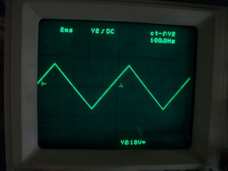

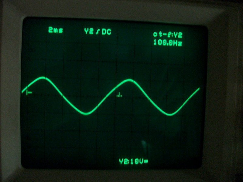

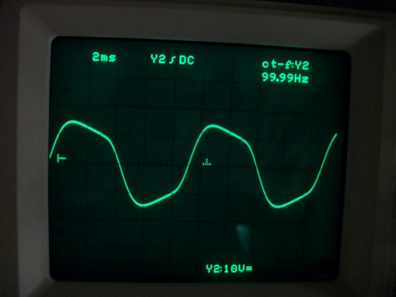

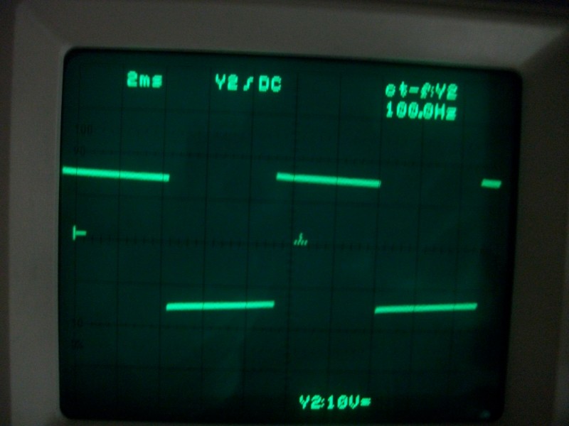

May be these pics are of some help.
Pics 1 and 3 are from a class AB amp and pics 2 and 4 are from a class D amp (both amps are from the same brand).

In all fairness the low pass filter should be engaged on the class Ab amp and set to a realistic value like 80hz if you are want to do a comparison.
Even though the slew rate of the class ab amp can produce a clean square up into the Khz range once the LP filter is engaged that point is moot.
That would be applicable for a 'laboratory' amplifier that needed to amplify any waveform from DC to 100kHz (or whatever top freq) and may be a way to judge amplifiers in general but has no bearing on audio amplifiers (especially subwoofer amplifiers), as far as I'm concerned. This can be and has been argued to death on various forums. The amplifier needs to be able to accurately reproduce the spectrum of sine waves for which it's used.
Would you judge a subwoofer amplifier that produced perfect sine waves from 10-300Hz and could produce thousands of watts of power with 100% reliability for years on end but could not reproduce triangle and square waves to be a poor quality amplifier?

It is difficult to see distortion in a sine wave, when it begins to be visible on the scope, its too late (too much distortion). So, by testing with triangle or square wave, we can see the the accuracy of the amp.

I agree with you, measuring distortion is not that difficult, i own a distortion meter after all. But if we want to analyze the behavior of an amp, we need to go to the extremes, that is triangle and square wave testing.
