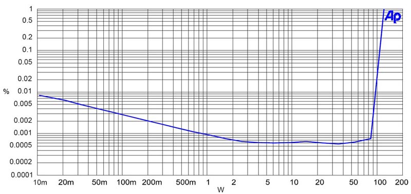

Hereby a measurement of an ucD with an extra Active Integrator. Measurement is in 4 ohm load;
So, who is here Boss........😀
Jan-Peter

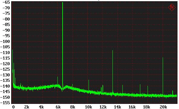

Hey guys,
An early "analogue input" design of mine, 120W 8Ohms 6.67KHz , the Non - Harmonics are due the generator / bench pickup.
Production designs are even better, but if you don't mind, I will keep these results unpublished until the products "hit the shelves".
(0dB 120W 8R)
John

Extra integrator? Could you attach a waveform of overdrive-recovery?
No, not that easy it's was a research what we did last year. At the moment we are too busy with the UcD700 project. At the end of this year we will start to work again on an UcD with active integrators. (...probably)

Not it's a part of the amplifier design, to increase the loop gain and so decrease the THD.

Yes indeed.....when you run the test on the AP I double check everything if I didn't measure wrong........🙄
But I didn't.....:angel:
Jan-Peter
