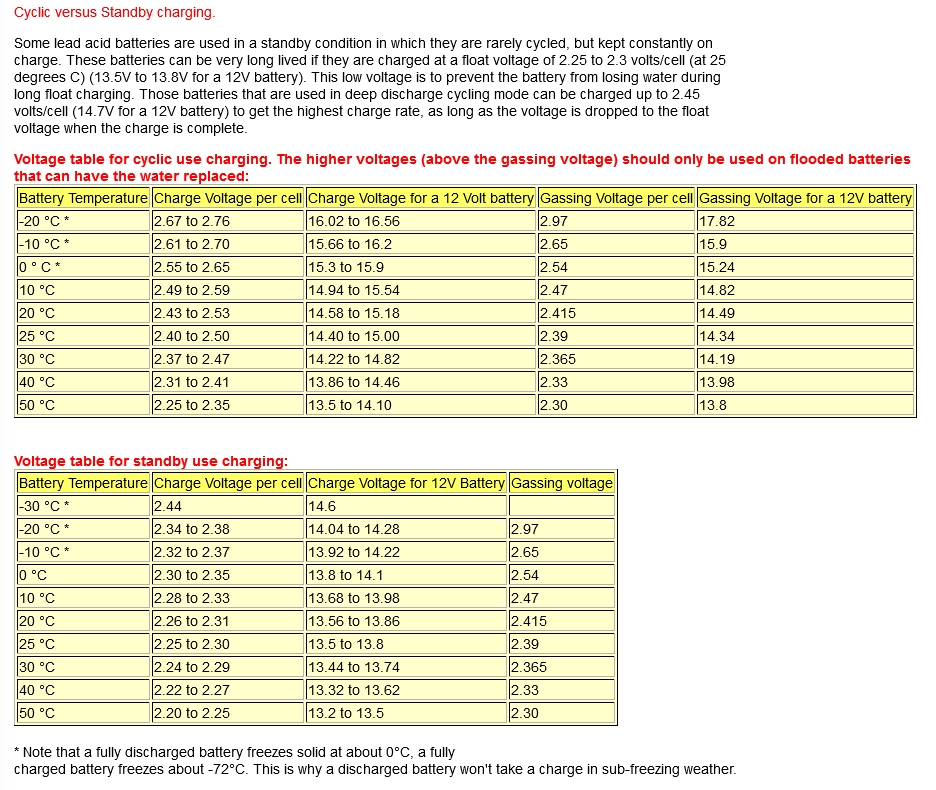

To maximize the battery life the float voltage should be temperature compensated to within 50mV. Google will find you some technical references.
http://batteryuniversity.com/learn/article/charging_the_lead_acid_battery

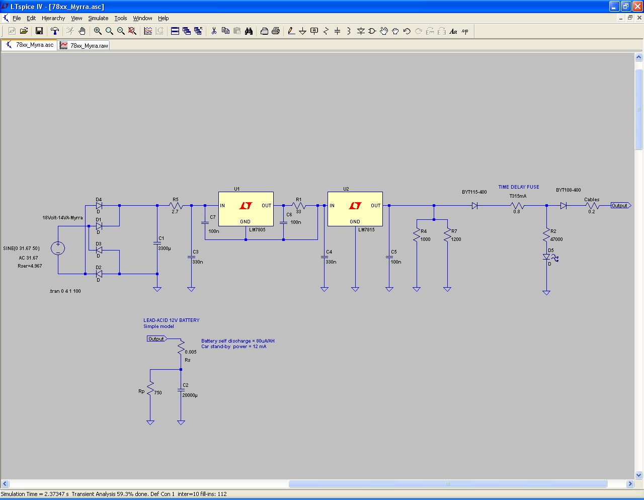

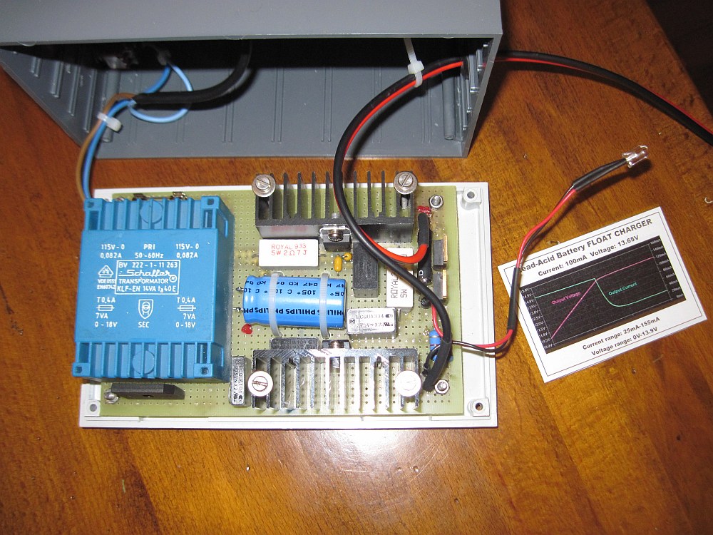

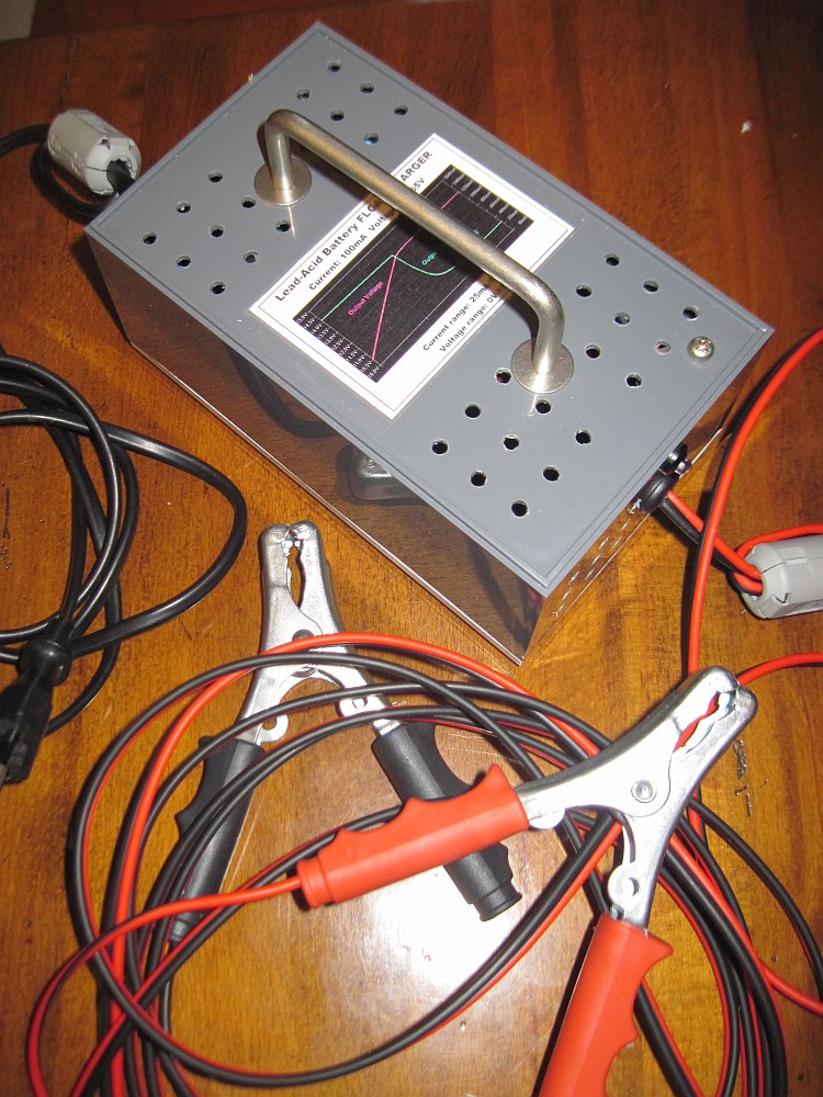

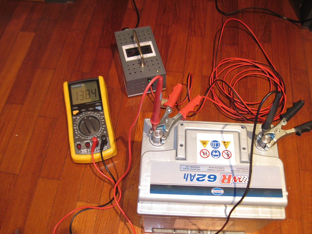

Ok thanks, I have done this ULTRA SAFE FLOAT BATTERY CHARGER and now is working cold after few days (battery is quite new).
It has 4 fuses, one fast on the mains, one delayed on the output, two inside the transformer.
Everything is dimensioned at least 5 times the necessary, as it is a circuit connected forever, with the battery plugged onto the car.

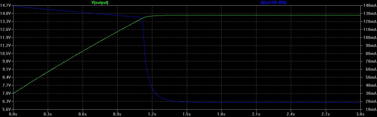

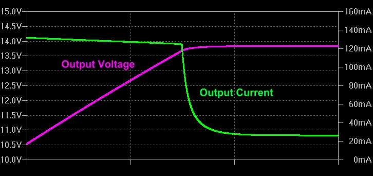

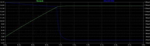

I have measured my car stand-by current of 12mA, and I have calculated a self-discharge of nearly 5mA (80uA/AH)
I have measured (but with battery unplugged):
12.95V 116mA
13.15V 109mA
13.20V 91.5mA
13.22V 86mA
13.28V 79mA
13.65V 31.4mA
13.84V 17.5mA
quite close to LTspice simulation
Attached photo, comments, circuit and LTspice simulation.
I have tested several rectifiers before choosing these ones, to find the optimal sum of voltage drops across the forward-biasing at such low currents.
Comments are very welcome, even if I have already done!

The current you measure into the battery is a variable. What matters is you maintaining 13.8 volts across the terminals which imo is to high for float charging at such a high ambient temperature.
If you measure the battery terminal voltage after standing disconnected for a few hours then you will probably find it at around 12.5v (at a guess). And that battery is fully charged. So if you apply anything over that voltage to the battery you are maintaining its charge. If the self discharge rate increases (and its hugely variable over time/temperature and aging of the battery) then the terminal voltage remains the same but the charger supplies more or less current.
I'd stick to around 13.5 volts and no higher. You can easily trim the voltage by using a 7812 rather than a 7812 and adding a variable resistor in series with the ground pin.
Hi your 12V 'battery maintainer' project looks very good! thank you for sharing
IMO anything ~13.6-13.8 is fine for temperate climates. The fact that the battery current is much less than 100 mA indicates fully charged AND in great heath. Adding an indicator light or meter showing that it's not in constant current would be ideal.
