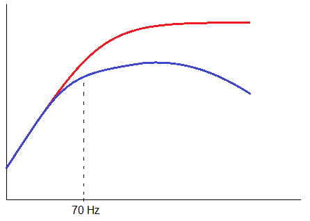

See, The Qts says essentially how high the response of the driver is at the fs compared to the midrange, a Qt of 1 means it's equally loud. You can check that at any simple model simulation program, create a sealed enclosure with any kind of driver, adjust the enclosure volume so it's Qt 1 and you'll see, the level of the response of the driver at the fb (the resonance will rise with lower enclosure volume) will be exactly the same as in the midrange.
You'll also see, it got a bump above the fb, that's not desired usually and a high Qt got an overswing and takes also longer to get back to stop moving and stop at the resting position. A Qt of 1 means, it's underdamped. A Qt of 0,5 is the best impulse response and decay (and the enclosure will be big) but starts early (relatively high frequency) to drop in level, making it a lot quieter in the bass. A Qt of 0,7 is deemed to be the best compromise of spl, impulse answer, enclosure size and how deep it will go. The Qt can't ever be any lower than the Qts in any enclosure. A Qt below 0,5 is overdamped and does not have an overswing but takes a lot longer to return to the resting position too, just staying in the positive excursion instead of the overswing into the negative (inwards) excursion. As you can see here, it takes even longer to return to the resting position than higher Q factors:
A low Qts means, it's a lot quieter at the fs/fb, even if the input power is the same, or, in other words, it moves less air. If you want it to be linear, you have to do something against that fall off, like BR. For BR i.e. it's good to use a low Qts since the enclosure/port will rise the Qt very much. On a sealed enclosure the size of the enclosure, the volume, increases the Qt. Usually, in most rooms you get resonances at different frequencies, depending on the size of the room (room modes -> wavelength of the frequencies), so a slow slope will get you mostly linear as it compensates for the room gain.
Low Qts drivers are made for bassreflex (and generally, horns too) and they aren't good in a sealed enclosures because they are simply not loud enough for the low frequencies, unless they have a very low fs. On an OB you have a lot less room influence and therefore much less room gain too. And you don't have any Q increase from the enclosure either, because, well, there is none. That means you generally already need a higher Qts on your driver to get to the same response in a sealed or even ported enclosure.
The high spl of the bass driver in the specs does not apply in the deep bass. As already explained, the level of the low Qts driver will be a lot quieter. The drop at the proposed crossover frequency of 70 or 75 Hz will be approximately 5dB lower without the crossover than the level of the Supravox driver above it, and you can't increase the level with a passive crossover - which in turn means, you can hardly hear the difference and you can't fix it (passive) either.
So, for an OB, to use a low Q driver is the most expensive way to prevent deep bass.

To go passive, you need a much higher Qts so it reaches the level of the Supravox. Since you don't want that, there are only two things as solution.
1. Use more 15" drivers in the sub range and push the Qt slightly, likely 18dB crossover. A 2nd 15" would give you +3dB by double the cone area and +3dB because the halved impedance doubles the power drawn from the amplifier. You mentioned a tube amp. I don't know if the amp would be happy about the lower impedance. Also, the coils would get much more expensive since lower (half) impedance means double the inductance and for 18dB you need two per side. The DCR of the coils will rise the Qt but added DCR ofcourse decreases the spl. A lot of compromises and 'IF's.
2. You stay at an active solution, preferable with a dsp. That would solve all your problems and still be cheaper.
