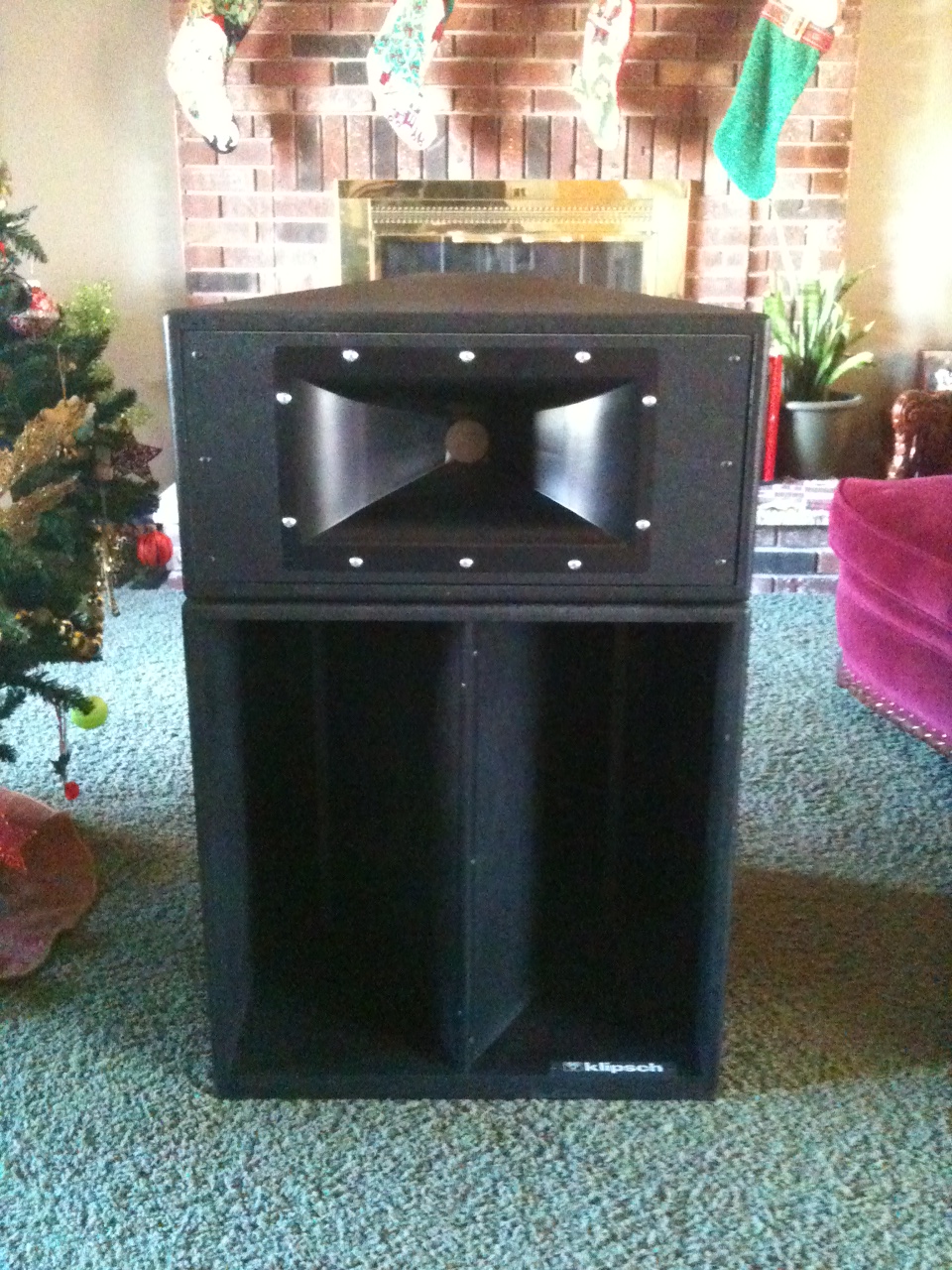

It might be tiny but it works. It is a 2" horn (I'm presuming everyone knows that)
(these are not my speakers)
oops, missed one. Editing to add the 510 on top of a LaScala. The K402 was a mistake to post.

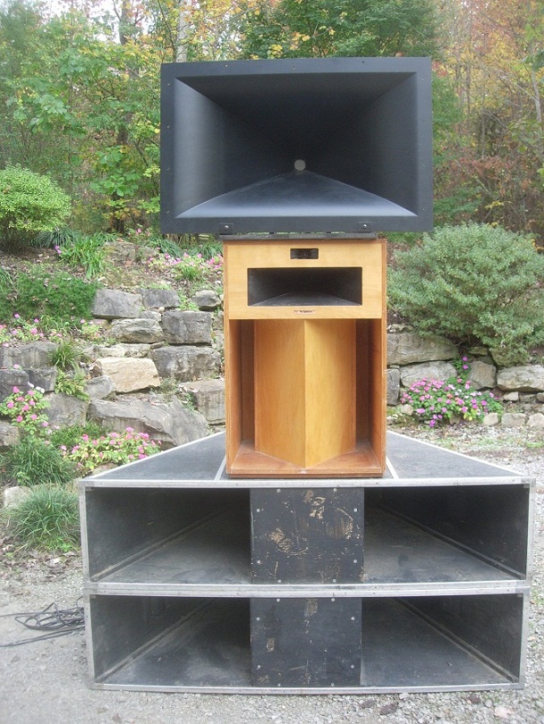

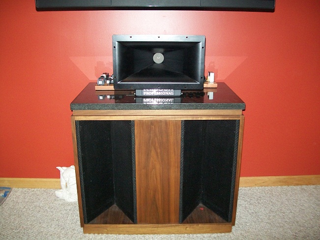

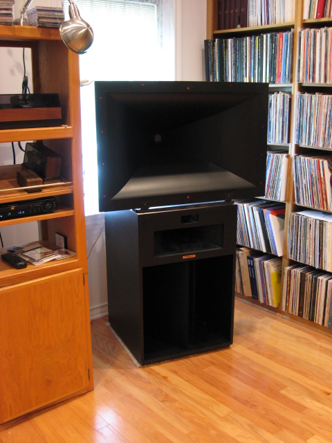

The above pictures are a Klipsch Belle on the left with the top removed. Speaker on the right is a LaScala with the upper guts replaced.
The center speaker with the top horn is also a LaScala. That is the K402 horn that they generally use with their Jubilee (and MWM) speakers.
The K402 is (in absolute terms) taller and wider than the entire LaScala!
Both are fantastic sounding horns. Both are 2" throats. The K402 is crossed at 380Hz (on the 2-way Jubilee) and 470 Hz on the LaScala
Both are modified Tractrix so some equalization is required for the upper end.
Klipsch recommends an active.

This was fun. Using an active allowed me to punch a button and mix a couple configurations on the fly.
K402 + MWM bass bin
K402 + LaScala
LaScala + MWM bass bin
OK, now move that inside! I hope you have a very large room with a high ceiling!
9' ceilings, LaScalas are in the rear and Jubilee's are in the front. The MWM's are in the garage for outdoor duty. There is also a Danley DTS-10 hidden in a wall.
