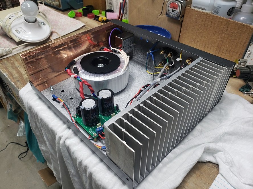

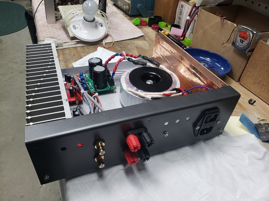

I ended up using the big heatsink. I am waiting for the paint on the top plate to cure so it is not installed yet, but you get the idea. I ran it for a while and it barely got warm, so I am sure it will be fine when I install the top plate. But driving La Sacalas doesn't take much power.
Yeah. You definitely want vent holes. Otherwise all you have is a thermal mass. That'll help some but it'll overheat eventually.

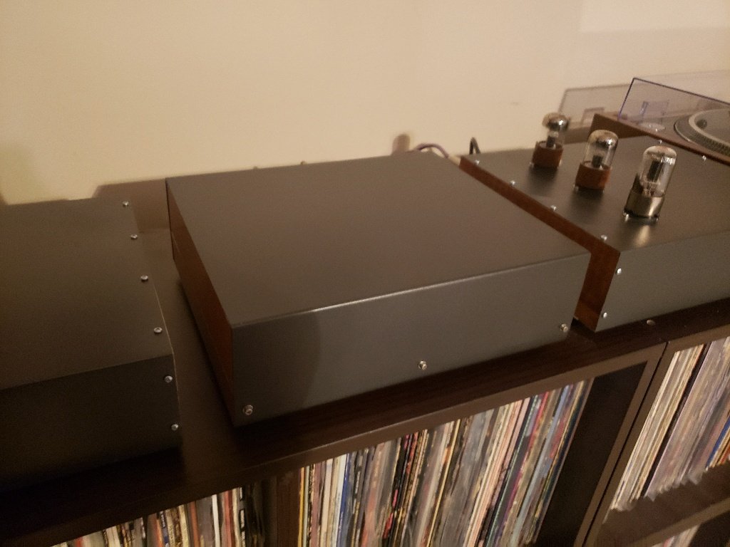

Yes I make my own enclosures, I have been doing it for years. I normally build tube gear but have built solid state phono preamps.Folded your own box? Nice.
I'm not sure if you have the top and base drilled to allow convection, but it's huge anyway 🙂
Dangerous time in the build. I hope your mind isn't trying to mod it already. You might never finish 🙂
I have holes in the bottom and back to allow some ventilation. I will monitor the temperature

I don't see holes to assist air rising up through the heatsink. It might be a bad look to put some in the lid over the heatsink, but a 20mm hole in the base plate, maybe 10mm back from the amp chips, would increase convection currents there a lot.
I bet it stays cold anyway. That's a big slab of metal.
Thanks, It is painted, I use primer, Krylon Hammered Black then clear coat. It hides a lot of imperfections and looks decent enough. It holds up quite well too. Been using this method for several years. I start with 22ga steel sheets, cut and form them myself.Nice chassis work. Is it painted or powder coated?
I put holes in the bottom and back to set up a small convection air current inside the enclosure. The heatsink has rather large fins with spacing and the fins are outside of the enclosure. I ran this playing music for over an hour and the enclosure/heatsink were still cool to touch, not even warm. I thought that with the huge heatsink and the enclosure size it would stay cool. If I do have any issues with overheating I can deal with that, I doubt that it will be needed though.

While the heat sink is probably not working as efficiently as it could, I bet there's still a lot of airflow if you have holes in the bottom. And it's a sizeable heat sink to begin with. I'm sure it'll be fine. Not everything in life has to be optimal. 🙂I ran this playing music for over an hour and the enclosure/heatsink were still cool to touch, not even warm.

I did too at first, but for me, steel is easier to work with and paint than aluminum.I used to do that, though I worked in aluminum.

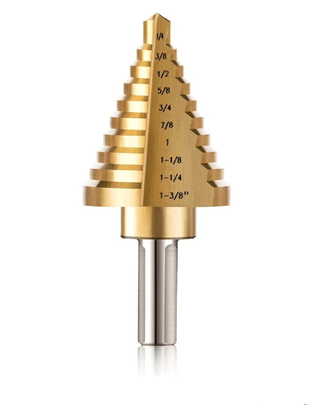

A step drill bit like this, it makes good holes for tubes.What do you use for drilling larger holes in steel?
