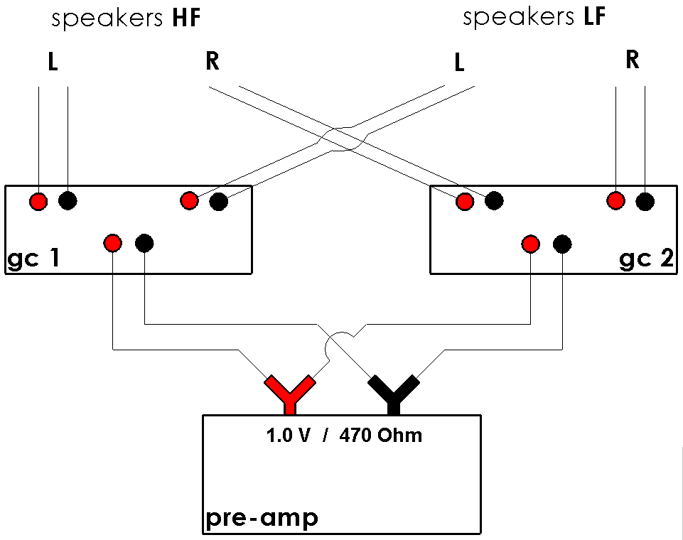

OK, I'm cooked and baked now and will place an order for 3886's 🙂 ! I thought to go dual mono, but might not understand all the issues on dual mono blocks vs. stereo. Therefore will add the details to try to hopefuly clarify. Check it out, since it'll definitely prove my noobness, heh.
current status:
- I got ra-1062 (60Wx2, 8 Ohm, integrated)
- ra-1062 has single pre-amp output (one +; one -)
desired status:
- build two GC's based on this group Achievements (capital A 😉 )
- split ra-1062's single pre-amp output into two and feed GC's
- enjoy bi-amping with two GC amps and one Rotel pre-amp.
Does this make more sense... with monoblocks? Or I'll have to go stereo with this one?
"Splitting" of pre-amp out signal from ra-1062 is the unclear part you aksed clarification for in your previus post.
Now, as for toroids, I tought to buy two 300VA 25V (or 30V?) for each GC, but from your post I conclude I can go 200VA for monoblocks? That would certainly be cheaper, but please confirm.

By amplifying is commonly defined as the pocess of powering a single speaker with two amplifiers.
Monoblocs are simply one channel amplifiers that have independant power supplys, so it takes 2 for stereo.
Now if you were to "biamplify" a pair of two way speakers you would need 4 monoblocs.
You would simply take a Y splitter from one channel on the preamp output and run each end to each power amp on that channels monoblocs which in turn are connected one ofthe speakers.
Is that what you mean to do?
In any case, please don't wast your money on subjective hocus pocas, keep it real. Save subjectivity for your own experiments when you get a chance, then you will not be dissapointed.
Look at the datasheets, they will shed a lot of light, and will be very helpful to you later.
I would use 300VA at least. 200VA will work alright though, just don't push the amps hard.
Cheers!

That's what I had in mind (see pic). Hence the need to order 2 dual monos... I wanted to use y-splitters, but wasn't 100% on do I need some other kind of crossover/splliter as some pre-amping designs suggest.

- my pre-amp's output sensitivity/impedance is 1.0V/470 Ohm. Are 3886 signal inputs ok with this? Sorry to ask, but I couldn't find it elsewhere (tried Brian's pdf's, ...)

Jan is correct, you need to do one of two things.
1) Make sure you have no passive filters on your speakers and use active filters to get your crossover points. In this case a simple Y splitter is obviously not enough.
2) Make sure your existing passive filters can handle bi-amping and follow the direction to do so. Usually this involves disconnecting a bridge between binding posts, though sometimes it is more involved, especially for speakers with series crossovers. I have actually had to install new passive filters on some of my speakers to handle bi-amping. But, as long as the speaker was design to be biamped you should not have to go to that extreme.
Russ, Jan...
yes, my main speakers are bi- ready (separate HF and LF posts with the "golden bridge"). It's Monitor Audio S8 and I'm already using 'em in a bi-wired config (of course, bridge removed). These are 6 Ohm.
I got another, old, 8 Ohm pair that I intend to use for gc testing, just in case... 🙄
As for pasive/active filters... It should be none: it's the "normal", built in crossover for two-and-a-half way speaker configuration.:
