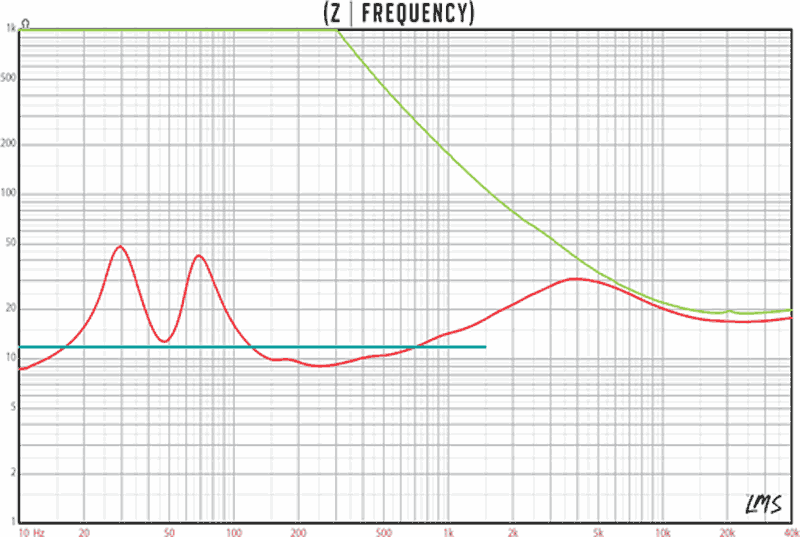

Can’t find a measurement of the impedance curve of the target speaker, but the one’s i have seen are not very flat. If this one follows the same direction you want to choose an amp with fairly low output impedance.
dave
More of interest is the maximum. With a high output impedance amplifier the FR is modified by the interaction with the speaker impedance. If the impedance rises so doe the FR, if it dips so goes the FR.
Here the Soul Supreme which is similar to other models i have seen.
dave
dave
Thanks for all the answers...I found Omen's impedance curve on ZU's website and it really does like similar to the Soul's
So, looking from FW page this means something like F5? Although, Aleph J and M2, which were also suggested, seem pretty low also
