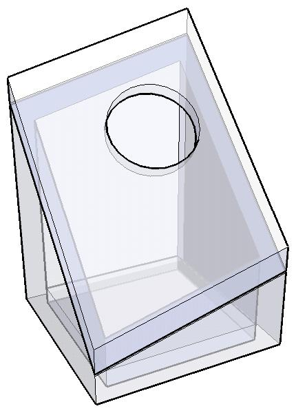

I just designed a sealed Alpair6M surround for Chris, my biz partner. He needed small, and placement options are very restricted. The natural roll-off of a "larger" sealed box, should, in theory, match well with the gain from wall/ceiling placement.
Baffle has been oriented to cross the on-axis, just behind the 2 main listening/watching seats.
Note: visualization is oriented with the baffle facing up, when mounted baffle will fire slightly downward and across the room. Cut angles are 45 & 15 degrees. with 12mm BB, about 16x16x24 cm extents

I may have to eat my words, but it could well be that with the right size sliding table saw the above box is easier to build that it was for Dave to draw 😉
