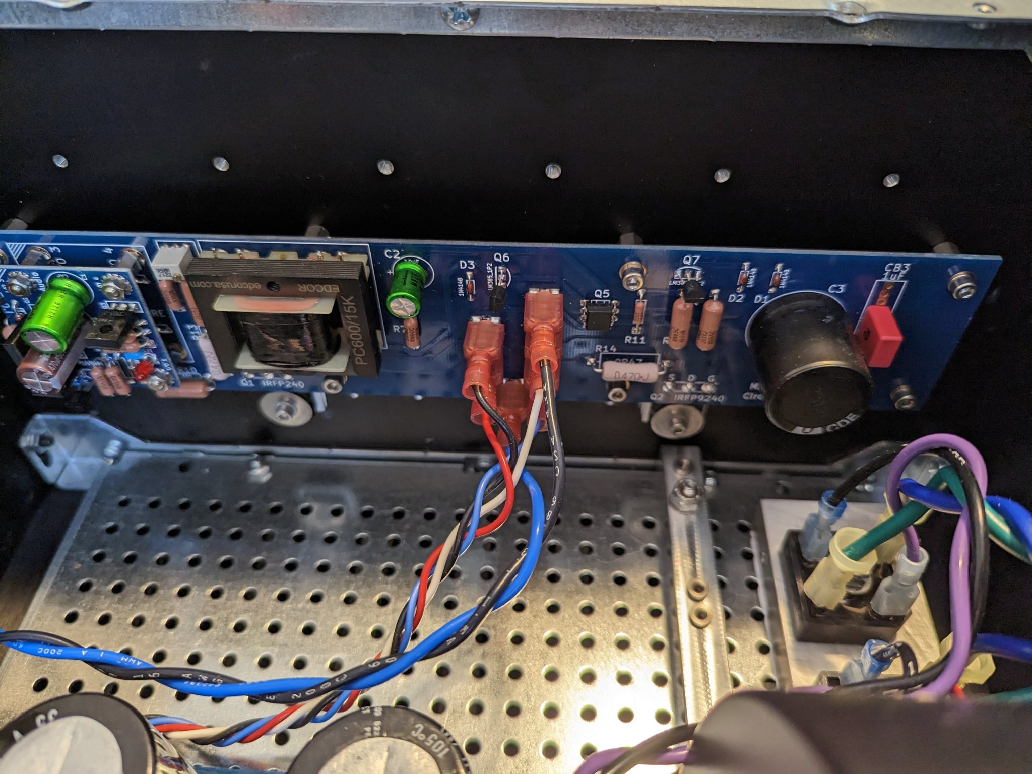

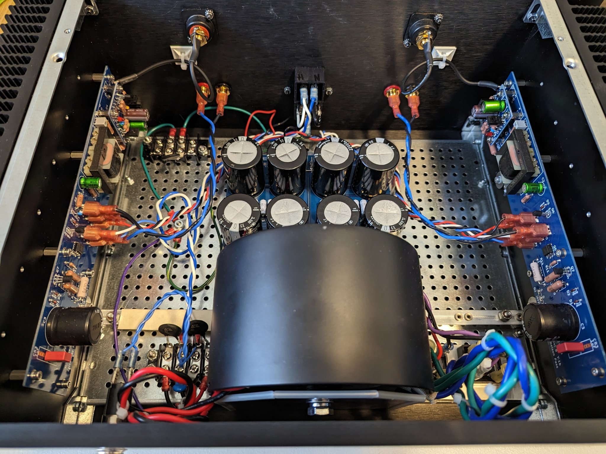

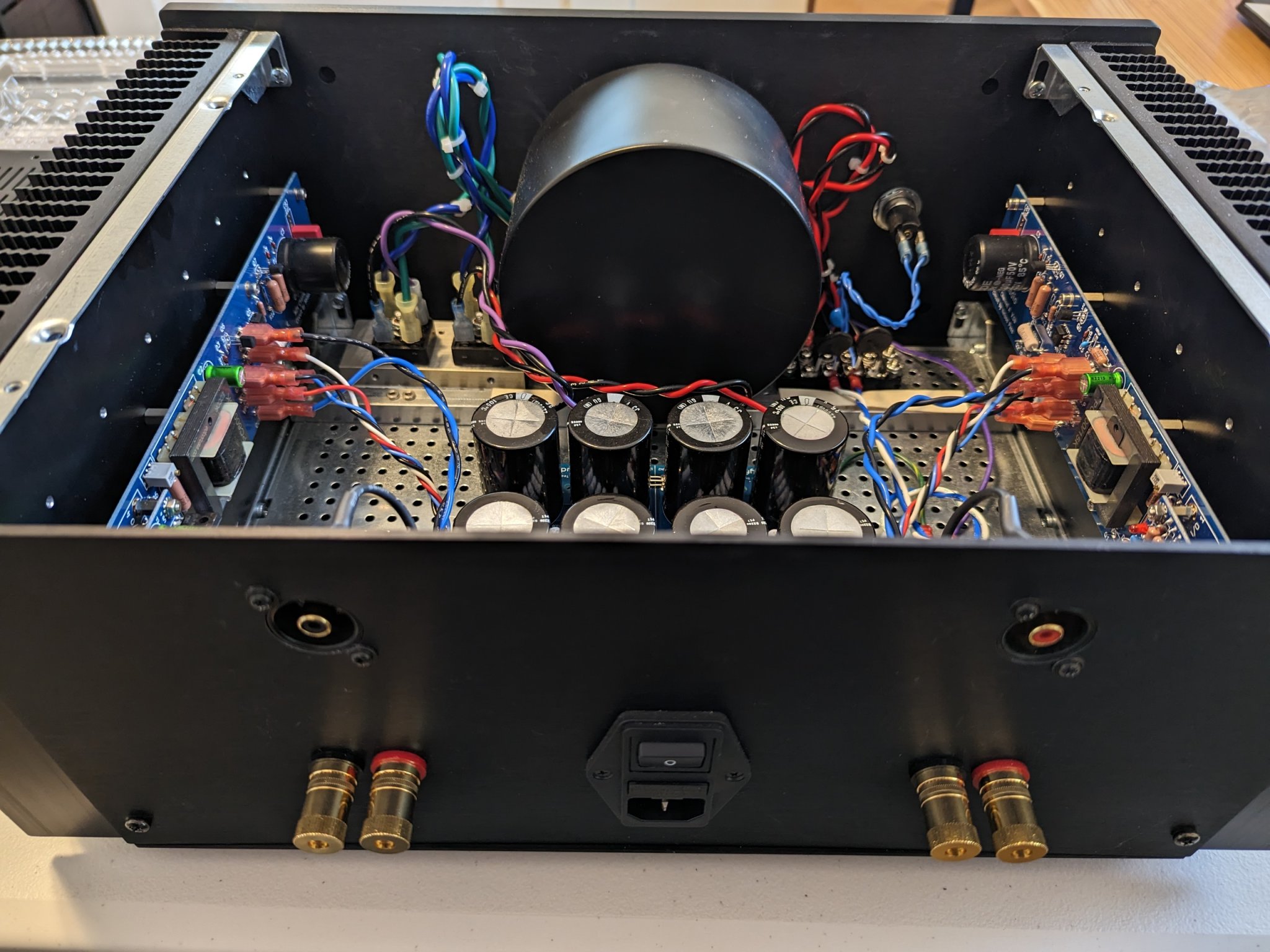

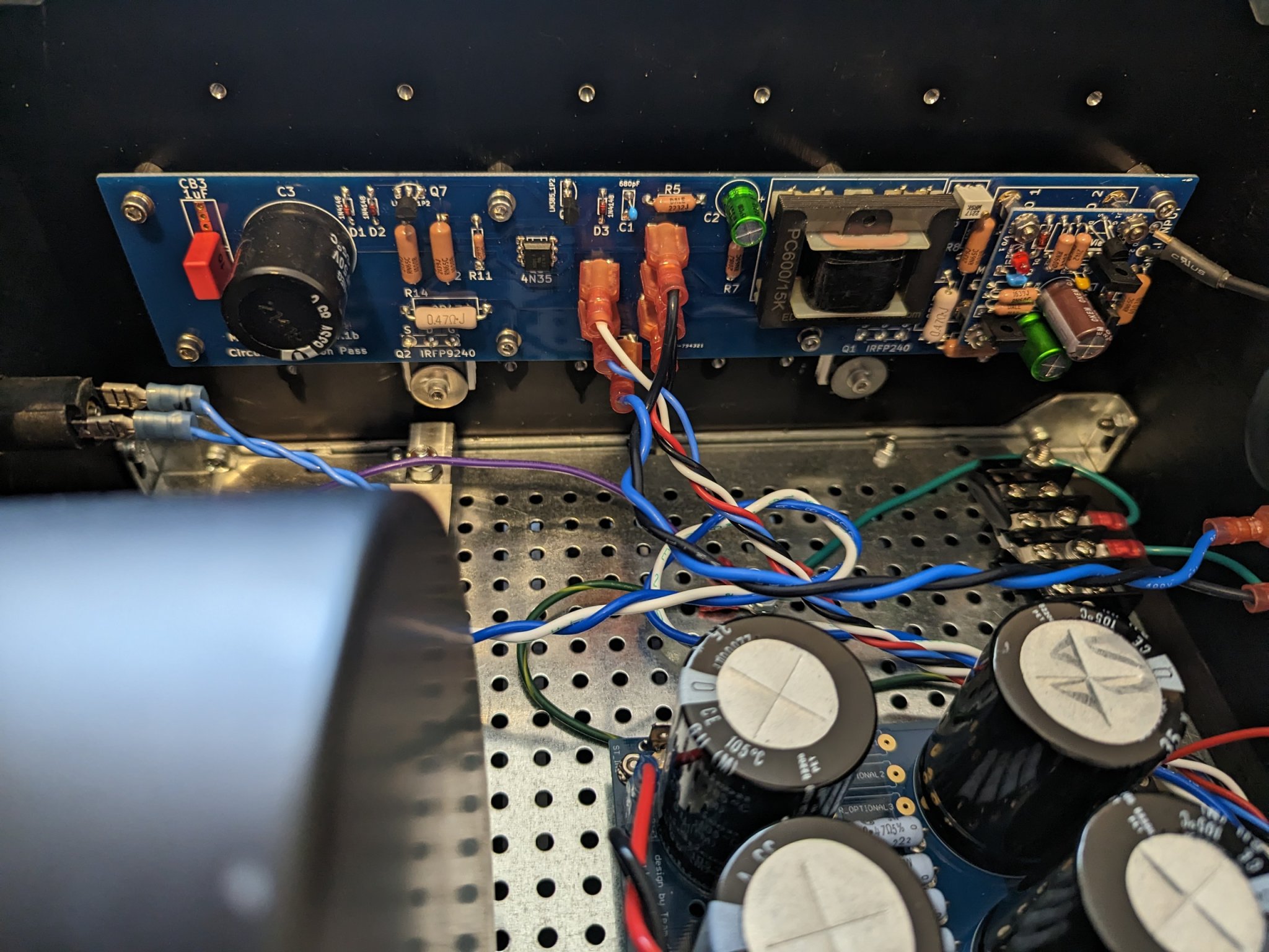

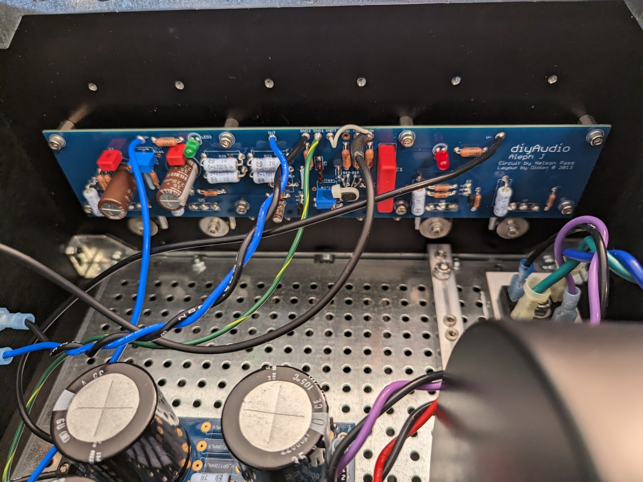

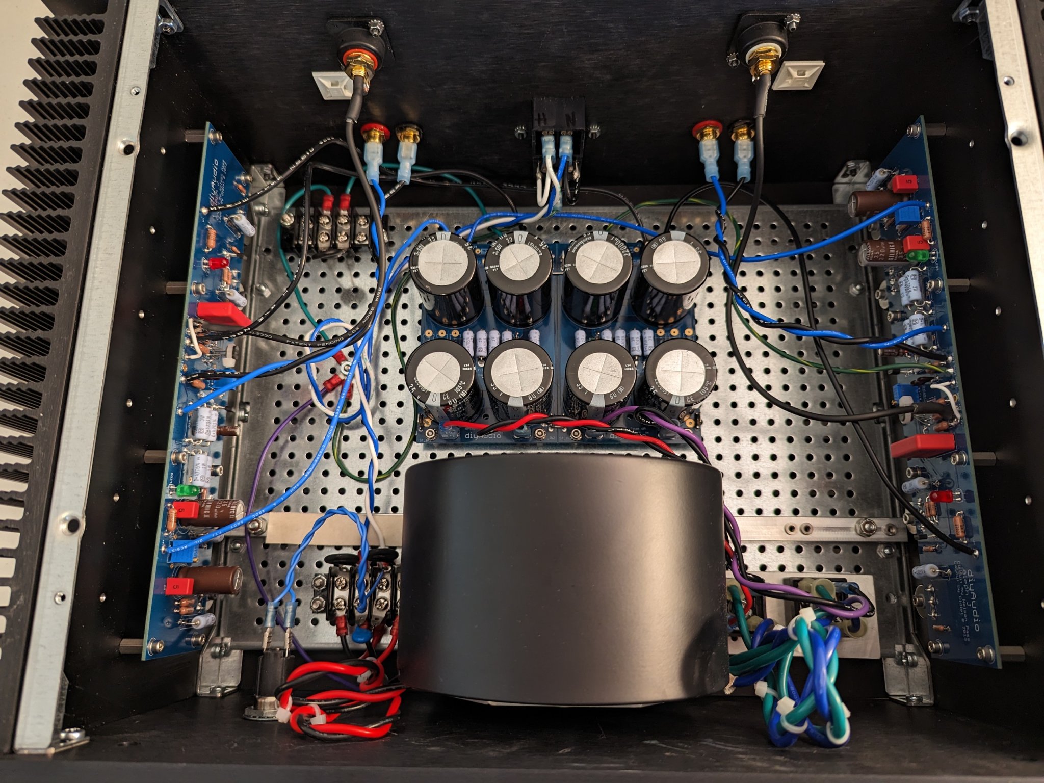

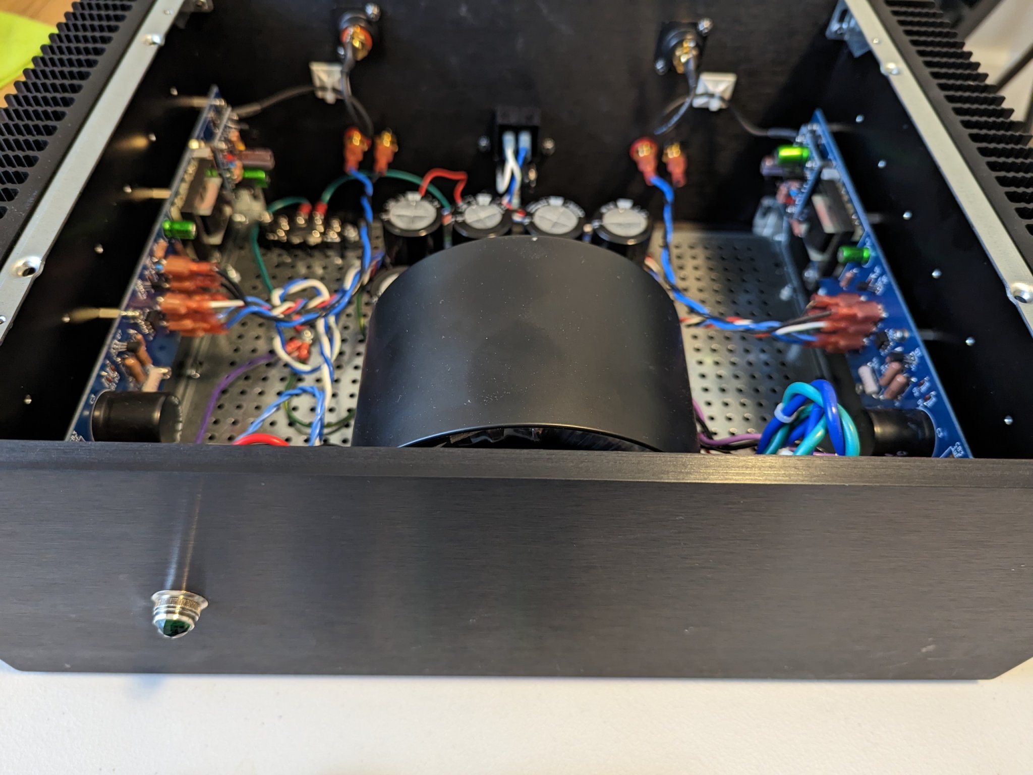

Used the same chassis and power supply for both amps. Just swapped the boards out.

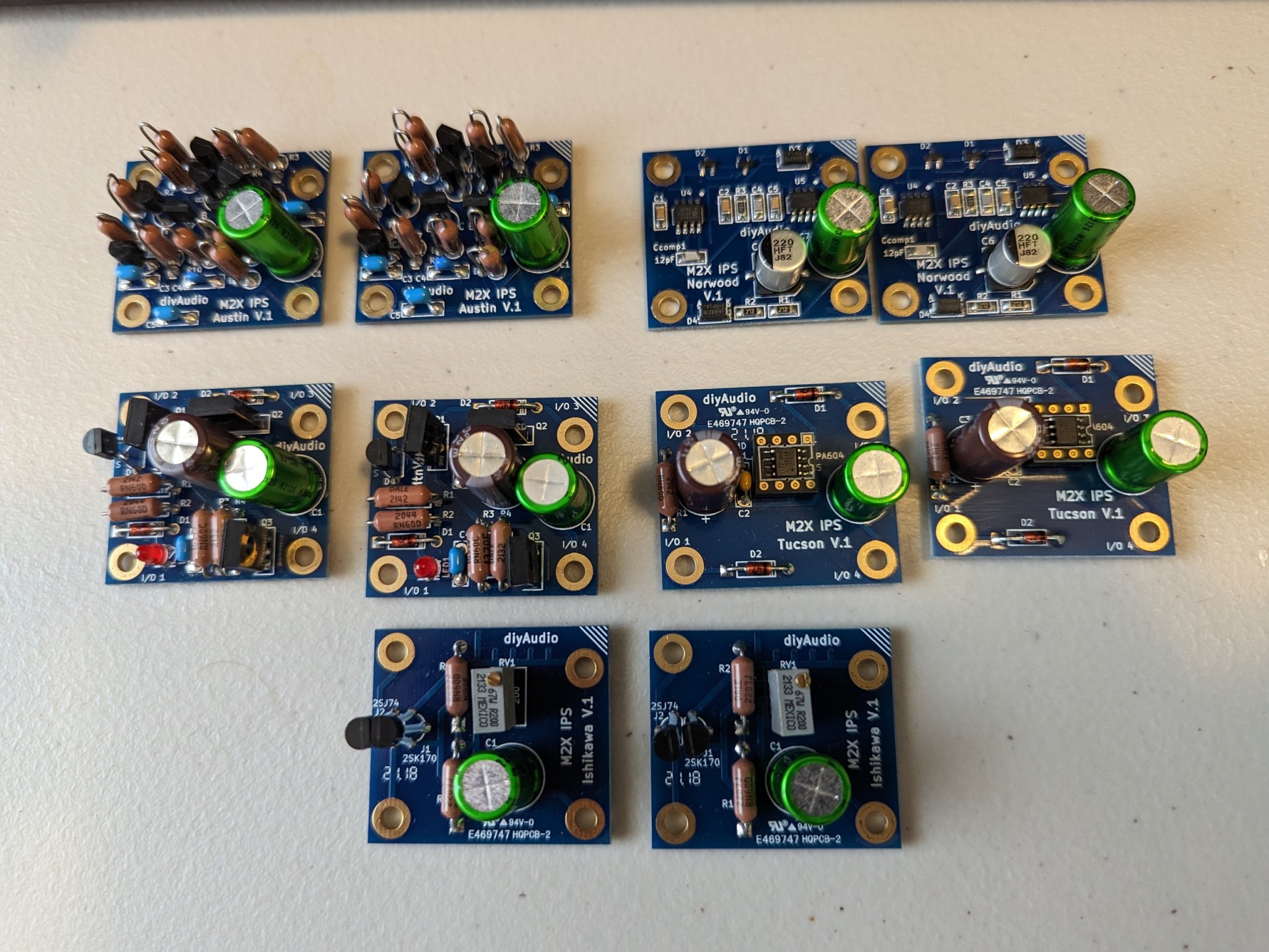

First build was the M2X. Built and listened to all of the daughter boards from the diy store. My favorite is the Mountain View board, and this is the one that I kept in the amp the longest.

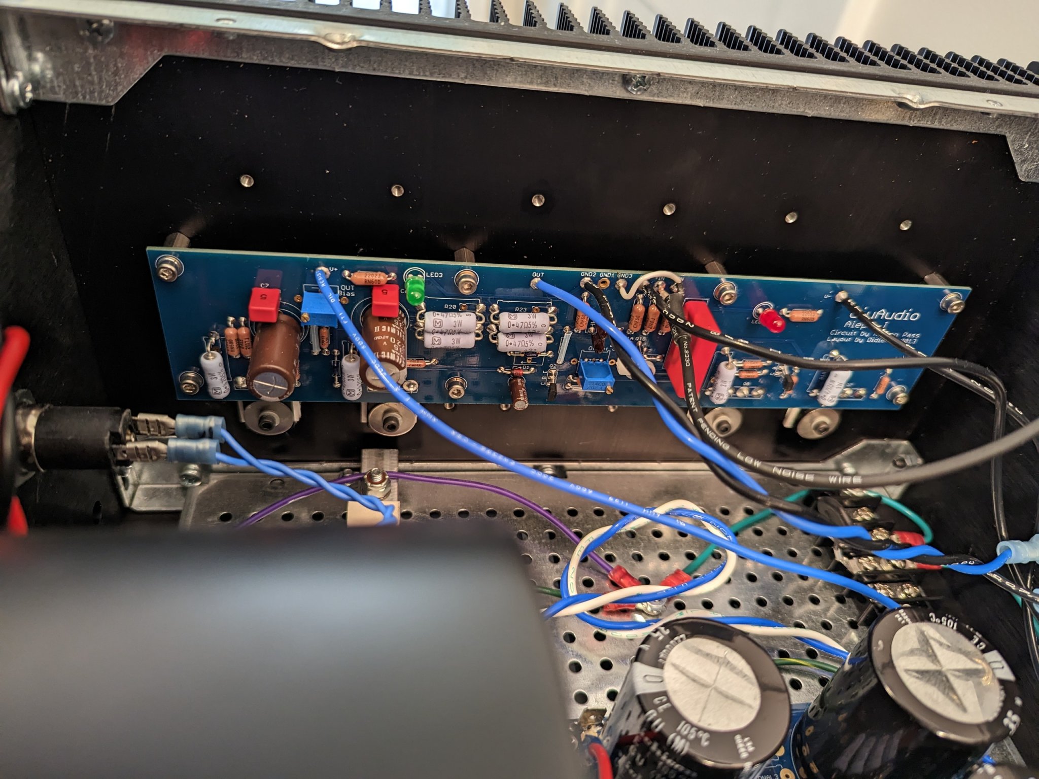

Then a few weeks ago I finished the Aleph J build.
DAC / preamp is a Benchmark DAC2 HGC. Speakers are Yamaha NS-1000.
Someone will ask me which amp I like the best, so I'll just tell now - it's the M2X with the Mountain View daughter cards. If fact, this is the best sounding amp that I have ever heard. The Aleph J is also near the top. My preference just leans to the M2X.
Of course, since I'm using the same chassis for both amps, I'm going by memory, not a/b testing. Without a doubt though, the M2X with the Mountain View offers better bass. Lots of tight, articulate control. From memory, the M2X / Mtn View is also more transparent, layered, and holographic, with a blacker background. This is just my preference. The Aleph J is more harmonically rich.
Yes - this is good idea - keep the chassis and power supply , and then swap the actual amps .
