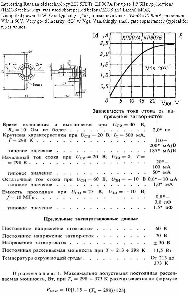

If you are prepared to use cascode, and only wants 10W into 8R, then there is no better than LU1014 for linearity (see Zen Version 9).
May not be low enough Zout, so you need to play some tricks, which adds some complications.
But not impossible.
If you want low Zout, then you need to use a Semisouth or UHC Mosfet with high Yfs.
Or use 500x 2SK170BL in parallel (with cascode).

With Vds=20V, 5V vgs gives 1A current. That is a transconductance of 200mS.
To get to a power amp of Zout of say 0.1R, you would need 50 of them in parallel, wouldn't you ?
And that is only for the driver device.
4 of them for a pair of source followers => 200 devices ?

EUVL, I agree, these parts hardly fit demands of NoGNFB. But with carefully arranged not deep current NFB, they will work perfectly. All basic rules for correct implementation of NFB will be fulfilled - intrinsic linearity, enormously high speed of the output stage, 20dB of NFB, one pair of paralleled KP907A will be enough. I have already designed so with paralleled KP903A jFETs output. The KP907A are special linear MOSFETs, and they are much faster.
At the same time, I can not be shure what is better for sound - the jFETs or faster MOSFETs. I do not know, and have not time to test everything.
Another point, KP907A are available, but much more expensive, something from 10 to 20 USD per pcs.

For NoGNFB design I would propose to look at RD100HHF1 MOSFETs. With close to 4S transconductance one gets 0,25 Ohms Zout for the follower. I used them with good results just at source follower output stage.
If one has NFB design where KP907A are needed, I could arrange shipment, but it could be justified for quantity more than 10pcs and will take near one month. They are available from many sources in russia, but in small quantities (usually only few pcs) and they do not ship for export. Only buying via partners are possible.
