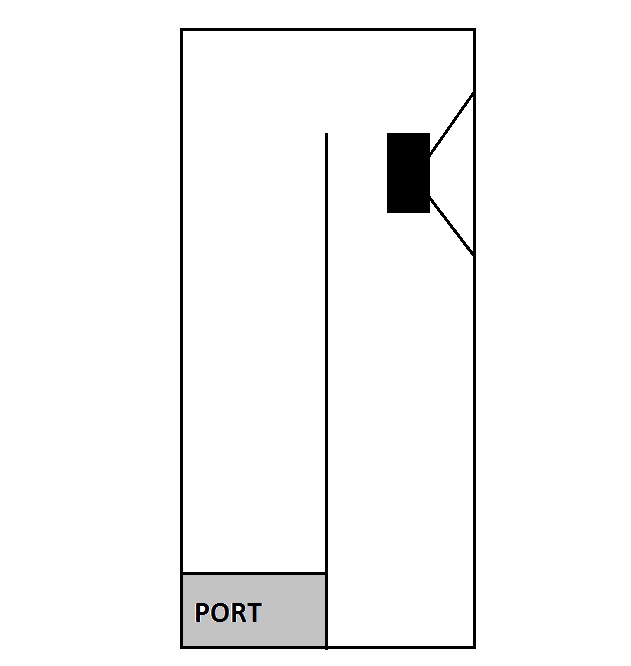

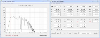

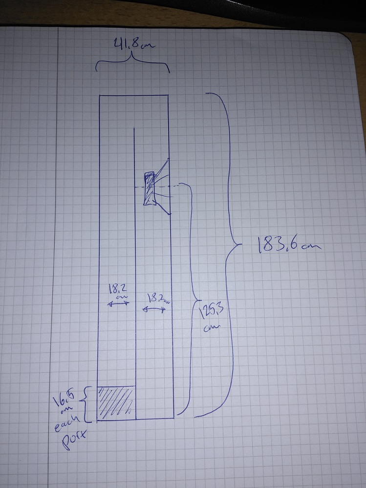

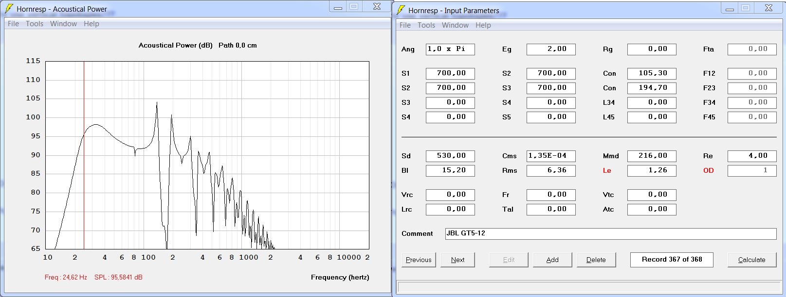

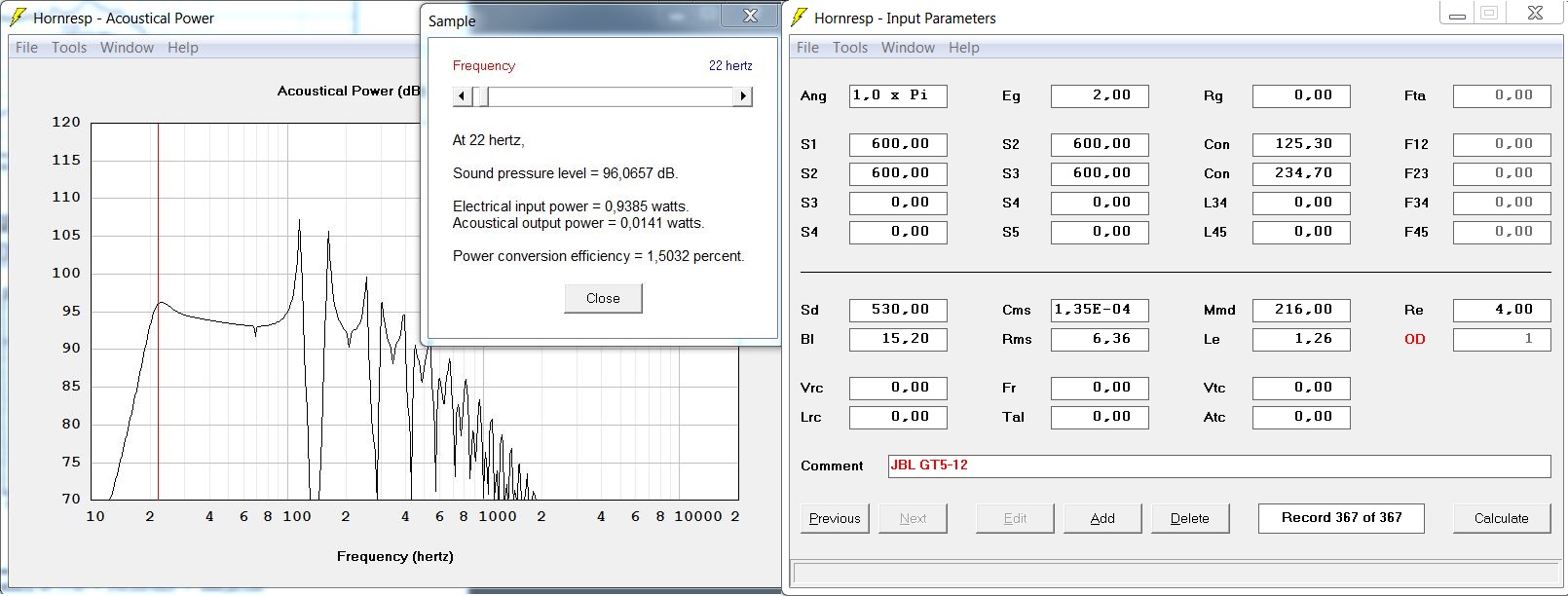

an ideal spot that is around 50cm x 50cm x 150cm
I did not notice the "150 cm" part until now when I reread your first post.
If I fold it twice it will exceed the 50 cm dimension instead.
Sorry for my inattention.
It does not simulate as nice if shortened to 150 cm height.
Thata excellent, thanks. I can manage the 183.6cm length ok. If I lay them on their side can I just make the port in the end rather than the two sides?

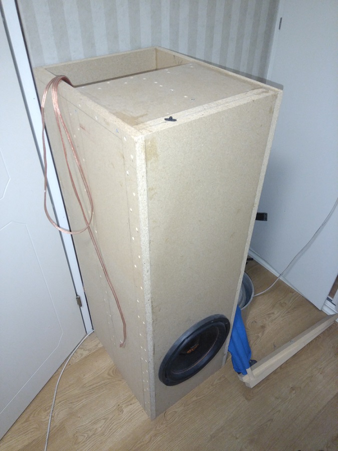

This is a 33 Hz tuned ODQW for a 12 inch car audio bass driver.
It is used lying down on its side under the table, with the mouth radiating into a corner. A very nice sounding and potent computer sub. With 400 watts it makes everything in our house pulsate and vibrate violently. With just a few watts it makes a great home theater and computer gaming sub.
