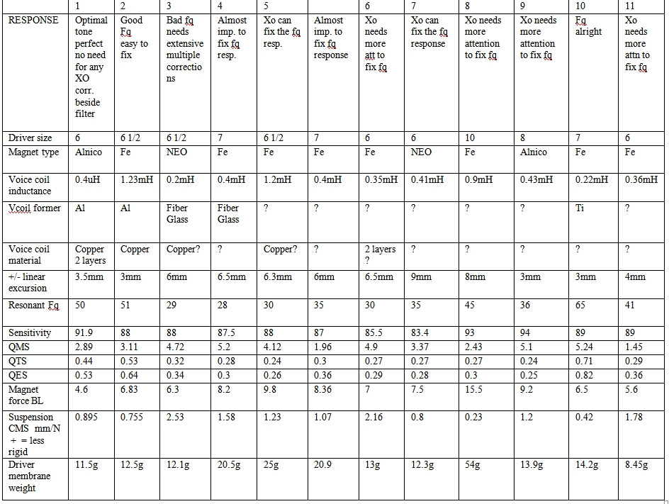

Which driver would you choose?
I entered a table with drivers parameters, unfortunately I cant enter the response but I rated the responses from the ones that can be used without corrections to the ones which are almost impossible to correct the response.
The idea is to select a driver for maximum dynamics, resolution and true frequency response for the midrange of a 3 way.

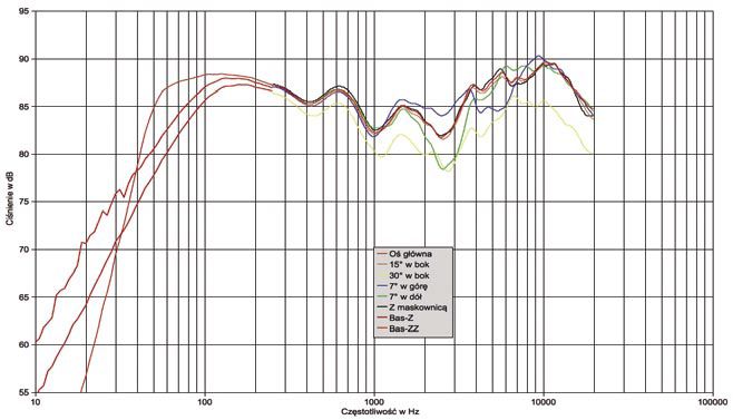

The B&W 805D is expensive but not a good speaker. Have you ever heard them? Or seen measurements? The price tag was never granting good sound quality.
attachment.php
measurements from audio.com.pl
If you read my post : I have been in a room with all the B&W models from the low end to the 805D 804, 803, 802 and the PSB most expensive towers, I listened to each speaker with my reference materials,
I never saw the response curve of the 805D until now, thank you for that, this confirms what I heard, very vivid details, but it was not unpleasant, just too much to impress a first listener. But I have to say that it is a good speaker and sounds better than the lesser models from B&W, the 804, 803 and 802 adds bass, they are all good, the 804 is very reserved, the 803 more neutral and the 802 is very fun to listen to the bass which is very dry. I didn't listen to the 802 with the best amps, which were NAD.
I asked if you've heard them because you made it sound like they would be some kind of goal to reach - which I found a bit ..surprising..
None of them is a dedicated driver for mids.
You need a mid driver not a midwoofer driver. According with this you can exclude the 10in and maybe 8in drivers.

Yes, ICG you have a good knowledge, only the 10' (#8) has a very stiff suspension and can play at high levels.
Isn't it true that when you have 'dips' everything else becomes a peak :D
I don't like are 1, 2 and 10 because of the Qes
What is the problem with high Qes? because I want to use the drivers in the optimal box, closed or vented; driver 1 has a Qts of 0.44, the suspension is mostly dictating the sound;#2is very puzzling to me because it has less sensitivity, maybe the alnico magnet is the determinant factor in construction between 1 and 2?
#10 is a driver specific for midrange with stiff suspension perfect for a closed box, and it has a no problem XO, just needs baffle compensation , impedance filter and 2nd order high/low pass
