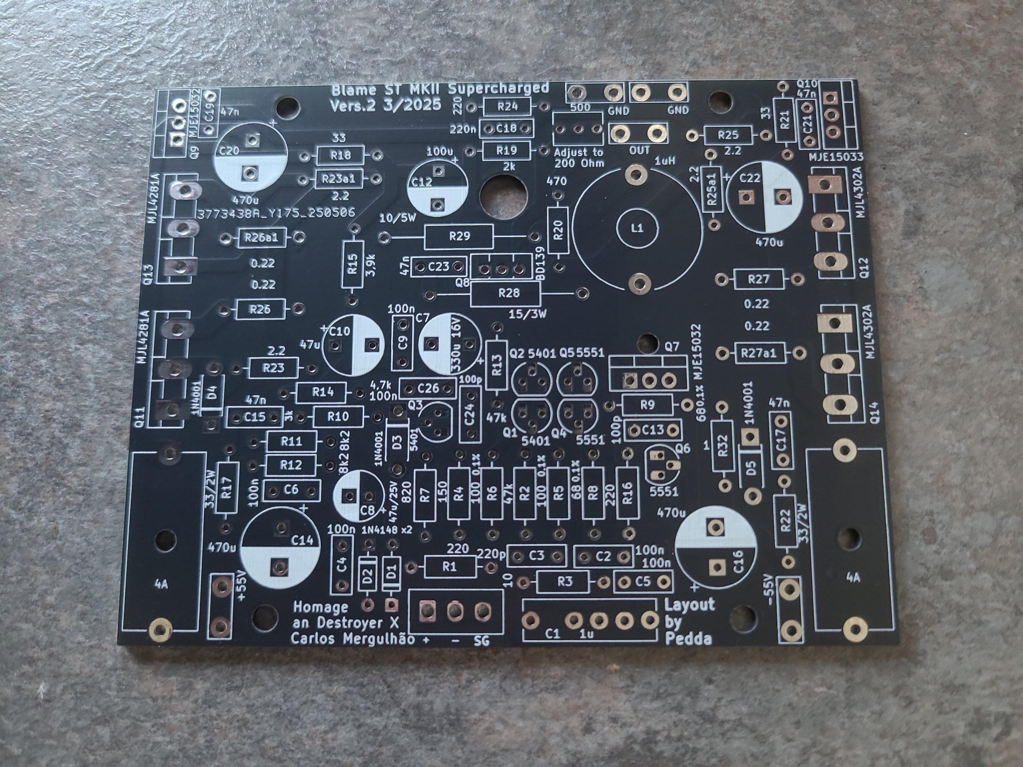

As an homage to Carlos i have build a Blame ST AMP today... i have made a pcb from the DX Amp too...
I know LJM has a build an amp with very similar design and with similar name. Dont find it in the moment. If it is true that LJM made a mod of the DX amp, dont know. His name was on the back of the pcb.

If someone want, he can get my gerberfiles of the Blame ST. I dont share in respect. I have also made a pcb of the Blame ST MKII Supercharged ( the beast). The same, i do not share.
You can write a privat message to me.
