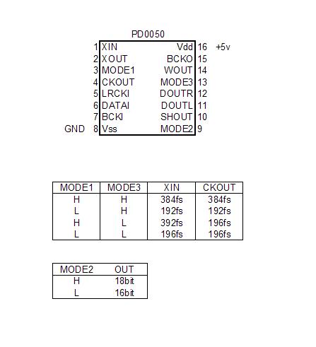

I have a low cost SM5807, one SM5813 and several new PD0050's. The last one is a Pioneer 20 bit digital filter which in its time was supposed to be good. I can't find any documentation on the PD0050. :xeye:
Does anybody know who made these Pioneer chips ? Or where to find datasheets ? I googled a lot but found nothing.

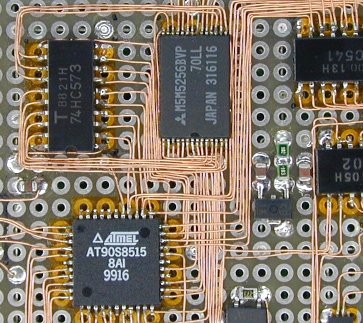

As for SMD, I think a lot of people are scared to try this technology since it seems so intimidating. And, like anything, if you try to use it with the wrong tools or techniques, it can of course be very frustrating, and this has led many to make unfavorable statements about SMD. But, I think if you have a look at my page about SMD rework in the Wiki, you'll find out that SMD can actually be much easier than through-hole. All you need is a steady hand and some simple tools. Very easy, you'll see!
I know you'll be skeptical, but it's actually easier to wire something like this crazy looking SMD circuit than it would be to make the equivalent through-hole, P2P wired ciruit! Like I said, the key is using the right tools (not expensive) and technique. Otherwise you'll have a miserable time with it.
I borrowed this image from http://elm-chan.org/docs/wiring_e.html.

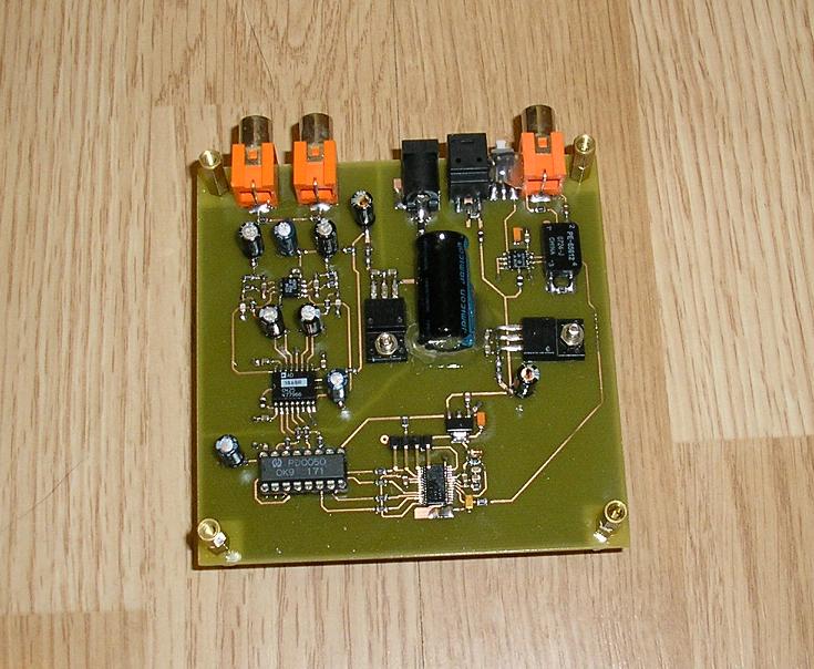

I made simple and compact DAC with PD0050 a while ago. It uses DIR9001 as a receiver, PD0050 DF and AD1868 DAC chip. Planned to use it with STB receiver. The basic idea was to use 3.5" hdd box as enclosure and power dac from single cheap 9-12v wall plug power adapter.
DAC works wery well. Own DAC noise is very low due to separation ground planes on the bottom side of the pcb and use separate power regulators for analog and digital parts.
PD0050 doesn't seem to be very good filter, CXD1244 sounds smouthly and precisely (imho). But using it with R-2R DAC chip it sounds better than most sigma-delta DACs.
