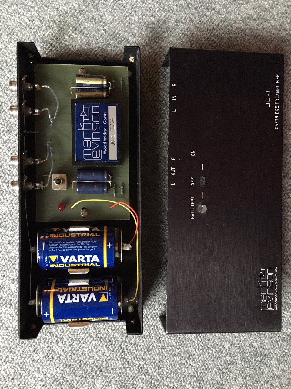

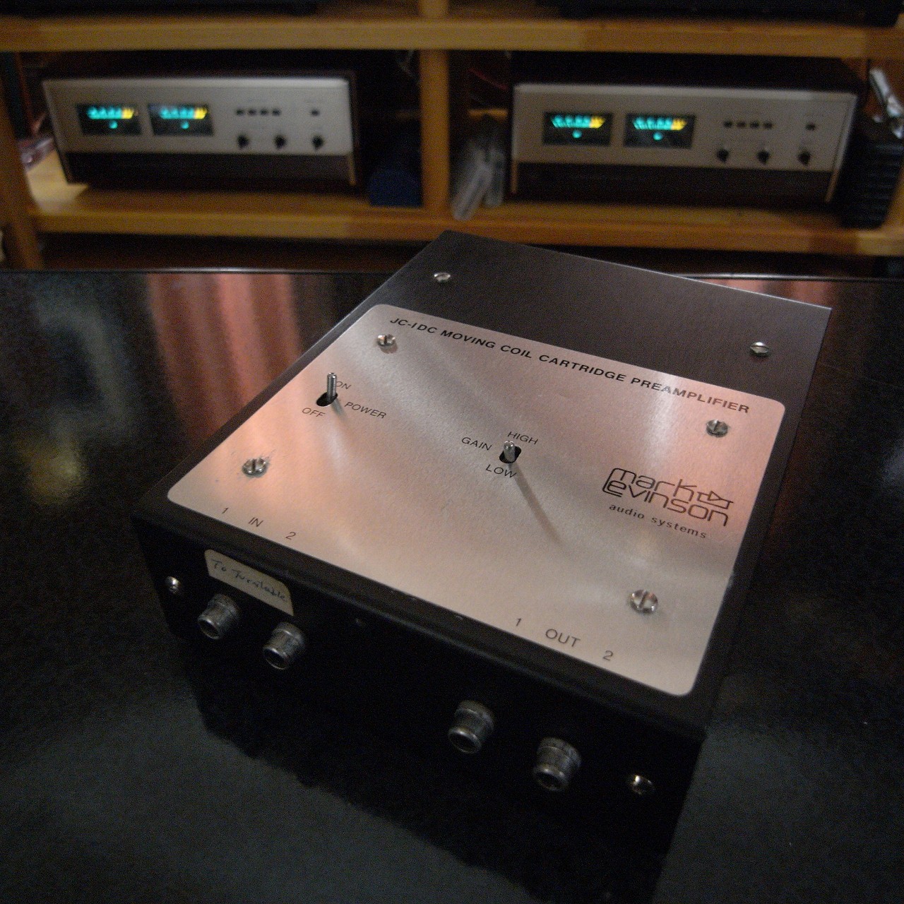

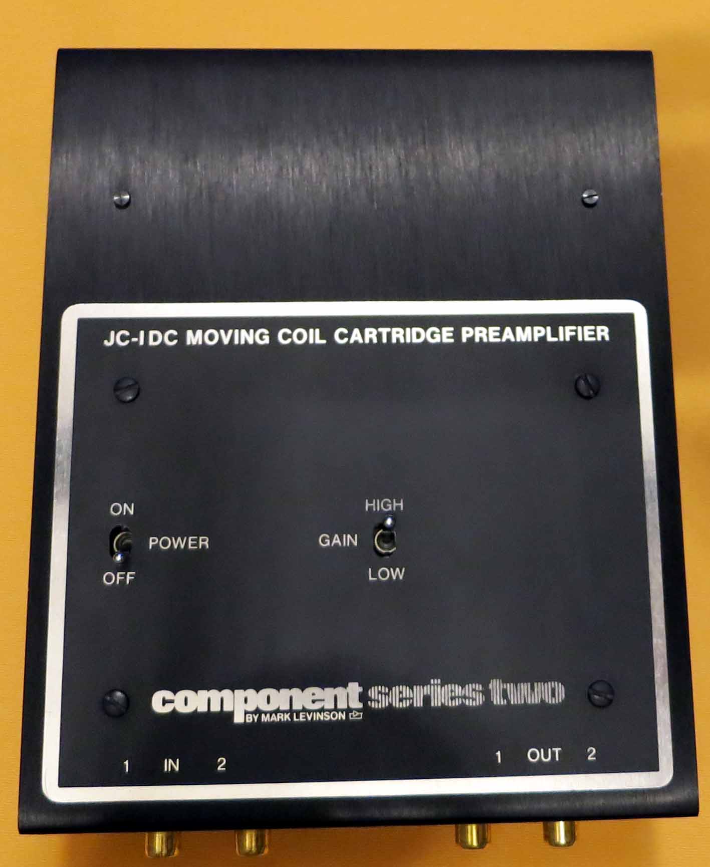

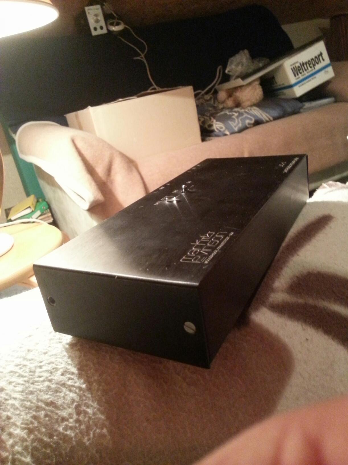

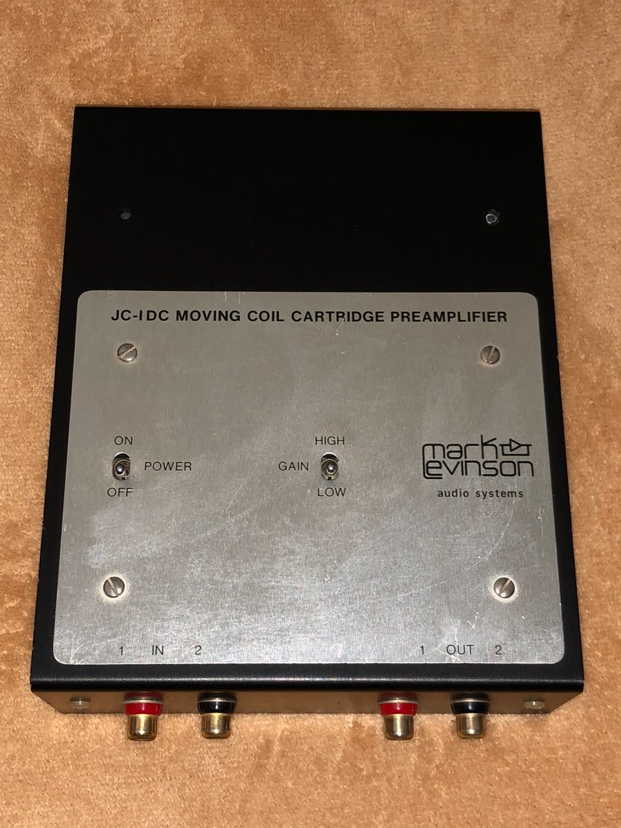

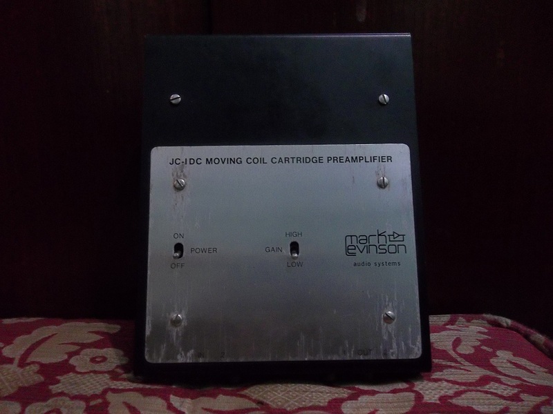

Both versions are for operating without mains power supply - just two secondary D-cells are in use.
What is the difference ?
BTW - the mains supply version uses the additional term "AC"
The difference is the year of release - the suffix "DC" means a newer series (release 1976) than the older series without that suffix (release already 1974) go to

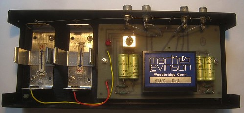

I know the module of the JC-1DC, but I don't know the module of the JC1. This means, that I also don't know the difference between both module models.
The JC-1DC module are also in use here:
Mc Kinnie RO III front | Flickr - Photo Sharing!
http://www.diyaudio.com/forums/solid-state/78843-john-curl-mc-kinnie-phono-pre-preamplifier.html (post #3)
The sizes of this module are bigger than the sizes of the JC1 module (have a look to the first image of my first post).

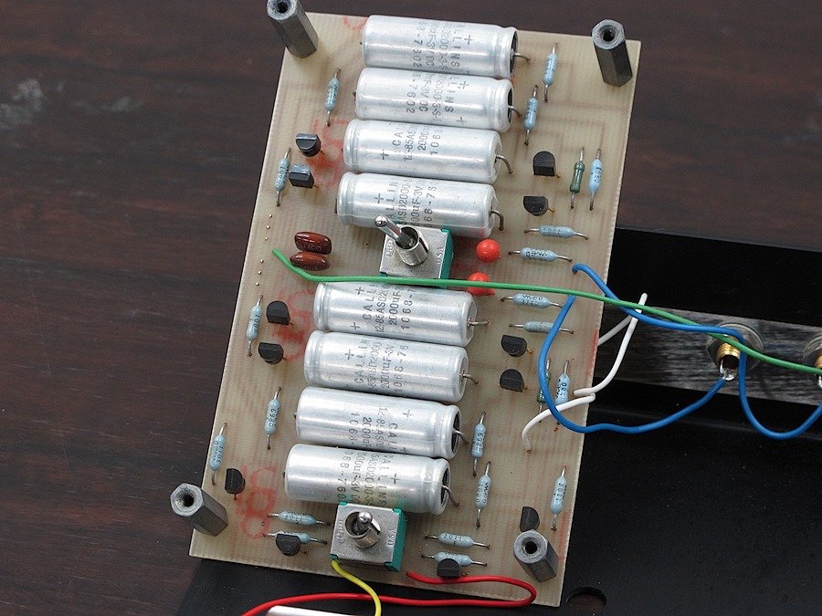

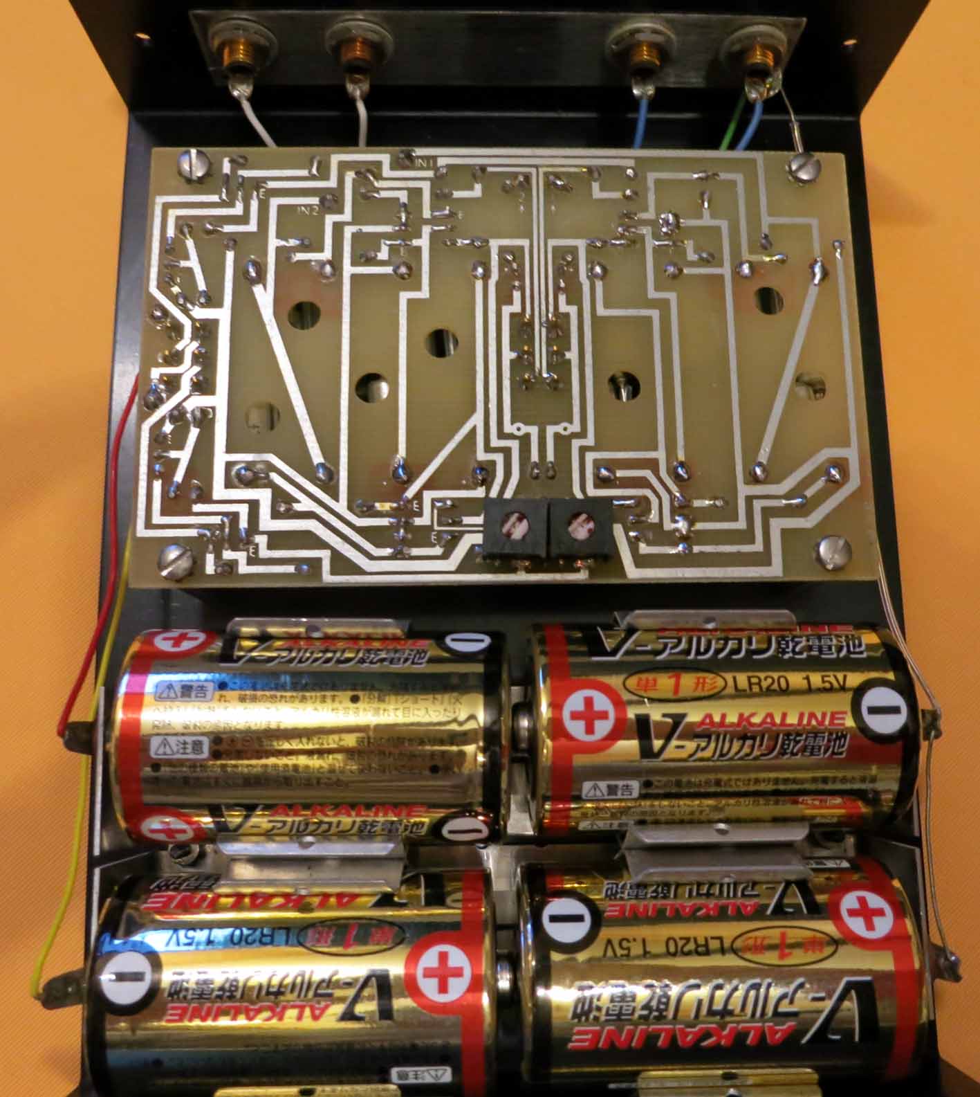

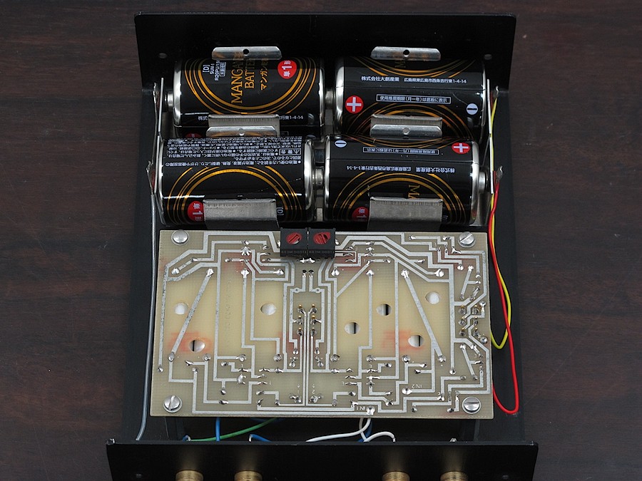

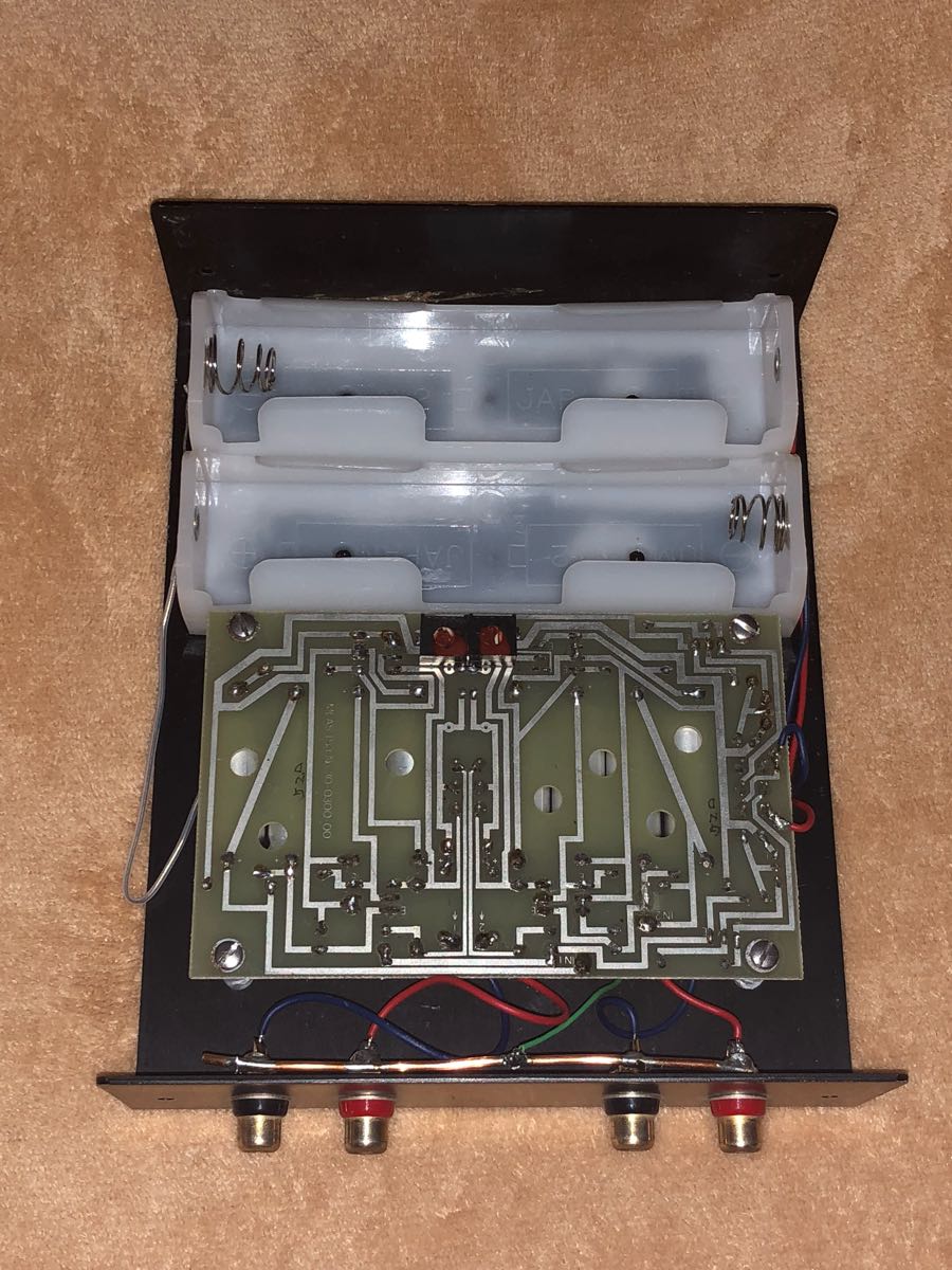

by this version of the JC-1DC there is no module inside (maybe since series II):
JC-1DC Mark Levinson ¥Þ¡¼¥¯¥ì¥Ó¥ó¥½¥ó ¹â²ÁÇã¼è¡¦ÈÎÇä ¥Ï¥¤¥Õ¥¡¥¤Æ² Ãæ¸Å¥ª¡¼¥Ç¥£¥ª/ Ãæ¸Å¥ì¥³¡¼¥É/Ãæ¸ÅCD/McIntosh/JBL/audio-technica/Jeff Rowland/Accuphase/¿¿¶õ´É¥¢¥ó¥×/¥È¥é¥ó¥¹Â¾¥ª¡¼¥Ç¥£¥ª¤Ê¤ó¤Ç¤âÇ㤤¤Þ¤¹ ²¼¼è¡¦ÄÌÈΡ¦°ÑÂ÷ÈÎÇä¤â¤ä¤ê¤Þ¤¹ 13-74607-88374-0
all components are easily accessible for replace.

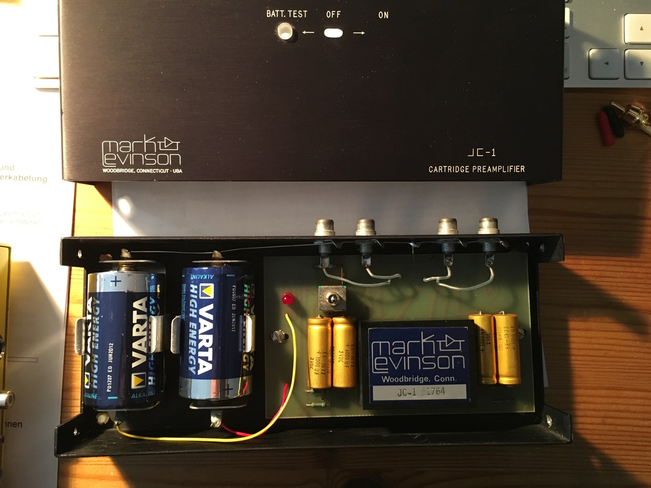

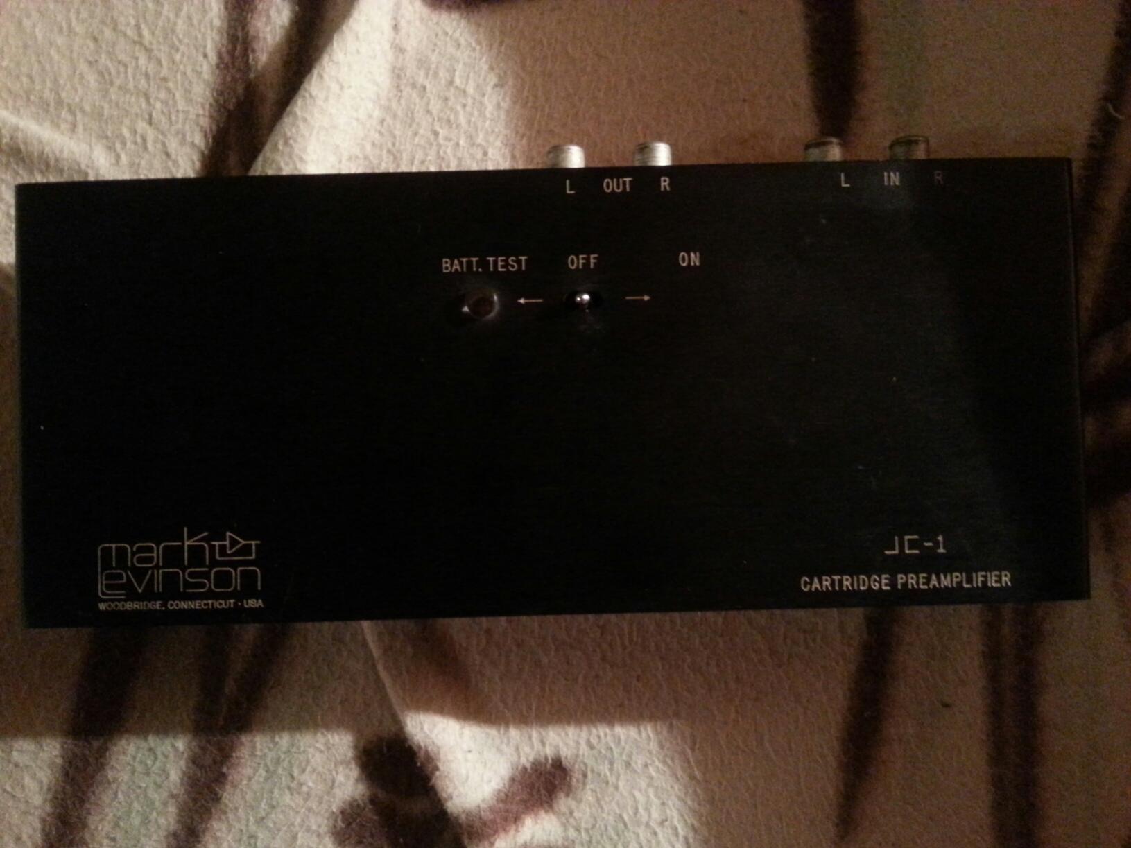

For check I have in the moment the JC1 as to see in the first picture (post #1) but with serial number 1188.
I want to replace the electrolytics. 4 pieces are outside. How many electrolytics are inside of the module?
And in which direction is allocated the potted PCB? Is the solder site on top or at bottom?

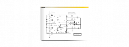

The schematic of the JC1-DC module, which I have opened at those days, is attached as PDF-file here.
Unfortunately the JC1 module isn't the same.

Faulty schematic
I dunno who designed the AC adapater schematic but I think it's wrong. You need a center-tapped transformer as the ground is not connected now.
Or alternatively use a virtual ground creator like TLE2426 as Jim Hagerman did here:
http://www.hagtech.com/pdf/piccolo2.pdf
In general you are right, but in case of the JC1DC the showed circuit works very fine without transformer with center tap.

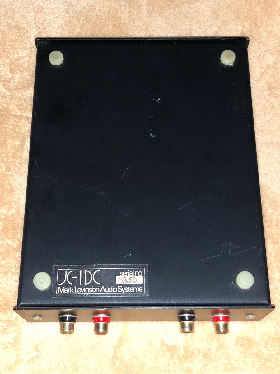

The schematic of the JC-1DC (potted version), which I have create some years ago, you will find here:
Mark Levinson JC-1DC_ckt[1].
Maybe there is also a schematic of the JC-1 anywhere. The last both pictures are from a device in not worked condition at left channel - unfortunately also in a potted version. The replace of electrolytic capacitors by new ones don't provide the wanted success.

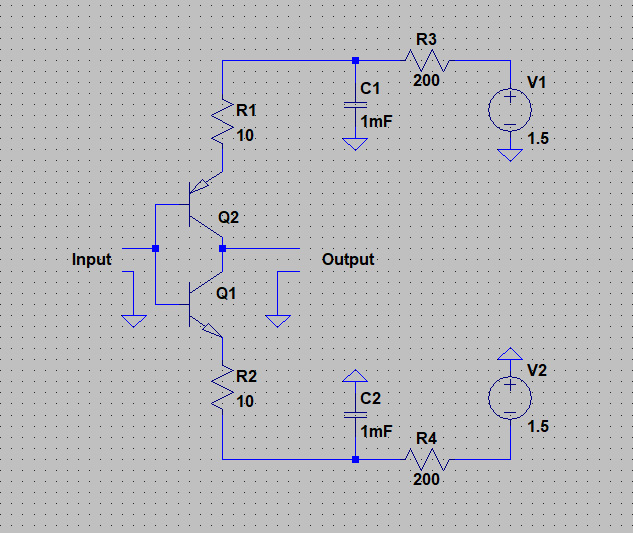

yes, but both versions are battery powered working versions.Guys,
As I remember, the DC simply stood for battery power.
Charles

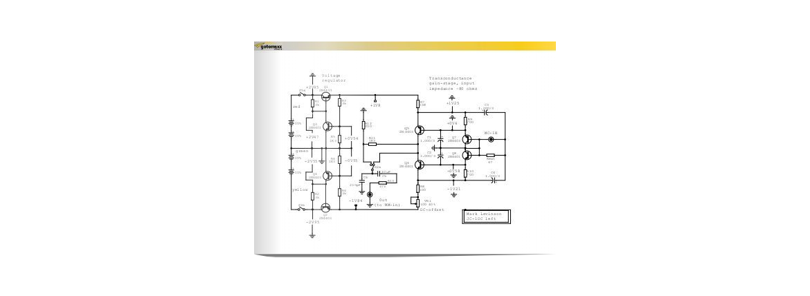

If you are right, the different between "JC-1" and JC-1DC" is large. The input signal is fed in at the base, like iFi iphono2 - go toThe circuit below is also a JC design.
Maybe this was the version used in the JC-1.
This one shows 2 transistors plus two emitter resistors, but to lower the noise, JC used 8 transistors with eight emitter resistors in parallel.
Hans
iFi Audio Model "micro iPhono2": Creating Schematic - help needed
and not at the emitter like the JC1-DC (go to the attached image).

maybe the simplified schematic from the attached patent - which is more easy than those from JC-1DC - is in use in the JC-1 potted MC head amp module.

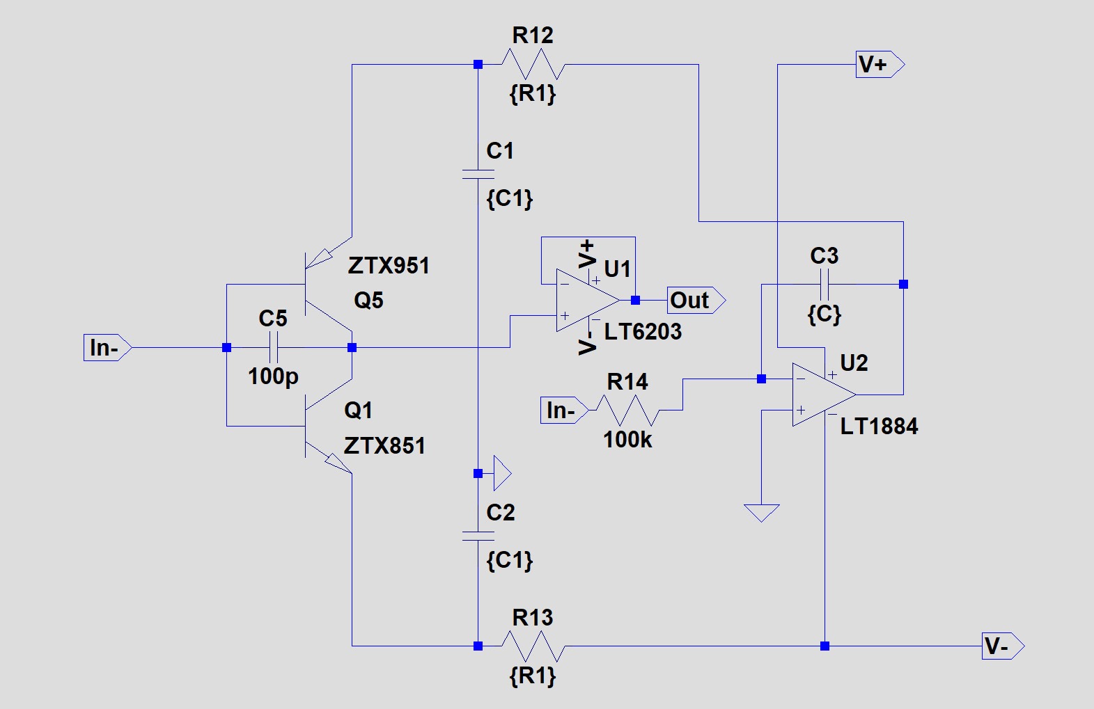

A bit off the record, but starting with the JC-1, I replaced the four 2*4 by two transistors having a much lower noise figure, the ZTX851 and the ZTX951.
But because the collectors are loaded by feedback component #18 in the patent scheme, this has serious impact on the open loop gain, the maximum output and the distortion.
That's why I buffered the collectors with a high speed LT6203 low noise op-amp, not deteriorating the noise at all.
And just because you don't want to have DC current flowing into the Cartridge, I also added a LT1884 Servo that is producing the positive supply.
But the basic idea is still completely there.
Noise contribution is below 0.3nV/rtHz.
You can easily increase maximum output voltage and decrease distortion even further by giving U1 a gain of 10.
