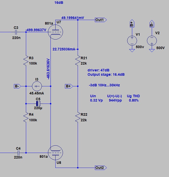

If the amp output is 1300 Vpp = 460 Vrms, and the input is 4 Vrms (for example a balanced output from a modern DAC), the total voltage gain of the amp would need to be approx 100x. Of course this will not all happen in the DHT output stage. The input/driver will have to take care of that.
You still need a tube that is capable of swinging 650v peak to peak. That's harder than you realize. Even a 300b can't quite do it (although it is close).

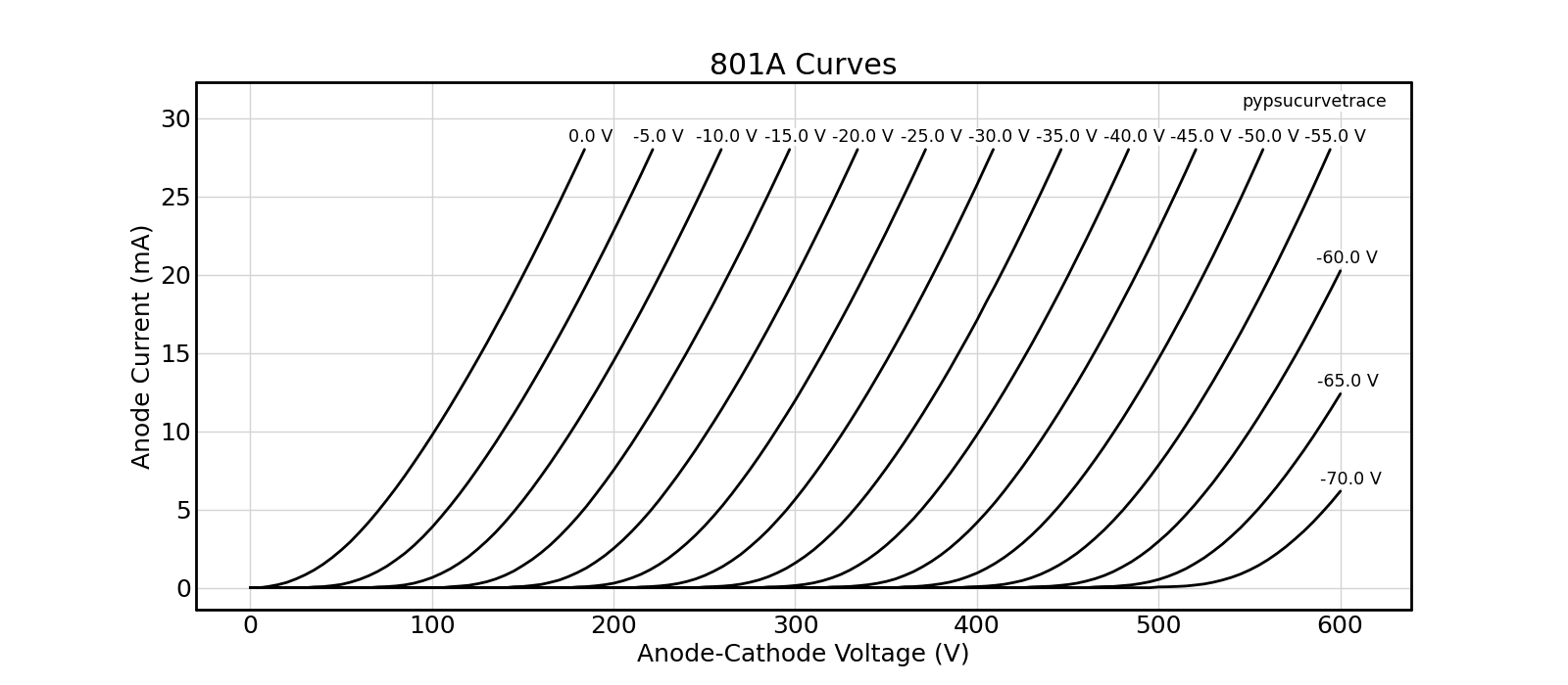

Just as an example: what's wrong with biasing an 801 tube at Ua=500 V / Ia=20 mA / Vg=-47 V (see attached curves, which I measured from a real tube)? As I see it, that would allow a swing of +/-350 Vpk, or 700 Vpp before it hits positive grid voltage.
I see your point, but I tend to look at this from a different angle:The disadvantage of 801/801A series is the same as EML 20/30 series. There's only one manufacture producing it, and could be obsolete any time in the future. With only NOS tubes in the market, the life of the project will be ended soon.
- The 801 is available from new production, and there are quite a few 801 / 10 / VT-25 from old production out there (either used or NOS and at much lower prices than the new production tubes).
- The 20B is available from new production only (at similar prices as new-production 801). They are not available second hand.
- The 20B is a new design, which is specific for Emissionlabs. What would happen if Emissionlabs stops existing? Will another company pick this up and make 20B tubes? Will the EML 20B tubes be available second hand?
Good point. Nothing wrong with A2 in principle. With A2, the 801 could be biased at around 350 V / 20 mA and still swing +/-325 Vpk. The lower bias voltage with the A2 option would also open the door to using the 10Y / VT-25, which don't like biasing at 500 V. As you wrote, the drawback might be that A2 needs an extra buffer to drive the grid positive.

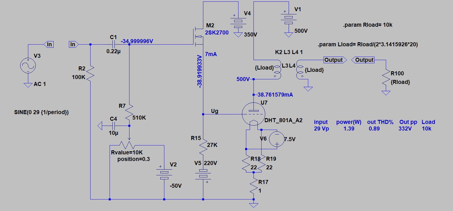

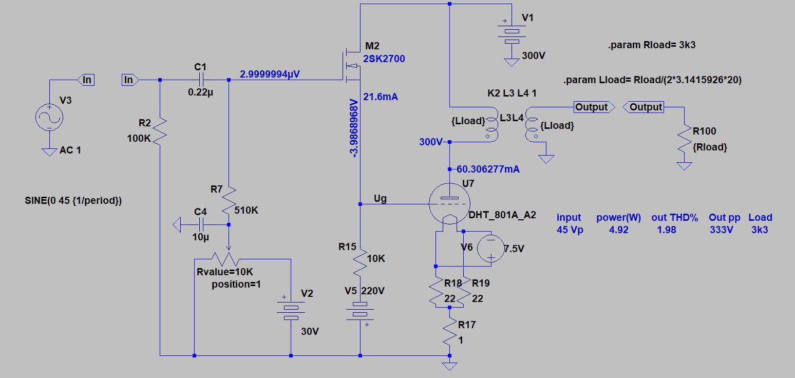

These operating points not optimal for 801a.What would be better, easier, preferable, etc.?
- A1 with no need for a buffer, biased at 500 V / 20 mA
- A2 with the extra buffer but at lower bias voltage (350 V / 20 mA)?
If you want acceptable distortion (at high anode swing), must to push this tube to near (80-90%) maximum dissipation.
I use its at about 18W dissipation.
Samples:
The A1 version requires 10k anode load, and lower grid swing.
The A2 at 3k3 load produces higher distortion, but requires lower B+ ... with higher current.
In this case (where output power is negligible) I prefer the first version.

Your SPICE simulation are interesting, but they seem to assume a resistive anode load and a resistive speaker load through a transformer. The estat amp will use CCS anode loads and the estat load is mostly a capacitor. See here (link also in first post): https://www.diyaudio.com/community/threads/open-source-dht-estat-headphone-amp-osdeha.407679/These operating points not optimal for 801a.
