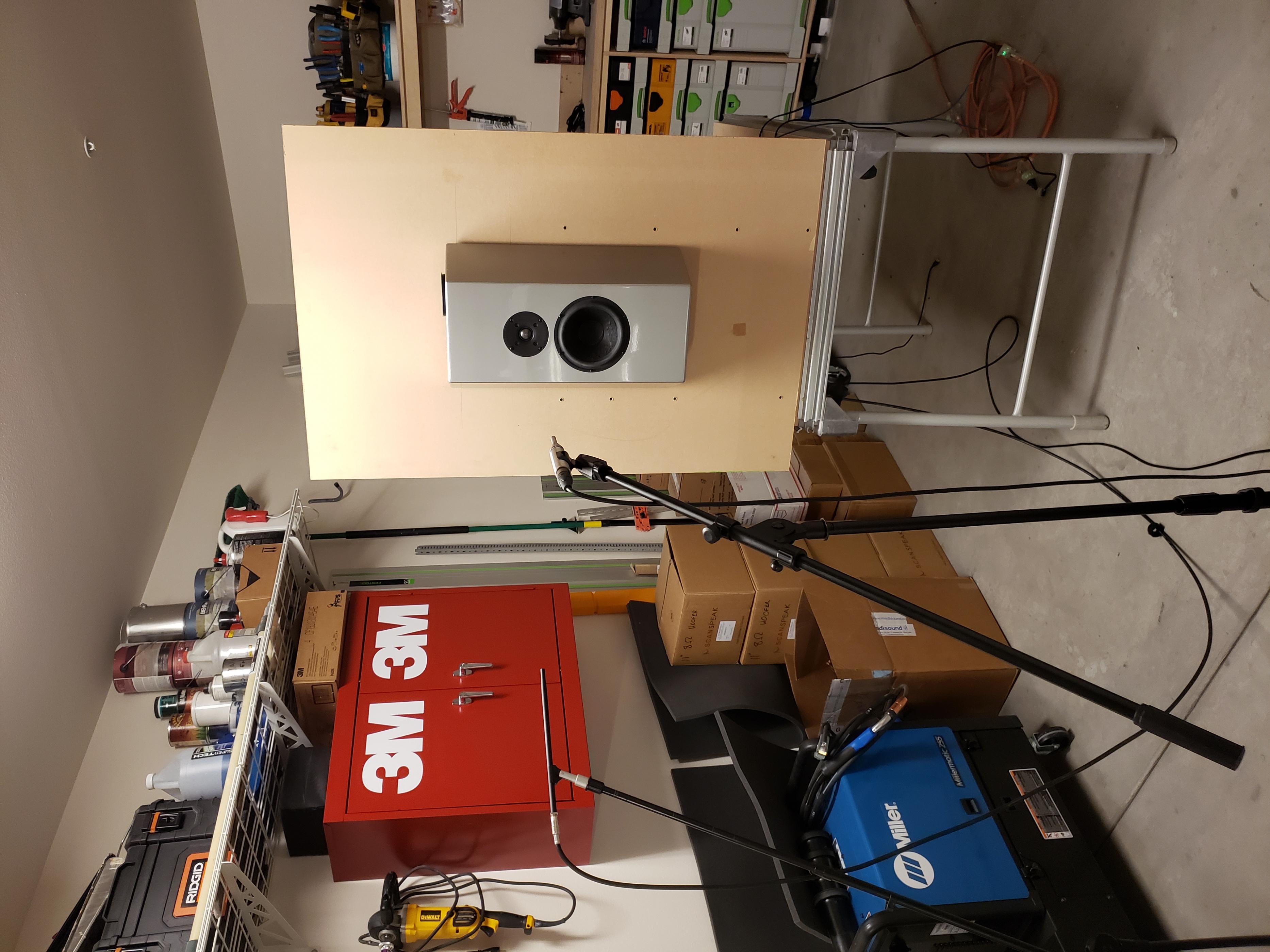

No. With the exception that you have dedicated a wall to being a part of your speaker. You could test it on a large baffle instead. You don't want to include your room effects in the measurement.Having said all that, I can see now that the proper way to design the crossover is really build the speaker and measure its response in the room it will be installed.
Ah, yes. AllenB, you have once again pointed me in the right direction. I think measuring speaker output for crossover design is ideally done in a anechoic chamber? I will need to figure out a reasonable substitute to do the measurements at home then.
Take a look at this. In this thread, mp006ltk is also doing an on wall design. His measurements include a fake wall, because the wall has become a part of the design.
Perfect. This is pretty much my same scenario. And relatively easy to setup. Maybe put the whole thing in a tent of moving blankets? It will be some weeks still before I get to the point of actually taking measurements (recently moved, still need to setup shop to build enclosures, etc.) This is definitely the plan though.
