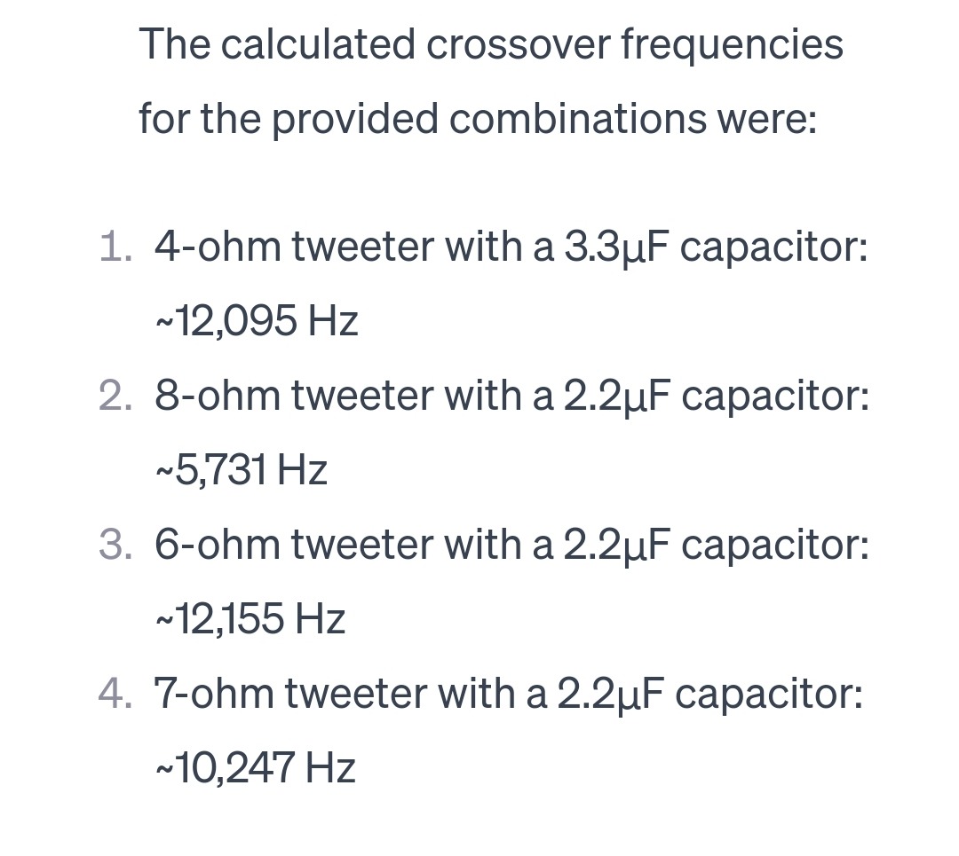

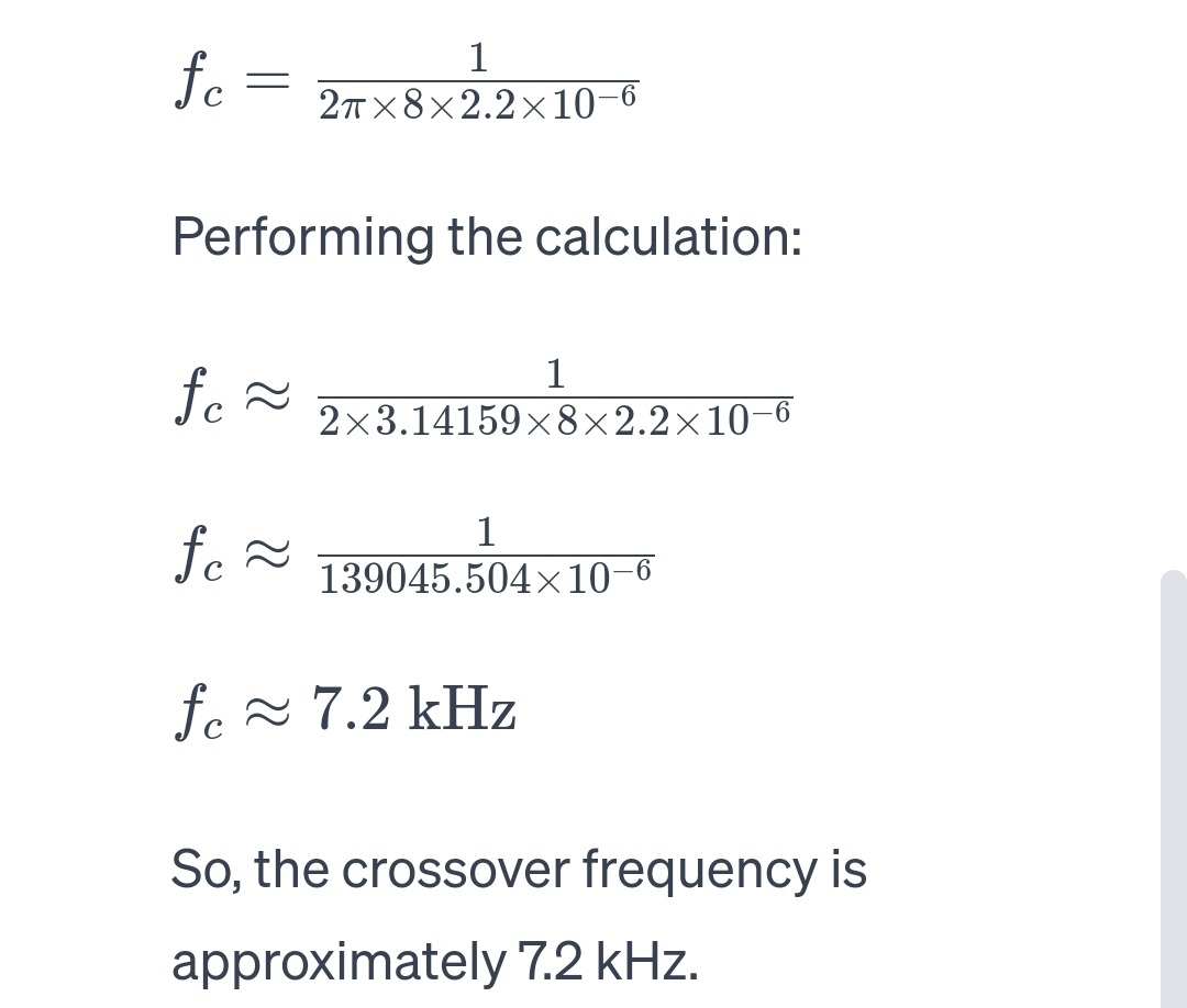

Math in msg #4 is off. Simply, 8ohm driver high-pass frequency (-3dB point) is 20khz/uF which differs from the 1/2pi official formula by half a percent, much lower than typical part tolerance of several percent. 20khz/2.2uF ~ 9khz.
HPF ~ (160khz/ohm)/uF
LPF ~ (160hz*ohm)/mH

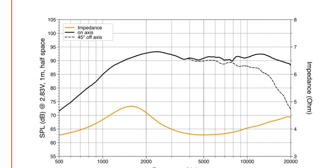

ComponentTweeter
Size mm (in.)26 (1)
Power Handling - Peak W120
Power Handling - Peak Note(Hi-Pass filtered @ 2,5kHz - 12 dB Oct.)
Impedance Ohm4
Voice Coil Ø20(0.8)
Frequency Response Hz1.8k ÷ 22.5k
Magnet size D x d x h mm (in.)19 x 0 x 3 (0.75 x 0 x 0.12)
Weight of one speaker kg (lb.)0,04 (0.08)
MagnetNeodymium
DomeTetolon
D mm26
Re Ohm3,7
Fs Hz1500
Le mH0,02
Vas I-
Mms g0,17
Cms mm/N0,07
BL T*m1,3
Qts1,6
Qes3,5
Qms2,9
Spl dB92

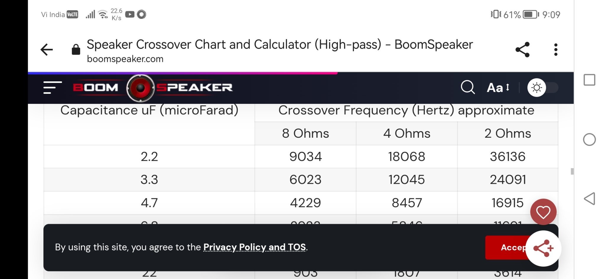

Which combination would you like to me to go with?
If that question is directed at me, I have already given my preference in post #13: 4.7 uF with 4 ohms or 2.2 uF with 8 ohms.

It depends on the sensitivity of the 8" driver, and at what frequency it falls off. The high-passed (92dB?) tweeter needs to fall enough but not too much. If the 8" is close to 90dB then 8ohm tweeter might be better; otherwise 4ohm tweeter will be filtered more, to match the 8" better. In either case, buy a bunch of different small caps to test -- they are cheap! Also a bunch of small resistors (for the tweeter) if the 8" falls off too quickly AND is much less sensitive than the tweeter. Given how little we know of the 8" not much can be said with any confidence.

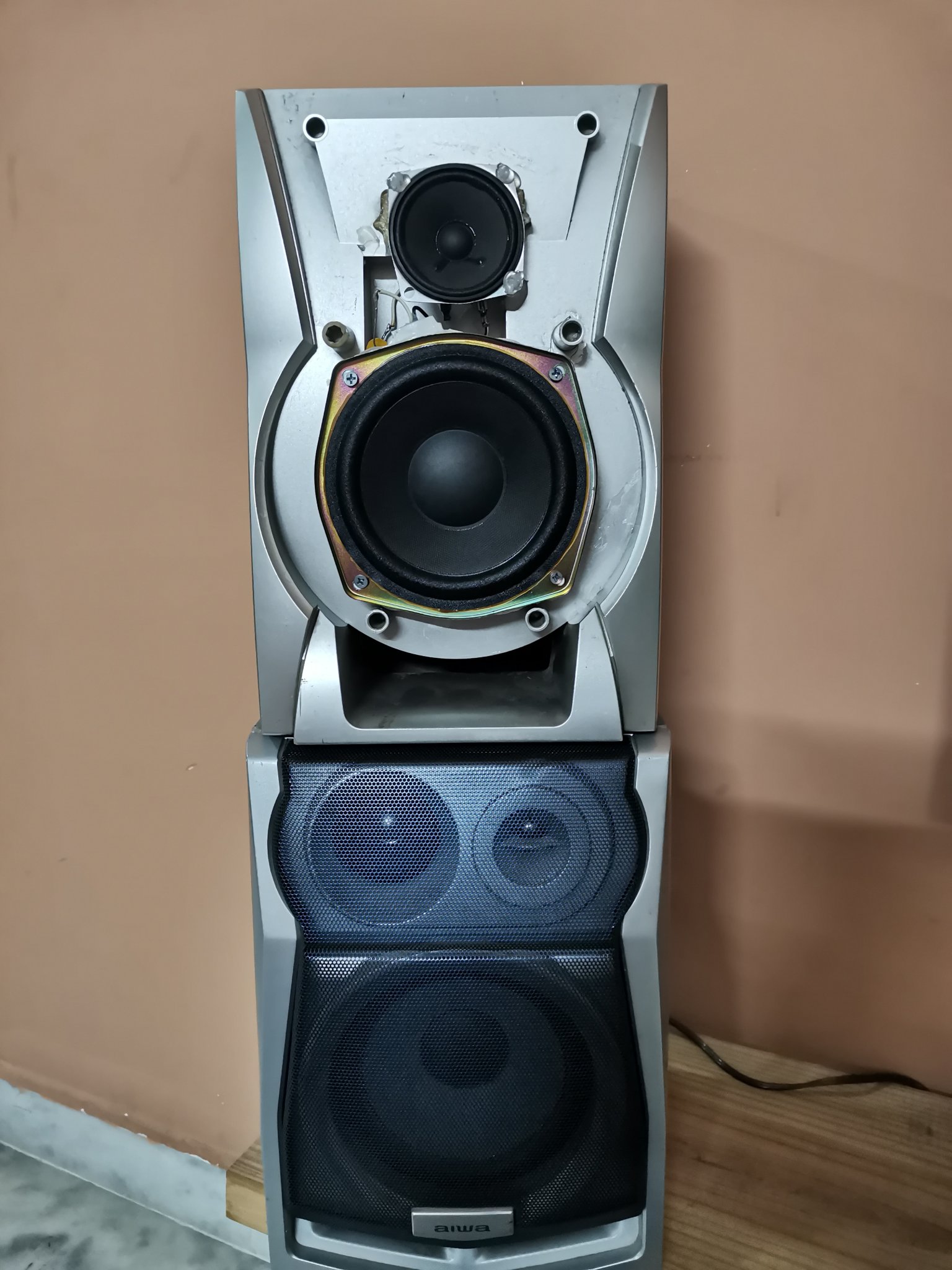

Absolutely! We have no specifications for the replacement Aiwa woofers that Kamranbits randomly fitted in his Kenwood enclosures.
The blown 4 ohm tweeters in the Kenwoods were filtered by a 3.3 uF capacitor and he could continue to use such a combination should he so wish - in fact, he can't seem to let it go!
