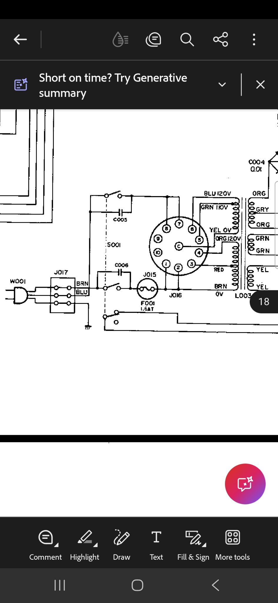

Which class of capacitor on this switch
I've had to take my Marantz 2226b front panel apart to clean some switches and as its difficult to get the board out, I'm refreshing what I can.
There's a paper in oil cap? 0.022uf accross the switch contacts going live to live and a 0.022uf poly caps going neutral to neutral.
Which class of capacitor would be the one to use.

These are not a "critical safety part". What they do is suppress the transient over the switch. If they fail (short) the switch is closed unintentionally, that is all. Sometimes there is too much recapping because why not, pavlov reactions and urban legends.

They are a critical safety part. They are constantly subject to the mains voltage when the unit is off, but plugged in. They are renowned for randomly exploding, particularly PIO and Rifa style potted epoxy types. They crack, oxidize, become a highish resistance, heat up, catch fire or explode- all while the owner has no idea, unless they are lucky enough to hear the bang or see/smell the smoke.
Suppression cap failures are responsible in my opinion for a huge amount of perfectly otherwise fine gear going into landfill. Plenty of kitchen appliances, hifi, power tools, etc.
Any switch suppression caps on vintage HiFi gear should be replaced as a matter of course particularly ones like the 22xx, 50yo Marantz receivers..
I always use a safety cap with a voltage rating of at least twice your mains voltage
As tempting as that is the caps must be X1 or X2 rated. 1000vdc/630 vac rated caps might for example seem a safe bet but they absolutely are not.
An X1 or X2 cap will have an AC rating of typically 275vac which might seem to offer no safety margin but they do. They are designed to 'self heal' in the event of a breakdown in the dielectric due for example to a transient spike. Do not use anything else.

Besides, in this particular example of Marantz the two capacitors are in series and each have half the mains voltage across.
A dielectric breakdown in a cap which is wired across the switch terminals cannot result in any more fault current than the unit normally draws when turned ON. The cap itself might be destroyed, but won’t result in uncontrolled current flow. Higher voltage rating is always better, and the value SHOULD be set such that the LCR circuit never results in crazy voltages. It will be less than what is developed across the switch when opened without the cap, for sure.
