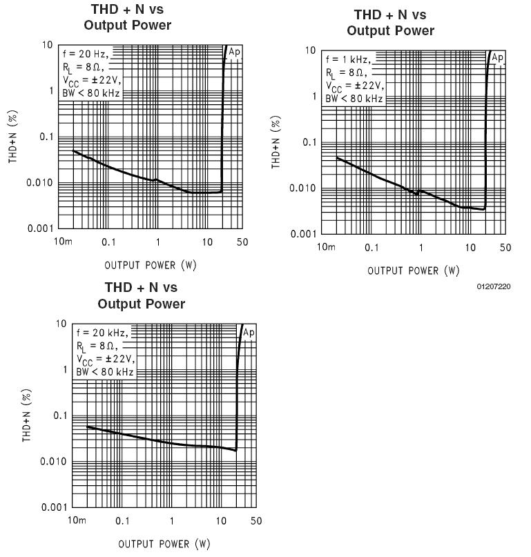

The second is a National LM1876:
20Wx2 (f=1kHz, 8ohms, THD 0.1%+N)
0.08% THD (P=15W, 8ohms, f=20Hz-20kHz) see graph attached
LM1876 datasheet

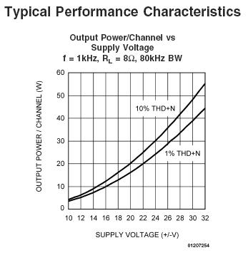

On another note, i noticed the LM1876 claims to output 40W per channel (1%thd, 8 ohms) when V+/- is above ~30V. See the graph below. Is this feasible for a chip originally rated at 20Wx2?
those excessive distortion graphs (1% & 10%) show that these devices can amplify to those powers without destroying themselves. But that is not an indication of quality.
Expect a maximum of ~35W into 8ohms @ 0.1% distortion at the supply voltage maxima shown.
If you want that power, then choose a PSU that can supply the required on load voltages.
But ensure the PSU voltage offload is below the absolute maximum for the chipamp.

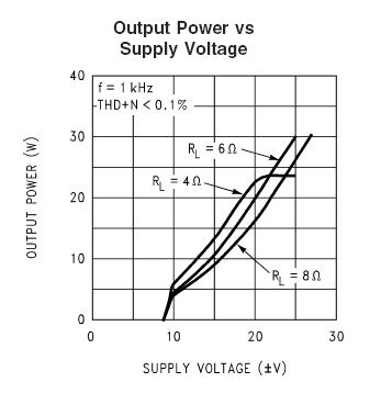

hi andrew,
i had a closer look at the datasheet and it actually gives a power out vs supply voltage graph for 0.1% THD (f=1kHz). For an 8 ohm load it goes up to 30W at around +/-27Volts. But the graph stops after this point. Could this be an indication of an upper limit for supply voltage? Btw, the absolute maximum voltage is at 64V (ie: +/-32V)
you have to work back from that specified maximum operating voltage.
I would start with mains at maximum tolerance find the maximum AC voltage for the +-32Vdc and using the regulation of my chosen transformer and normal mains voltage find the normal AC & DC voltages into and out of the PSU.
That let's me specify the AC voltages of the transformer. I would expect 240:20.5Vac 5% regulation for my 240Vac supply.
Most transformers are specified for 115/230Vac. That brings down the AC to just 19.8Vac when used on a 240Vac supply.
I would choose a 230:18+18Vac transformer with lowish regulation (5 to 8%). This will give me an absolute maximum of +-30Vdc when mains is at 254Vac and regulation is 8%.
If I wanted to squeeze a bit more from the amplifier, I might think about (but reject the idea) adding a few turns to make this a 19+19Vac transformer.
Now that I have my safe Vac I can use the chosen transformer at my normal voltage (~239 to 245Vac). Subtract about 4Volts for voltage sag on short term full power testing. Looking at the graph I see ~28W for +-26Vdc.
Summarising, a 230:18+18Vac 8% regulation transformer powering an 1876 from 240Vac gives ~28W into 8ohms.

Thanks, that cleared things up a lot.
