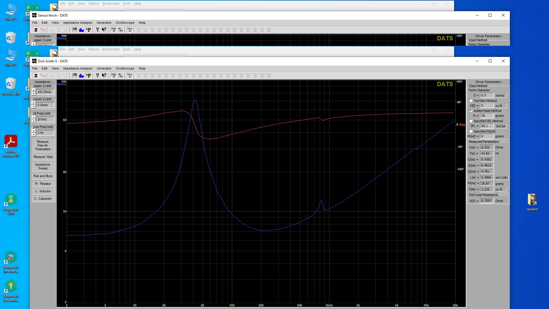

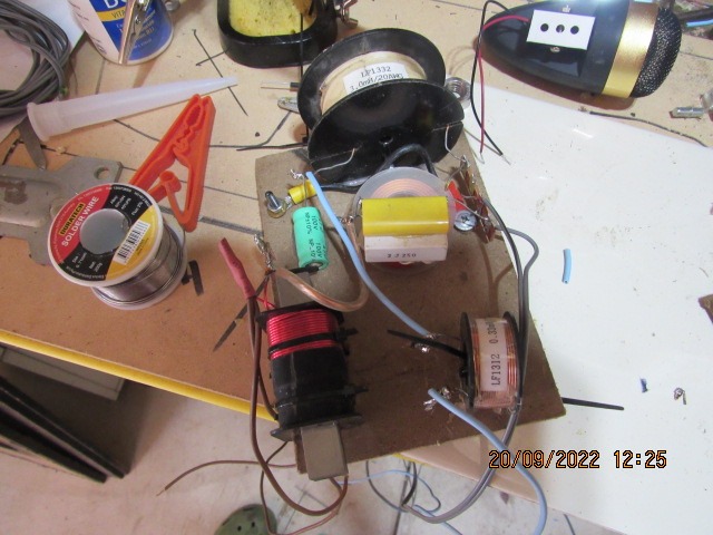

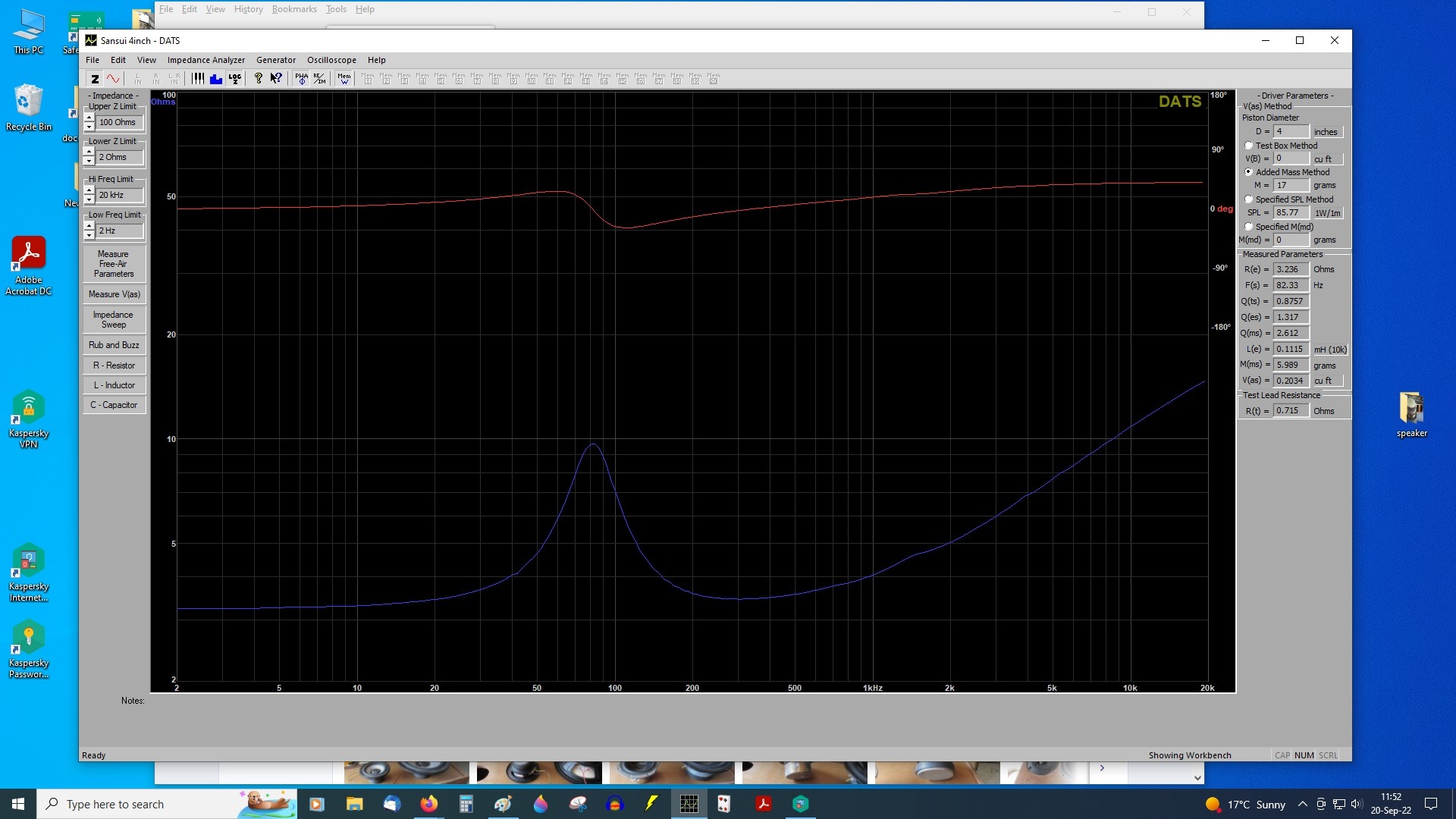

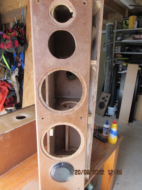

Having decided on the use of the spare Sansui driver and using one of my spare sets of woofers based solely on the fact that they fit the existing routered rebates perfectly I worked out a crossover based on the woofer tester results and experience using only what components I had in the stash.
Pete you may remember these woofers and the tweeter from the Dick Smith closing down sales a decade or so ago.

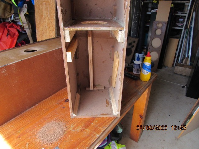

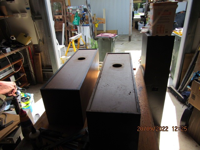

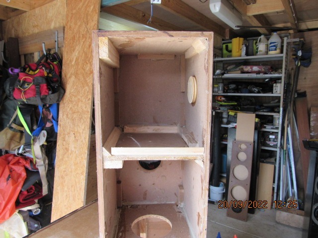

It's lucky that I really enjoy tinkering as these boxes were really of s*** quality and I only used them as the front baffles were ready to go
Based on the results of the woofer test the box is too large and it will be larger again when stuffed so a subwoofer will be done soon so my mate has decent bass.
Approximate XO points are 400 and 3500 and using my usual asymmetric style but no Zobel network on the woofers.

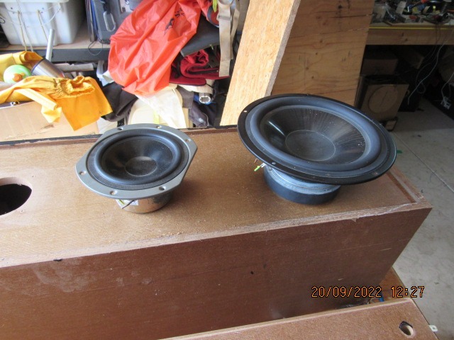

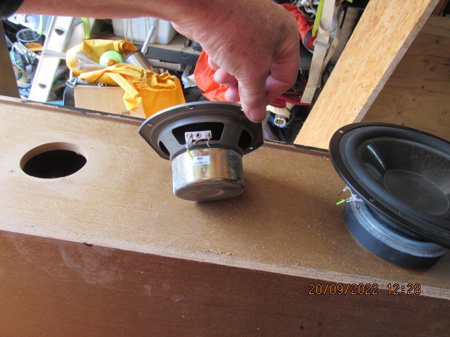

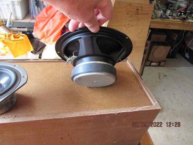

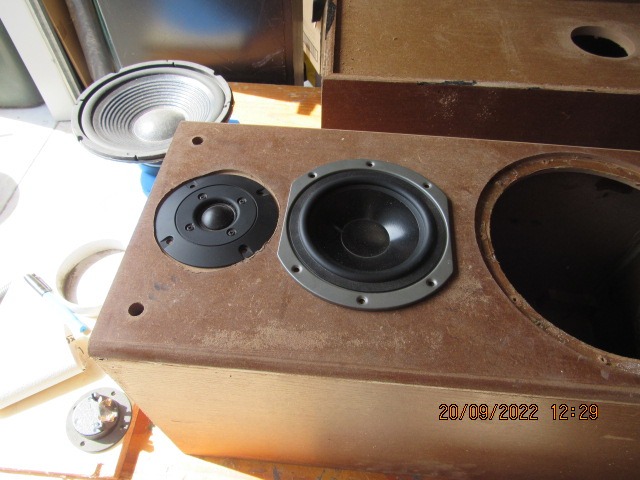

Pix of the drivers and screenshots of the test results.
As you can see the new drivers have much bigger magnets.

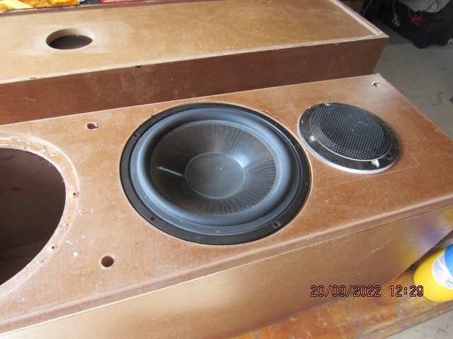

I had to do a new tweeter hole and my hand held router work isn't the best but it has to do

Testing drivers with WT3
I used the calculated values as near as I could get with using multiple caps wired together but the flattest impedance graph I got was with 22uF and a 10Ohm resistor, those values also reduced the secondary resonance at 500Hz too.

Almost finished but I am waiting on grill clips from AliExpress. Sound pretty good for garage speakers and resuscitated road kill, but the bass isn't as solid as I'd like.
