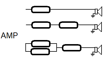

I only tuned the amplifier to the tweeters by themselves, the subwoofers and midrange speakers aren’t even hooked up, this is a bench test of just the fullrange amplifier running the tweeters, four of them. When you say double do you mean add another capacitor in line with the one already attached to the tweeter?I don't want to use inductors, it makes the process too expensive, so first see which way this is going and we can tell you how to proceed from there.
I am going to guess that you need two 2.2uF in parallel and one 2.2uF in series with them.
Doubling is placing one on top of another and halving them is placing one behind the other, make sense. It is not straight arithmetic.When you say double do you mean add another capacitor in line with the one already attached to the tweeter?

Is it possible for you to draw that out please so I can see how to hook it up exactly please. I only have the 8 2.2 uF capacitors available at the moment if I need a different value please let me know so I can order some. We only want symbol sounds of such to come out the tweeter no vocals, thank you. 🙏🏼I am going to guess that you need two 2.2uF in parallel and one 2.2uF in series with them.
You are doing what I was trying 50 years ago, and what you are doing now is learning. Don't worry we will get to your expectation.
Does it make sense. You may end up placing three in series (one after the other)

Yes perfect sense, so it will be trial and error trying the different combinations is what I should start tryingView attachment 1352154
Does it make sense
The tweeter specs say they are 4 to 8 ohm.
Taking the middle value of 6 ohm, we can calculate the frequency at which the tweeter response begins to slowly roll off.
For the 2.2 uF currently fitted that will be 12,000 Hz, but there will still be audible output at 6,000 Hz.
For 1.1 uF (two 2.2 uF connected end to end) it will be 24,000 Hz with noticeable output at 12,000 Hz.
Are you getting the results you need? When you find what sounds like what you expect, we will add the lot together and you can replace it with a single capacitor. Ater your trail and error and you want a sharper cut off we can add an inductor across your tweeter. Life is simpler than it seems.
